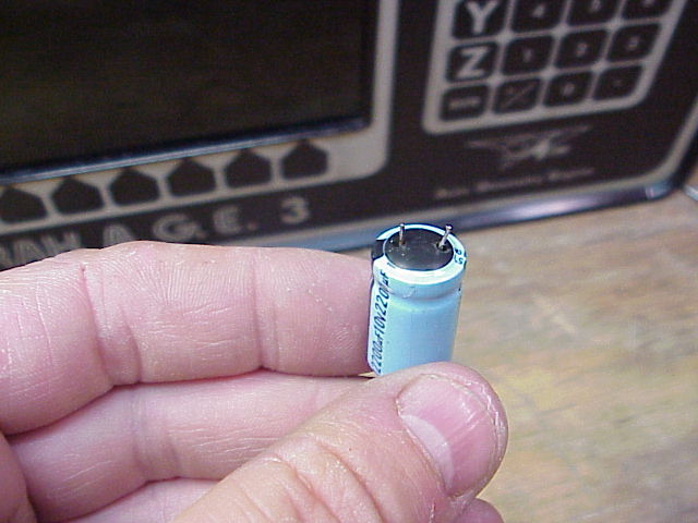

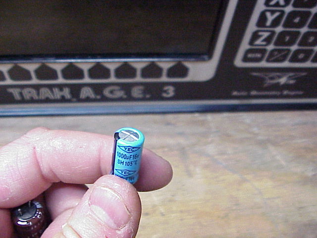

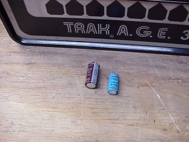

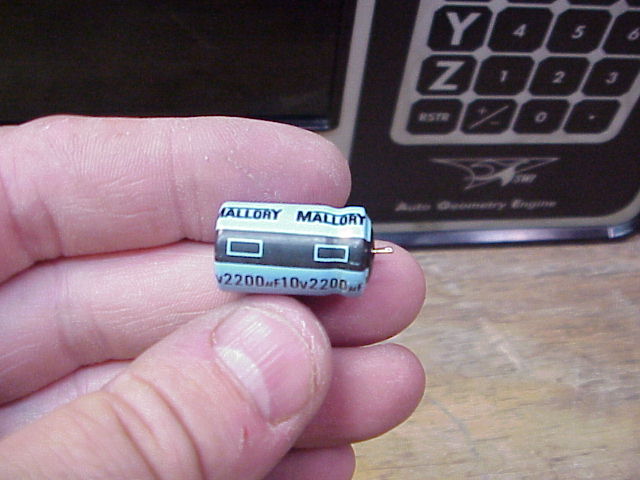

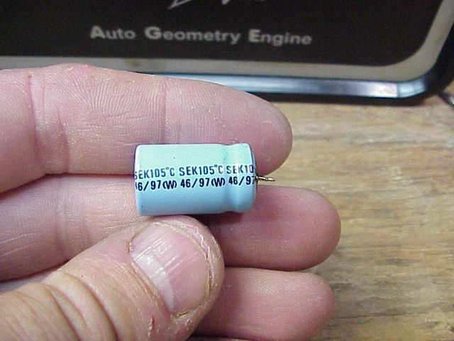

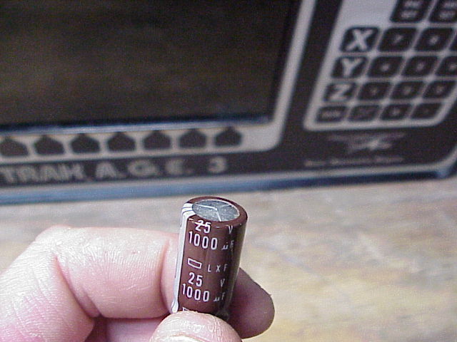

    multiple badcaps swi prototrak
    this unit was supposedly rebuilt in 99.
    lockups,no post,squished picture.
    i wonder why?
    mallory
  • kc8adu
    • Nov 2003
    • 8832
    • U.S.A!
    Re: multiple badcaps swi prototrak
    ucc and yec in +12 psu.
    this thing stunk when opened up.smelled bad enough to bring comments from the pc techs in the next room!
