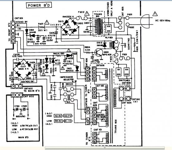

    Hey,
    I finally got the courage to open up my old Sherwood RV-6010R reciever. I know it has a few issues, but wanted a real challenge. The front speakers has gone completely silent. Checking signal continutity it seems fine until it reaches the main power transistors which doesn't seem to add any gain whatsoever.
    So I started by checking voltages. My main concern is that there is a significant amount of AC on the B+ line, which supplies the big power transistors with power. Is this normal?
    The DC voltages are as expected, but I also measure almost 70VAC on B+ when CNT602 is disconnected (about 104 when it's connected)
    Is this normal?
    capacitors C606 and C607 are missing, I guess to cut costs, should I put them in?
    I tried also removing C614 and C613, and lifted the "output" legs on the positive half of the bridge rectifier.
    On the negative half I get 35VAC in on each input and 0VAC out and -32VDC out, like I'd expect.
    on the positive diodes I get 35VAC both before and after the diode (when only one leg in circuit) along with +16V at the output. If I turn the diode around, I get 0VAC, and the expected -16V.
    but why does the diode let through AC in one direction and not the other direction? Is this normal? I thought diodes were meant to allow current in only one direction?

    here's the PSU schematic

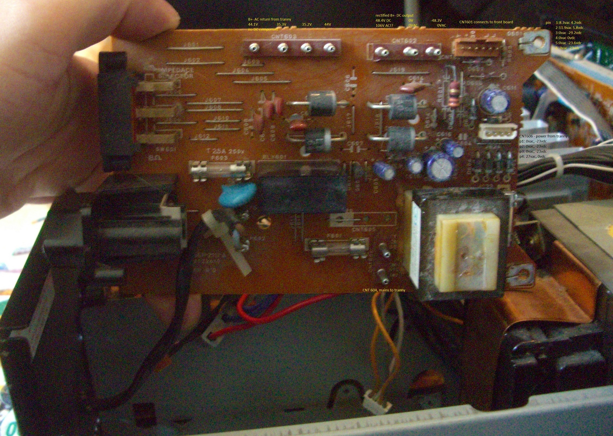

      I've done some more measurements, I started with the power in my flat:
      I have 150V between ground and either phase, and I have 239V phase to phase.
      I had expected 230V phase to phase, and 115V ground to phase (as according to Norwegian standard) but I guess I'm not too far off.
      The amplifier I'm trying to fix does not have a ground connection, but gets its ground point from a center tap in the transformer. I measured for any differences between chassis ground and the ground in my flat, and they're the same.
      I've attatched an image of the PSU board, with measurements on it. These measurements are with everything connected and switched on.
      Can please someone tell me whether it is normal to have a significant amount of AC on one output of a rectifier bridge?? Thanks

        You're not measuring 'AC' with CNT602 open- that's the pulsating DC straight from the rectifier. Accurate readings of B+/B- will only be obtained with the two big filter caps (C521/C522) in the circuit, as in CNT602 connected. Are you sure you're measuring across each cap seperately when you check the voltage? 100+ volts on 80V caps would make 'em explode... Sounds like you're measuring across the positive terminal on C521 to the negative on C522. Don't do this. Go + to - on C521, then + to - on C522.
        C606 and C607 are to quiet the diodes. They bypass RFI and/or switching noise. You should be OK leaving them out.
        Are you sure you have 'split-phase' power? Usually, you've got a single 240V winding in the dist TX, grounded at one end. Or a 416Y/240, grounded at the wye point, yielding 240V phase to ground and nearly zero phase to ground.
        Your 'ground' may be floating. Measure from both sides of the recep to a copper water pipe. Also from the 'ground' to water pipe.
        Check the power transistors for shorts and emitter resistors for opens.

          Re: Troubleshooting sherwood RV-6010R surround reciever (PSU?)
          When measuring the voltage I measured from the positive terminal on C521 to ground, and from the negative on C522 to ground.
          I just came across a tread describing how some cheap multimeters are unable to measure AC correctly if the waveform is not sine, and I suspect that this may be the case here. I'll check it on my scope, but won't get around to it until after the weekend I reckon...
            I got my scope out this morning, and measured the B+ and B- again, and it appears that they're fine!
            I get about 0.1V of ripple on them both, at about 100Hz, which makes sense.
            The huge AC voltages reported by my multimeter are not there!
            So my multimeter can not be used for measuring AC unless it's a pure sine wave. Lesson learnt.
