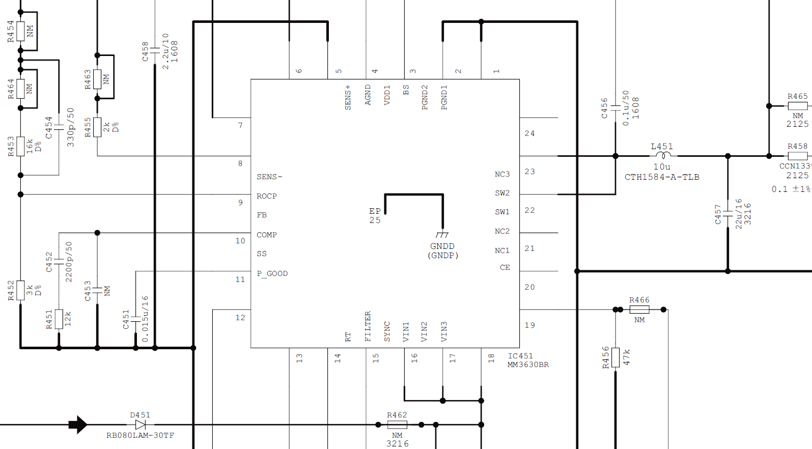

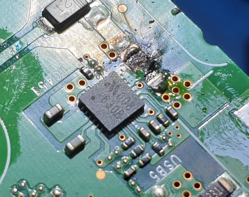

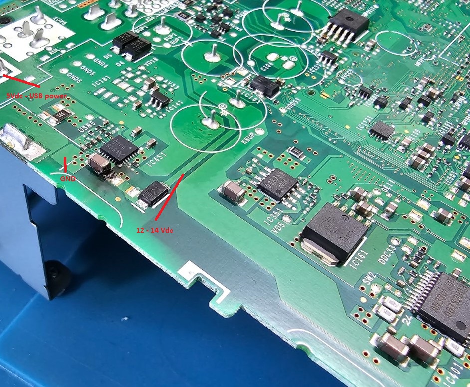

    Dear forum colleagues,
    Here I have a Pioneer - AVH-z5200dab of which the 5Vdc USB voltage is missing.
    IC451 is defective and a capacitor is defective (short circuit).
    Now I can't find a service manual for this specific unit anywhere, nor can I identify the step-down converter chip IC451.
    This is (I think) a Microchip(?) DC/DC converter in a QFN-24 package. I can't find the type on the Microchip site. It also does not work via Google and image search.
    Markings on the chip: "008 630B"
    Does anyone have an idea?
    Input of this chip is the battery voltage of the car (12 to 14 Vdc) and the output (via a Coil) is 5Vdc for the USB connection.
    Please let me know if anyone has an idea or needs more information,
    Thanks in advance!
  • lotas
    • Jan 2016
    • 4901
    • Russia
    Re: Pioneer - AVH-z5200dab component identification
    Ic451 - mm3630br
    • dutn
      • Apr 2015
      • 6
      • Nederland
      Originally posted by lotas
      Ic451 - mm3630br
      Thank you lotas for the very fast reply! Pinout (Vinput, ground) looks correct to me.
      • lotas
        • Jan 2016
        • 4901
        • Russia
        Everything is correct here, it's from the service manual.
        • dutn
          • Apr 2015
          • 6
          • Nederland
          Good to know that the schematic comes from the service manual. Then I have enough information to carry out the repair. Thanks again, much appreciated! (I've been searching for the wrong manufacturer for days)
