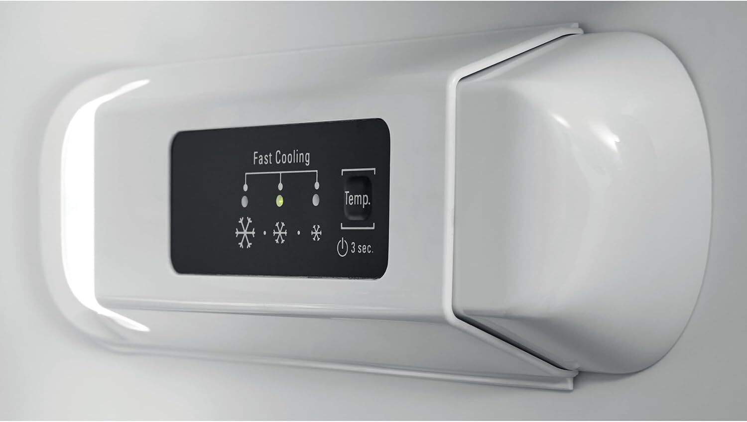

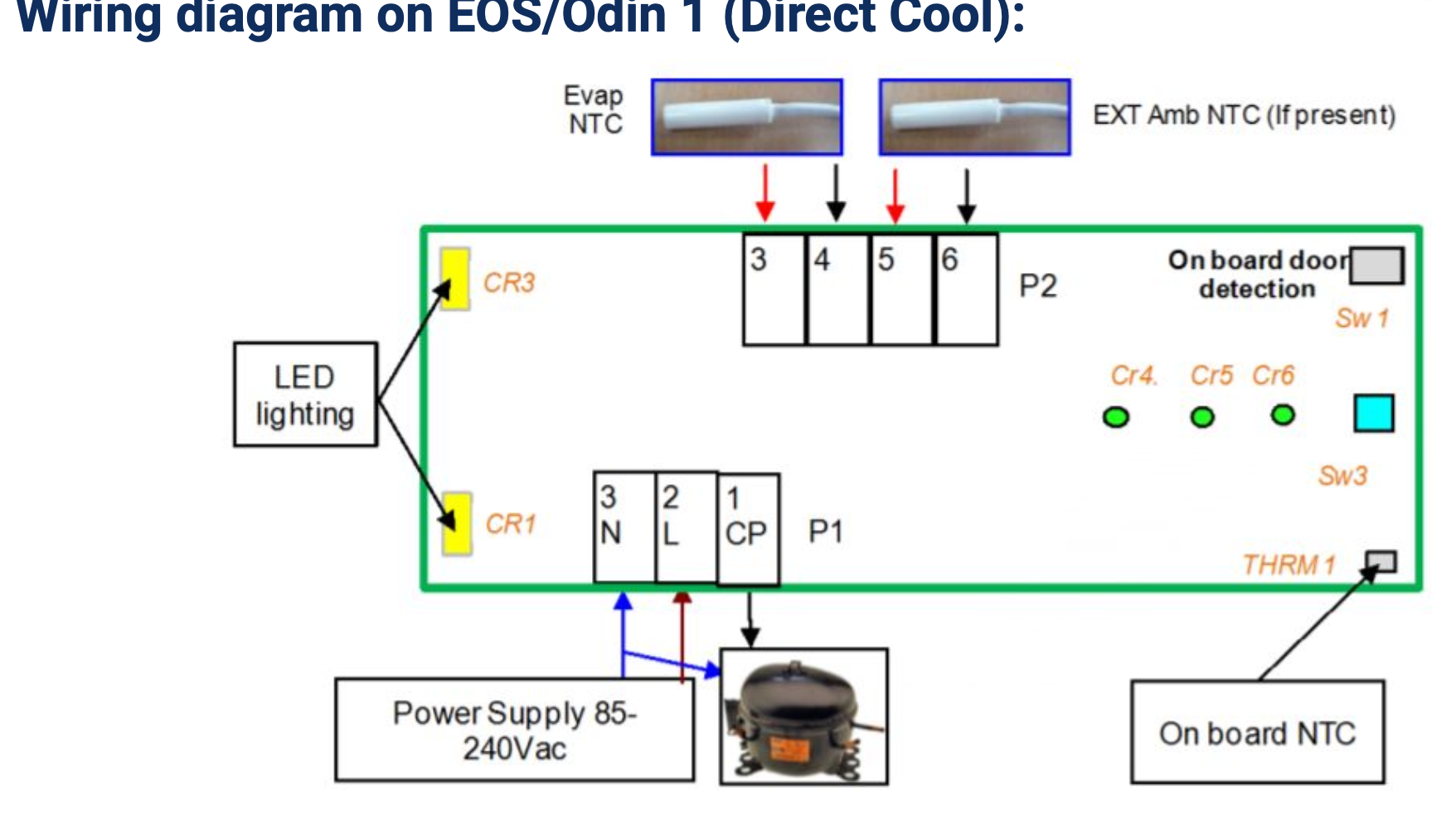

    I own a fridge with such a electronic thermostat (ET1). I could not find any information on how to perform an auto-test.
    There're plenty of companies that use it under different commercial names and yet I could not find the correct sequnce and error codes. I really hope some of you have it. The detailed wiring diagram will also be greatly appreciated.
