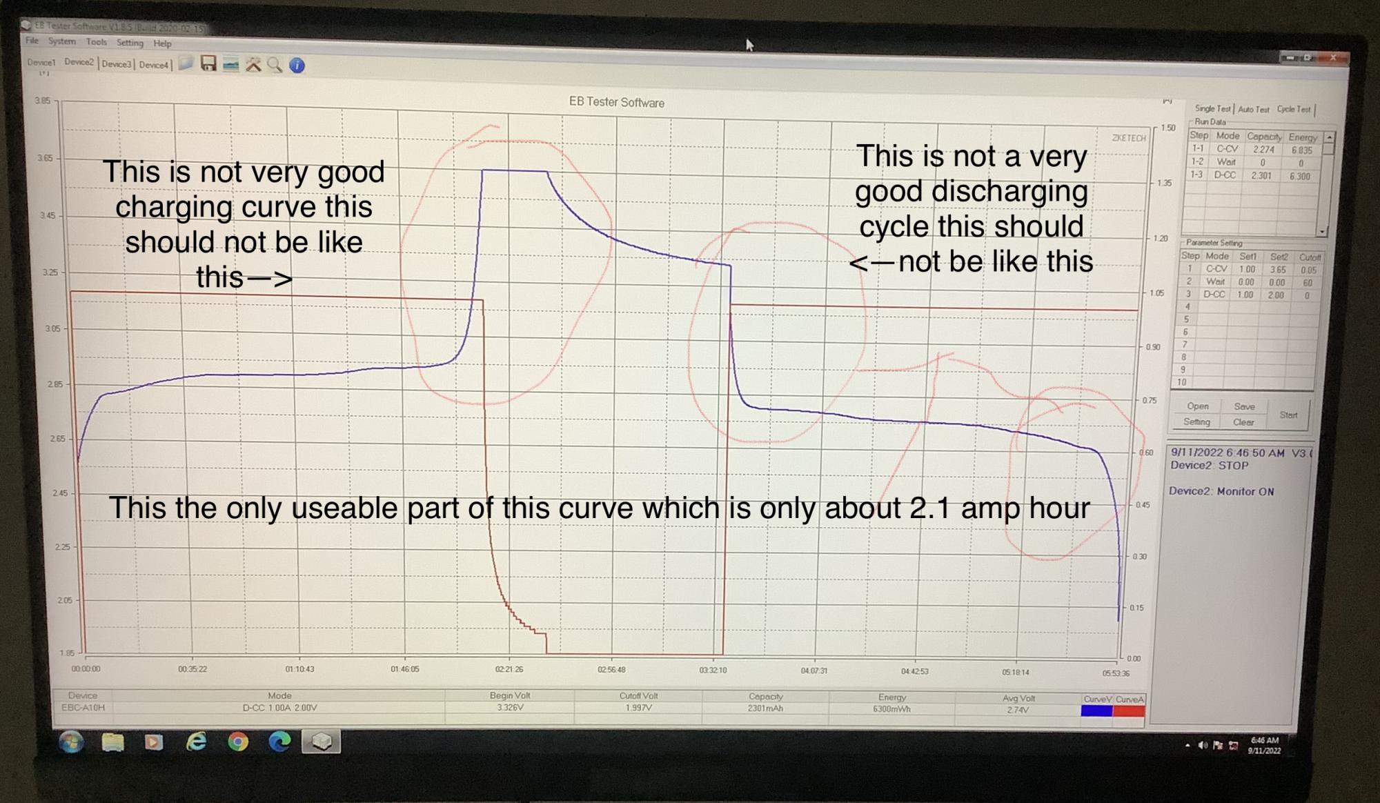

      Re: EBC-A20 Battery Testing machine capacitor failure on buck converter part of board
      Update on the unbalanced battery packs that I bought from Battery Hookup I got a refund for the 7 battery packs ( out of the 8 of them that I bought minus the shipping cost ) packs that had lost 30% or more of there useful life and there charge/discharge curves look like crap

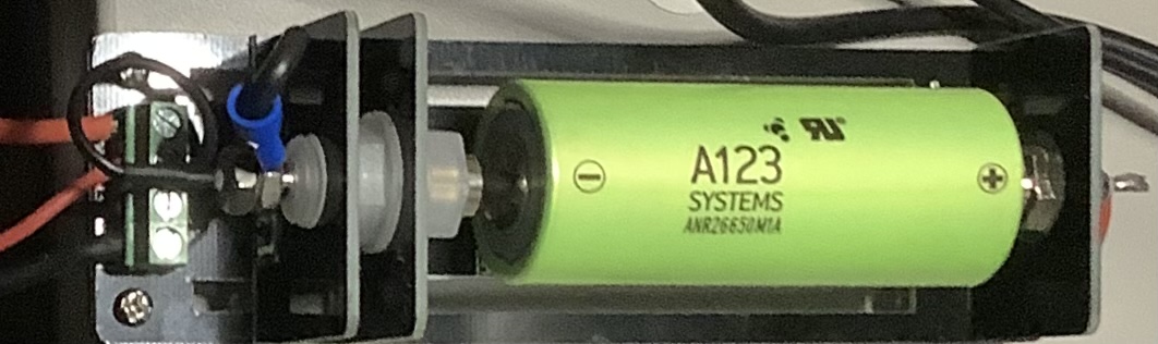

          Update using the eight channel battery testing machine
          I bought a case of 100 of these batteries
          https://batteryhookup.com/products/c...-batteries-new
          I tested a little over half of them milliamperes hours are little bit all over the place
          From 1100 to 1190 not exactly the same and few of the milliamperes are there but the voltage/current graph are all over the place so I have marked these cells to keep them together in a project
          One note is that they are only rated for 1100 milliamperes hours so they are what they say they are it
          If you are planning on using them with a BMS balancing protection the closer you can get the amperage hours to be the better the performance is out of the battery pack will be
          Most of the time when you test battery from a batch of them the amperage hours will very close to exactly the same result with these are not like this they vary a quite a bit
