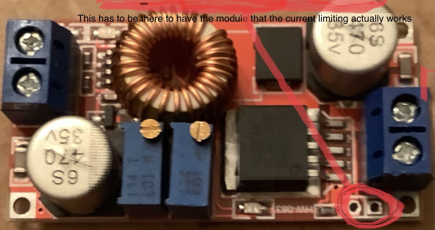

      Well I have finally found a working solution for charging battery packs with BMS protection boards
      Okay this one the current control does not work correctly but the meter module is very accurate for the type of meter it is
      https://www.ebay.com/itm/224143044400
      This one the voltage/current controller works correctly but does not have the meter module but the board layout is the exact same thing so the meter module sit right on top of it but you have to remove the pots from the board that does not work correctly and mount them on this board and you are ready to rock and roll
      https://www.ebay.com/itm/14473812508...Bk9SR5SUk7jyYA

          Update it turns out that only one out of the 5 that I bought was defective and the rest of work correctly
