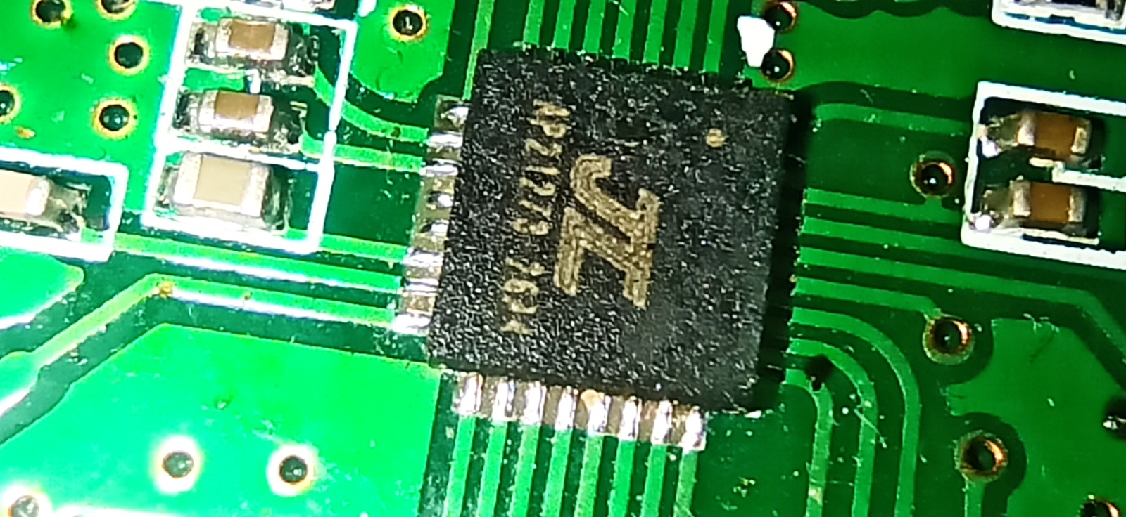

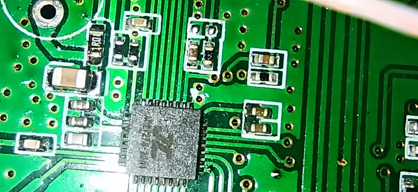

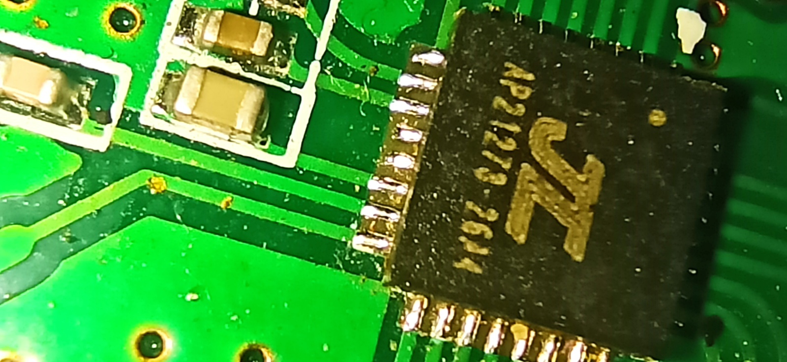

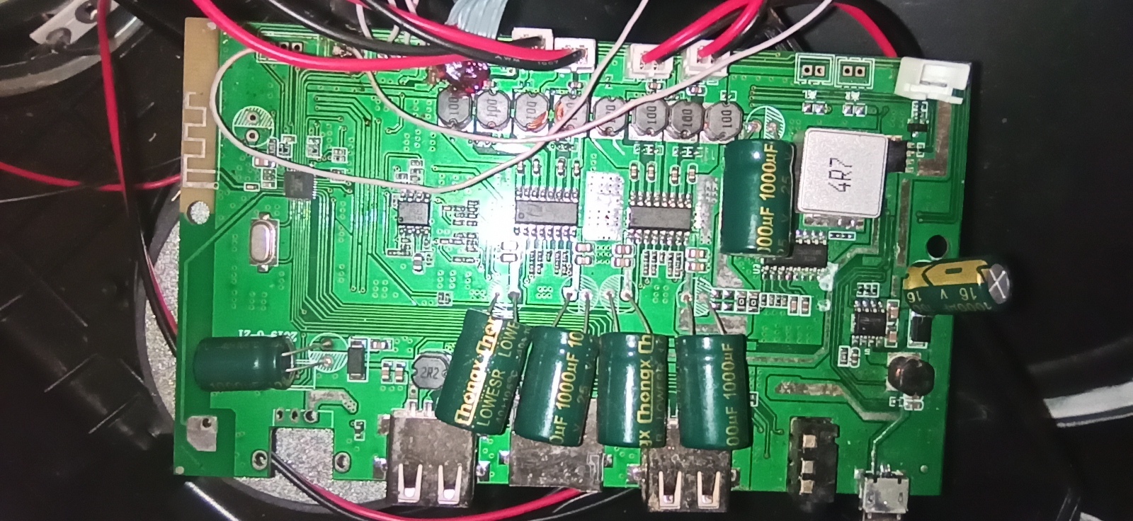

                  Help please identify the chip in the Chinese copy of the bluetooth speaker BOOMBOX Written JL chip ap21273-26 but there is no such thing on the entire Internet
                  • truclacicr
                    • Apr 2019
                    • 353
                    • australia
                    #29
                    The "JL" logo belongs to Zhuhai Jieli Technology Co.,LTD. The IC is probably a custom programmed part.
