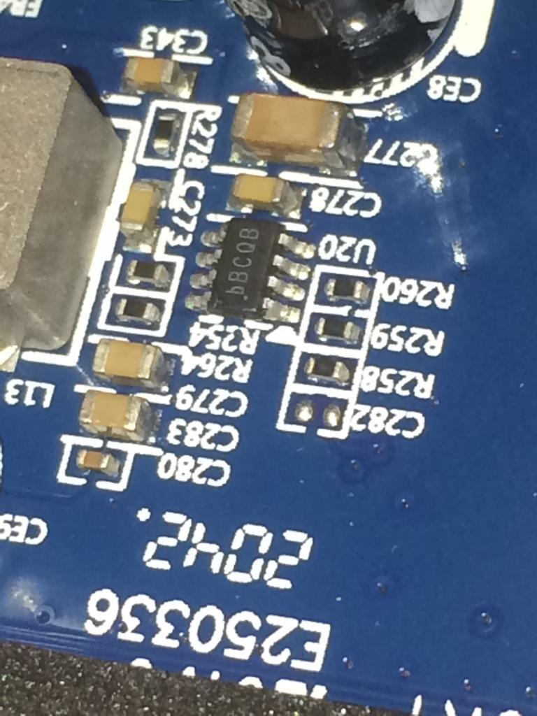

    Hello everyone
    Help in identifying a Boombox 2 ic
    mobo:b-2088 main pcb.
    Or if anyone has the electronic schematic to share.
    The circuit i want to identify the part number is in photo below:
    THANKS

    Same problem, in my case this chip has smd code bBCXC.
      • 21467
      Re: Ic identification boombox 2
      Silergy. bB*** - SY8263AIC
      https://www.silergy.com/zh/productsview/sy8263aic
      This Service manual/schematic for the JBL XTREME 2 might help if the layout is the same ,see U19 on page 18. https://www.manualslib.com/manual/24...2.html?page=32
