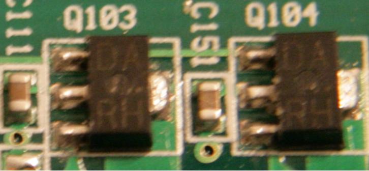

    How can I replace this transistor?
    I've been trying to find this transistor from my LCD thread. Any ideas on what it is or a substitute? Its from the inverter.

    Re: How can I replace this transistor?
    From the marking & package type, it looks like a BF622.
    http://www.nxp.com/documents/data_sheet/BF620_622.pdf
      Thank you. Looks right.
