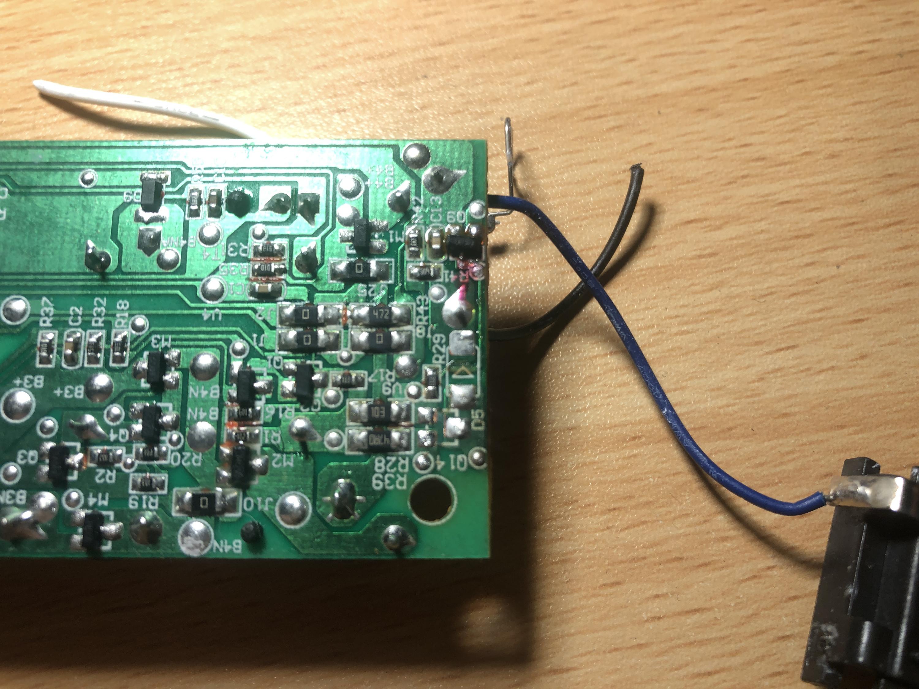

    Hi there - I am searching for a Duracell CEF22GBL-3 Battery Charger
    Its nothing SPecial, but on this Charger, there are 4 AA Bays and 1 9Volt Bay.
    The 9 Volt has stopped working, but the Rest seems Ok.
    1. Does anybody have a Schematic for this please, as I dont want to throw it away?

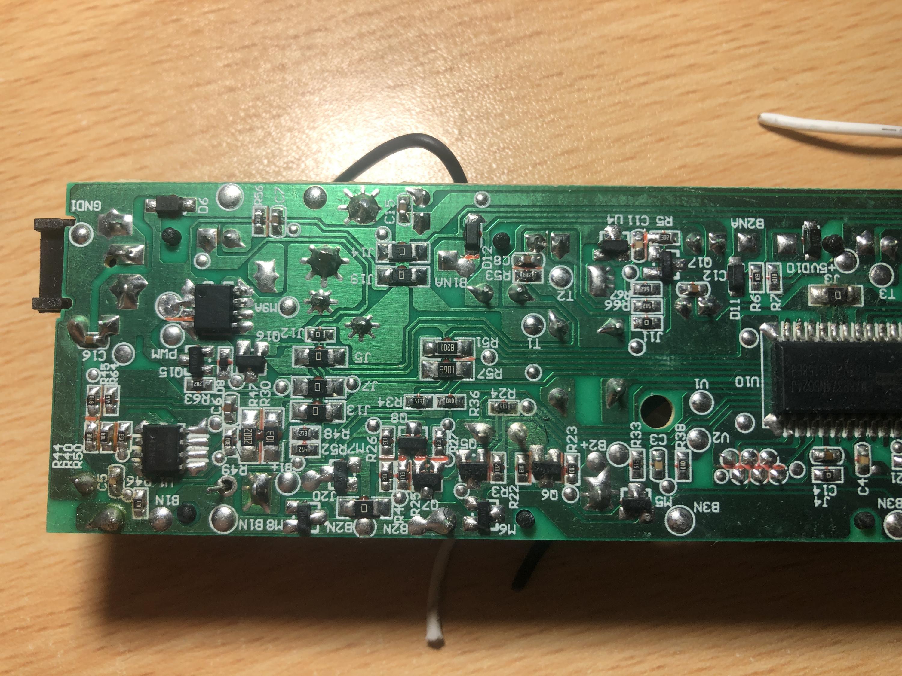

        Re: Duracell Battery Charger - CEF22GBL-3
        Here are the Photos
        In Pic 2 D5 and Q1 have been taken off
        The Main Semiconductors are
        Big IC - IC EM78P374NS024J
        Input Area - AS393M
        Input Area - A04409
        I cant seem to find Schematics anywhere for this unit.

            EM78P37x is Elan Microelectronics 8-bit OTP MCU, I think 4KB ROM for the 374.
            It's a MCU custom programmed for this application. You'd have to draw the schematic, I've never seen anything published out of china or taiwan for fear of copying.
            There's really no solder on the through-hole pad by R49 to B1N, and bad soldering to big through-hole parts is a common problem to look for.
            How are the electrolytic capacitors? It is powered by a wall wart? Wondering if it has the 9V power it needs.

                          Duracell does have a long "guarantee" on these I think 7 years so maybe hit them up for a replacement. Not sure how they are in the UK for consumer protection.
                          Wild guess is whatever modulates the 12V down to 9V, might have croaked. Like a small mosfet. But the charger also has some safety routines in the MCU so it will not initiate charging unless safe (i.e. sees say 6V) and the current is not too high. So your charger circuit might work fine unless you fool it properly with a dead 9V battery, or spoof it.
                                Hey Redwire - The Unit is Working now as I believe the Diode I removed was intermittantly breaking down.
                                Under normal conditions I found no components Shorted / Open, which was frustrating.
                                The only thing I havnt tested is whether it shuts off when the Battery is Full.
                                The 9 Volt is Charging, but the Charging light stays on.
                                Its amazing how complicated the Logic section is.
                                I still havnt recieved the Schematics yet, but if you need any Schematics, and I have many please just ask, as I have 1000's and 1000's
                                Regards and thanks for your response
                                  ps - If you look at Photo 1 of 4 it was Q1 and the Diode just above it that was breaking down
