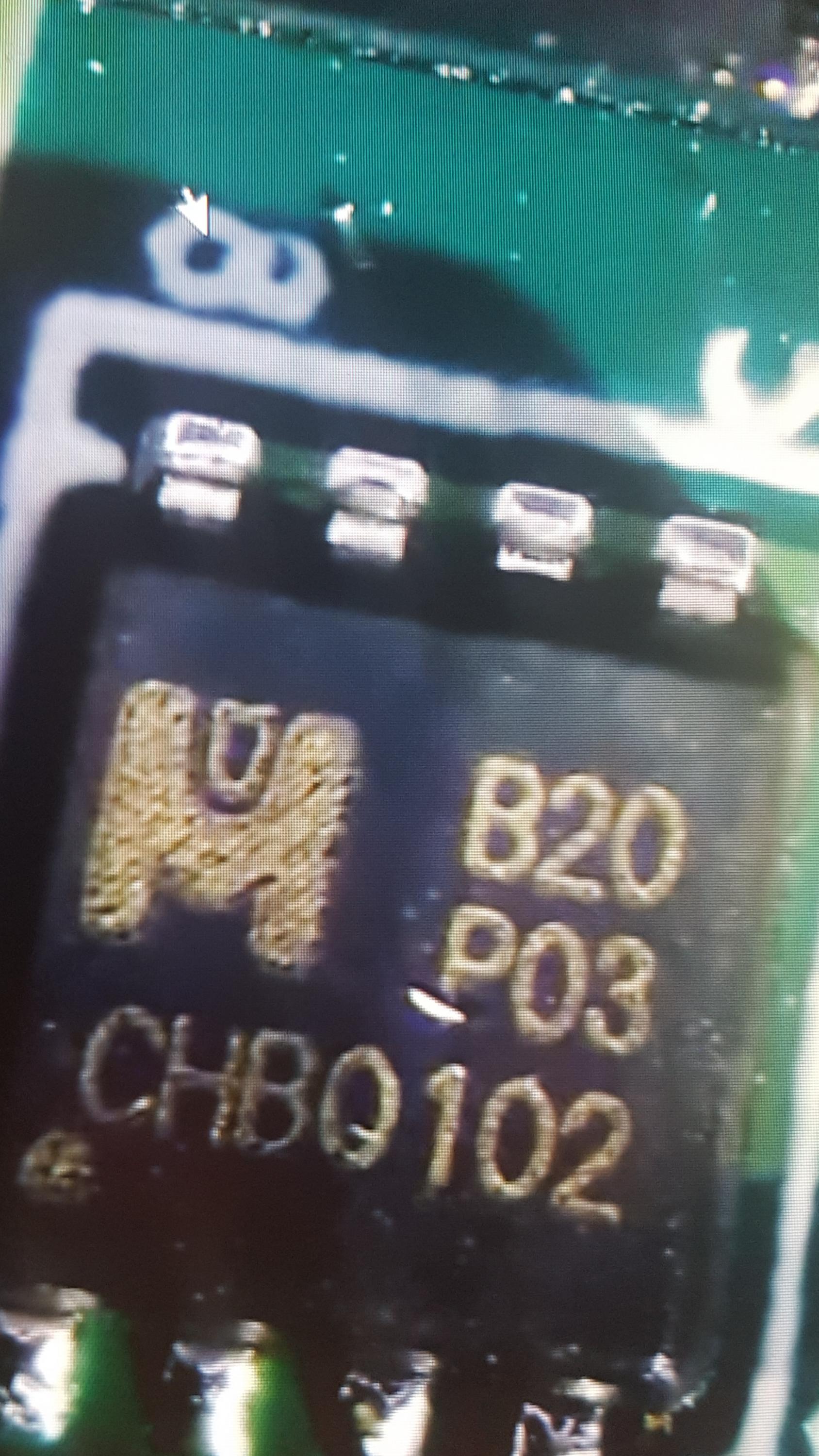

    Hi all.
    I'm having a problem trying to identify a fet on my board. the pic shows a different chip than mine but it's the manufacturer I need.My chip is B07 N03 ELA1406.
    Anyone help please.

    Excelliance MOS https://www.badcaps.net/forum/showpo...4&postcount=14

      Thanks for the help.
