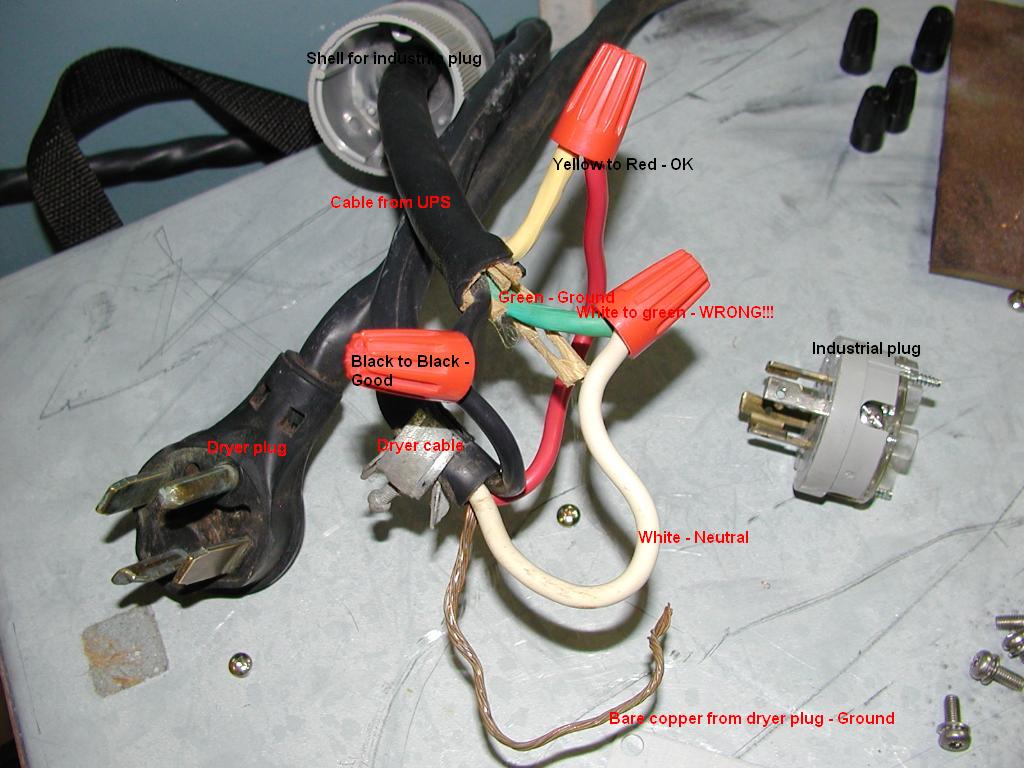

    Also the white going to green is the fault of whoever wired up the UPS in the first place. There are no other wires for the neutral to run along.
    Either we have a failure to communicate, you don't understand wiring principles, you have gremlins at your house, or you are trying to bullshit me. Take a look at the picture. The Green wire from the UPS is ground. SOMEONE hooked the white wire from the dryer cord to it. You don't need a neutral wire, you need a ground wire for safety.

      The green wire from the UPS should go to the bare copper wire as PB said. The neutral is not needed since unlike your dryer the UPS has no need for 120.

            The batteries are rated for 6V. They come in modules of ten (wired in series so you get 60V DC per module) and two modules fit into a box. (so each battery box I got outputs 120V DC)

                So dig out your battery charger. If it's a 12 volt charger, hook it across two batteries in a module and plug the charger in. (Don't forget to observe polarity.) If the charger has an ammeter, does it show the batteries are charging? If it DOES show it is charging, leave it hooked up for at least 4 hours (ideally until the charge rate tapers off), then move to the next pair of batteries in the string until you get all of them charged. Then go to the the next string in the module.
                By the way, once you get the battery pack charged, you might want to avoid touching the leads. 120 VDC packs a pretty good punch.

                      That is the symptom of a dead gel-cell.
                      One infamous experiment I tried involved hooking a light bulb in series with the input of a bridge rectifier, then hooking the DC output of the bridge across a 6 volt gel-cell. This was plugged into my variac and I cranked the output up to roughly 140 volts. This means the peak voltage across the cell was about 200 volts DC!!! The bulb didn't even glow. Eventually it broke down the insulating layer on the electrodes of the battery and I was finally able to get it to take a charge at approximately the recommended charging rate. I then switched to a conventional charger, then put the battery into a 350 VA UPS, let it charge overnight, then plugged in a small load and unplugged it from the wall. The 'rejuvenated' battery lasted less than a minute. Not an auspicious sign.
                      The easiest way to 'trick' the UPS into starting up is to hook 10 ea 12 volt car batteries in series to the battery terminals.

                                    I understand this IS a seven year old thread, but in the end (jesus christ I never throw anything out) I got it running.
                                    Originally posted by pentium, seven years ago View Post
                                    Okay then. I guess I can write this iff as an irrepairable unit as there's no way I'll ever find a set of 40 new 6V cells for a dime a dozen.
                                    Lmao, in reality they were all 12V cells. Each battery tray has 10 cells (120v DC). Two trays run in series. Two sets of two in parallel. Roughly 240V DC with a scary amount of amps.
                                    http://i11.photobucket.com/albums/a1...d/IMG_6676.jpg
                                    http://i11.photobucket.com/albums/a1...d/IMG_6675.jpg
                                    http://i11.photobucket.com/albums/a1...d/IMG_6678.jpg
                                    With new connections in the recycling industry I was able to find used but still good cells in bulk and was able to rebuild all four trays. Having used other UPS systems in the meantime I learned that most UPS units will not come up if the battery side is no good.
                                    With the batteries replaced it was reassembled and the breaker thrown.
                                    https://www.youtube.com/watch?v=DI1EJmD3IJQ
                                    The harmony of the fans alone was bittersweet music to my ears.
                                    So there we have it. MY original problem was simply all the batteries had to be replaced...
