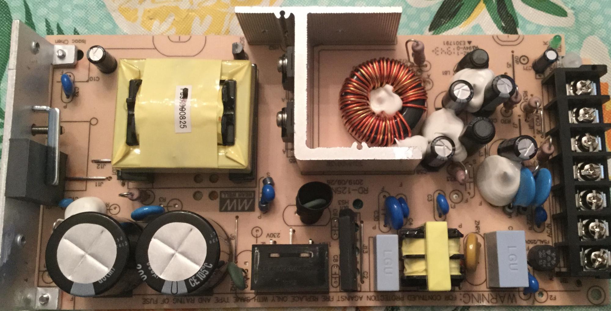

    Here is the data sheet for this ic chip it is for A or B version not for F version but the letter has to with what frequency it is using for this version
    https://cdn.badcaps-static.com/pdfs/...7acd988ac4.pdf
    This is a dual voltage output version ( output 1 )12 volt / output 2 24 volt output

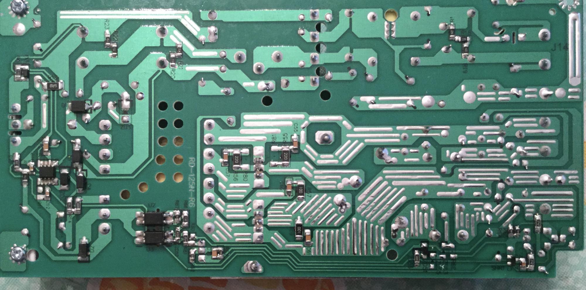

    There dose not seem to be much circuitry on the secondary side of this power supply
    Curiously got the best of me and I had to see how this power supply was made

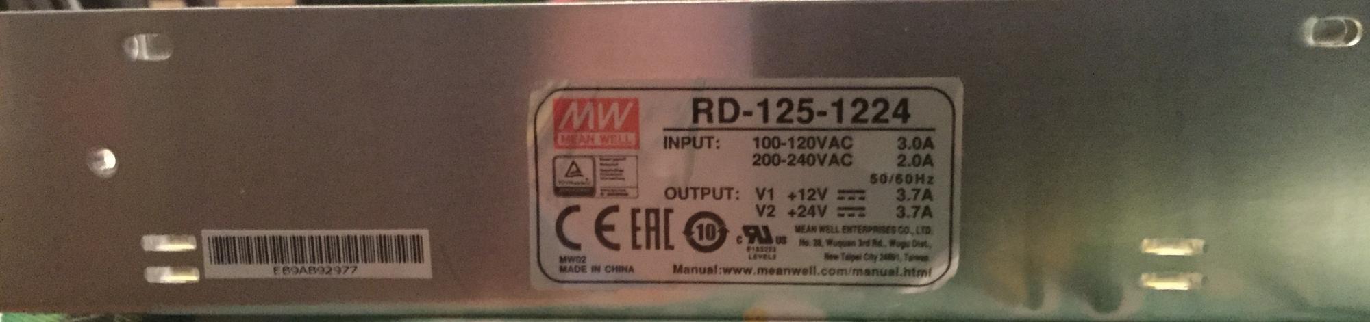

        Be careful when buying a dual channel switching power supply because some seller are miss interpreting the specifications of this type of switching power supply
        Putting the maximum amperage for each channel and not what each channel outputs if you use both channel together at the same time but on the data plate shows the maximum output if both channels are used at the same time and does not tell you what the maximum amperage is if you use only one channel which to me is a mistake on there part
        This would not take that much space on the data plate for this information really
