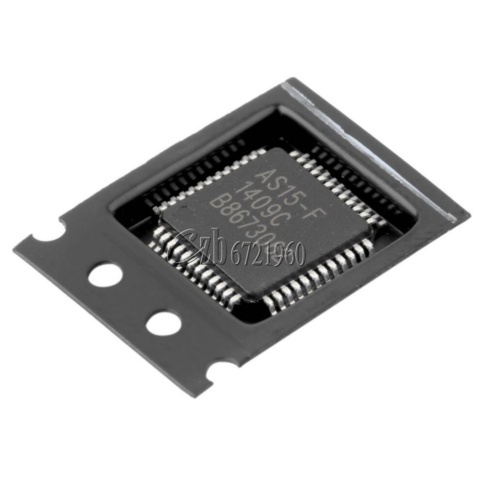

    just had a thought and wondered if my 100w iron would heat an as15 ic enough to remove it ? the bloody thing is surrounded by tiny components that i would rather stay put .

    What's an "as15 ic" ? What package is it

      i believe it is a QFP48
