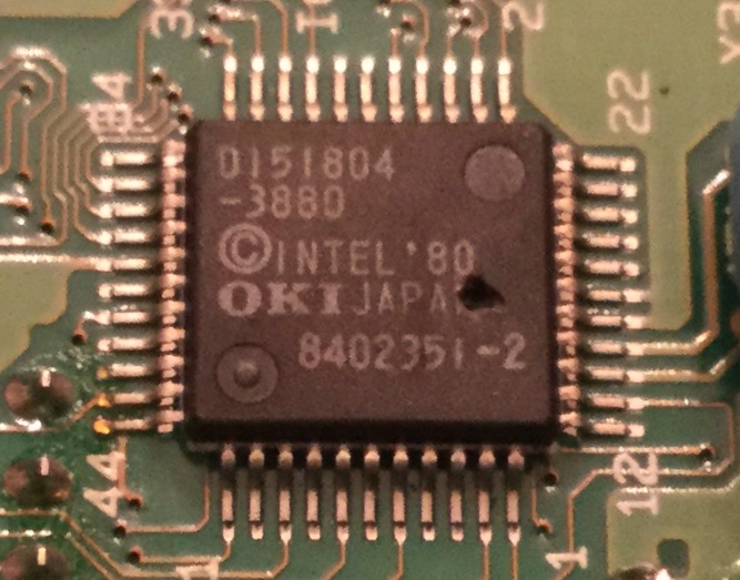

    Re: Allen-Bradley SLC 500 PLC —> CPU fault what does mean
    I found out why the CPU fault light is on
    Look at the picture of the ic chip
      I dont think that one is going to make it. Going to attempt to find a replacement?

          Re: Allen-Bradley SLC 500 PLC —&gt; CPU fault what does mean

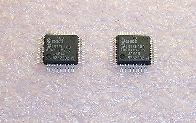

          I don't think you will find a replacement ic, easier to find a used SLC500
          It might be a OKI M82C55A-2 ; MSM82C55A-2 QFP44.
          or AT89S52-24AU
              I'd be looking to see what has caused this. The chip, on its own, would hardly experience such a fault.
              Does this connect to the field or any "high-er voltage/power" devices, elsewhere?
                  The site's dirty power could make a big surge between two phases, or to ground. You might have an issue with bad grounds between mains power, the PLC and the I/O.
                  The control transformer (480-120V) primary could be wired Delta or Wye, and a Delta could go overvoltage if one phase got lost. NEC requires a control transformer (480-120V) secondary to be grounded, so the PLC power should have a neutral/ground there.
                  The 24VAC transformer I would see if the secondary is grounded somewhere or it is floating?
                  I would find out why the chip blew up on the CPU module. That looks like a good surge hit it.
                  If an I/O card got zapped or is shorted, it could put high voltage on the backplane back to the CPU module.
                  It's something I would also check, so the replacement CPU card doesn't get damaged.

                          That's weird, never thought to see of low power CPU chips blow chunks. The bond wires are much thinner than of power transistors and die bonds will fail fairly readily?
                          But anyway, chances of finding a replacement IC is going to be problematic because it looks like it indeed is a QFP 8051 OTP/mask programmed microcontroller and not an 8255.
                          Time to redesign the whole system ... ?

                              However that chip that has the hole in it seems to control the outputs on main part of the PLC because all the output LED lights are all ON
