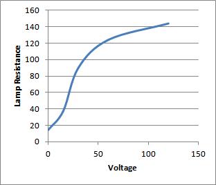

      You might be over-torturing things using light bulbs as load? Their resistance is non-linear and much lower when cold.
      A 100W 120VAC bulb is 144 ohms lit but at 1/2 voltage drops to 124 ohms, and 1/4 voltage is 90 ohms.
      I found sometimes an SMPS can't "get it up" and stays stuck outputting low voltage and high heat. Would have to graph power vs voltage.

        Well, with lower voltage, even with lower ohmmage the amount of current is lower.
        100W (RMS)
        120V 144Ω = 100W = 0.83A
        60V 124Ω = 29W = 0.48A
        30V 90Ω = 10W = 0.33A
        So the current is still going down as voltage goes down, and diode loss is (V=0.7)*I (though V goes up slightly as I goes up...) which is mostly linear.
        The thing I was hoping for is that I would expect the above to be "average" current. Peak current flow is what I'm not totally accounting for, and this would be much higher than 0.83A. Then again most diodes have higher peak current limits.
        Anyway I was hoping to get 300W from this supply for proof of concept. That would be less than 3A average, so these diodes should be able to handle it -- as long as they stay cool.
