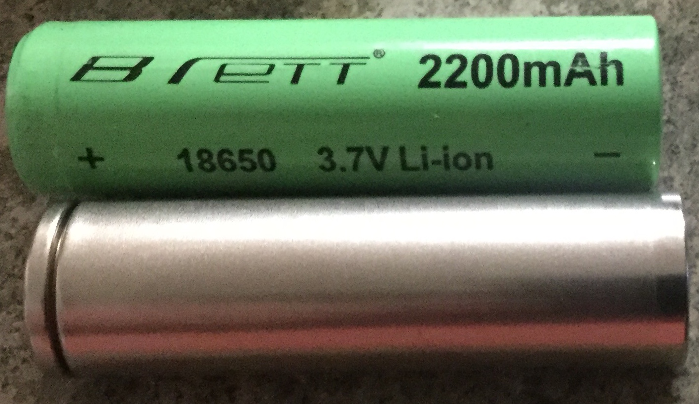

    I bought a couple of flashlights from AliExpress for half way decent price
    But here are some down falls of the product
    The switching power supply is basically a joke
    It has a optic sensor feedback but the charging voltage is controlled by a zener diode
    The car charger is more of a joke it only has drop down resistor
    Now as far as the battery concern the label says 2200 milliamperes not quite it only 1500 useable and tested at 1660 milliamperes
    Now I like this flashlight and here why
    The outermost LED Cob light is about 180 milliamperes
    The center LED Light is about 300 milliamperes on high
    The center LED light is about 180 milliamperes on low
    The center LED light is about 300 milliamperes in flashing mode
    So if you use a 3200 milliamperes battery your run time will be quite long

    btw, *never* buy these with the battery - it's a slavage job with no protection circuit - even if the label says otherwise.

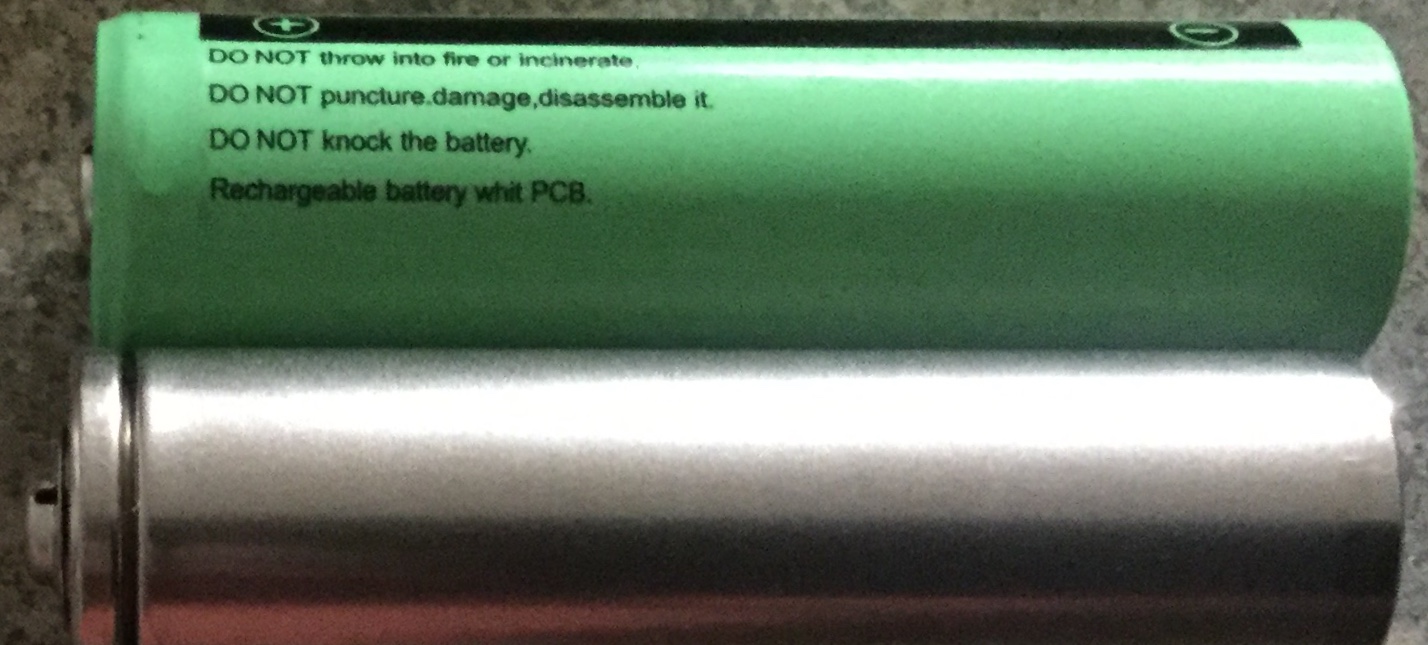

    Now if the battery has decent battery protection board the charger that comes with it— it might work alright but I would only do that if I know what company made the battery and the protection board

      take the sleeve off the battery - i bet it's not protected even if the label says it is!!

        about 90% of the *.fire stuff has no protection even if stated that it does.
        a zener to set charging voltage is silly.
        sounds like this thing isnt worth the tinfoil its made of.
        if the designer/manufacturer didnt have even a tp4056 board in the budget this thing is solidly in the pure trash category.
        a resistor to charge a probably *.fire grade battery?
        a splash of gasoline and a match is a much more predictable way of starting a fire!

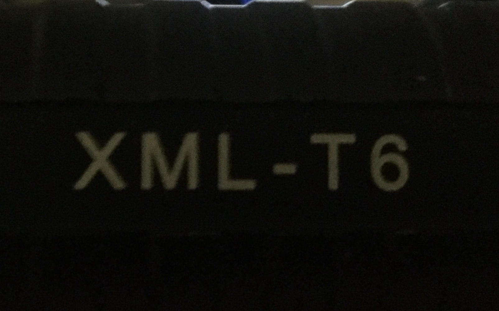

        an xml-t6 claiming 6000 lumens?
        xm-l xm-l2 make around 1000lm@3a.

            Most of the time
            I do pay very much about what a company claim about brightness and about battery running time because
            Most of the time they full of crap
            The brightness of this flashlight is decent but the only complaint I have is the focus is a little bit crap-ee in that it is square all the way in and way out it is mostly a circle
                    First of all it does not say that it has a protection board
                    This is a no brand name battery it has a green heat sink tubing and the outer shell of the battery once you remove the heat shrink tubing on either one there is no printing
                          let me guess.
                          Here is a photo of the model of flashlight and battery that I am talking about
                          As you can see there is NO protection board any where on this battery
                          They are trying to hurt someone with this crap really

                            notice the battery says "whit pcb" and "discharge protection" lol
