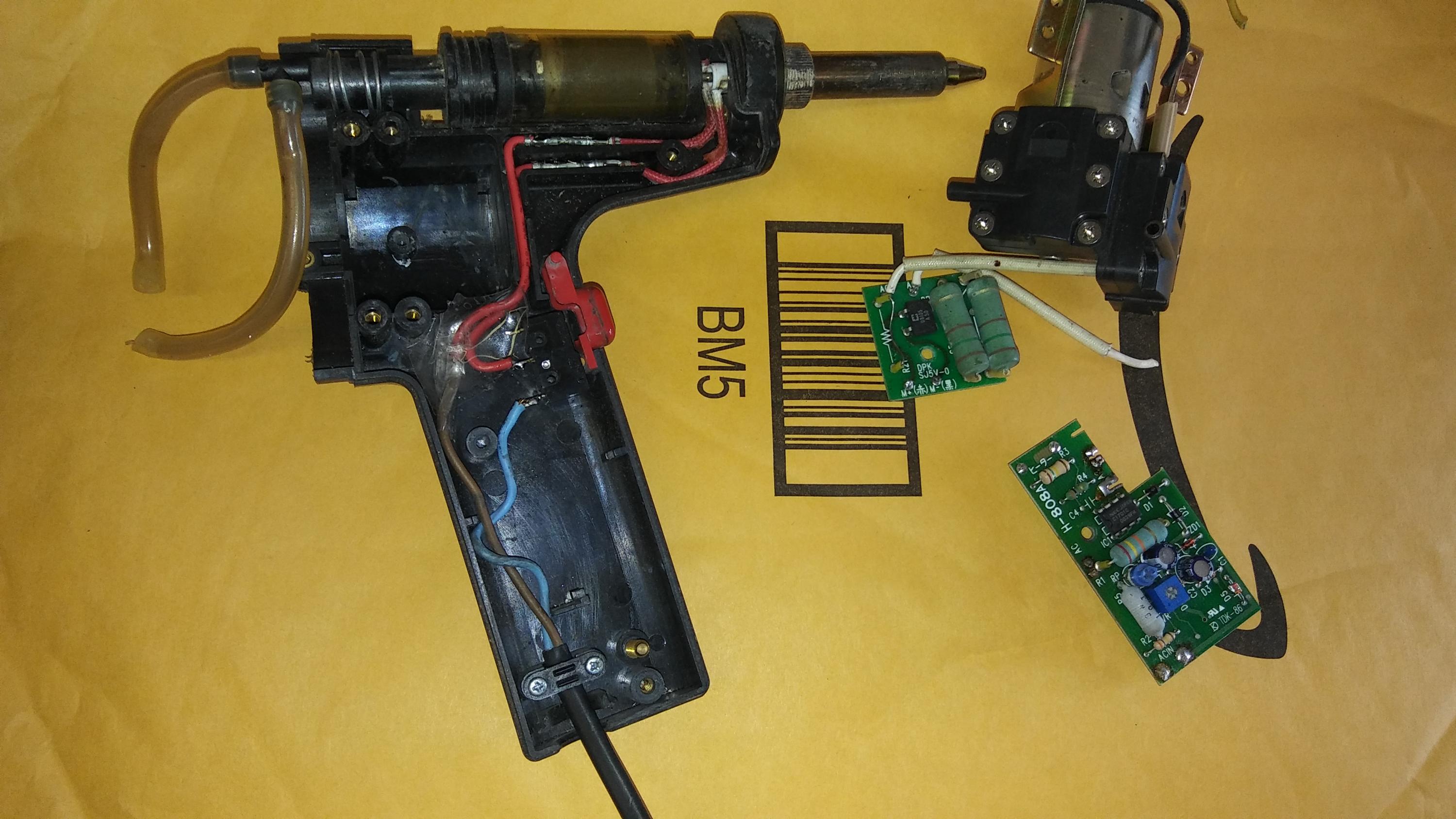

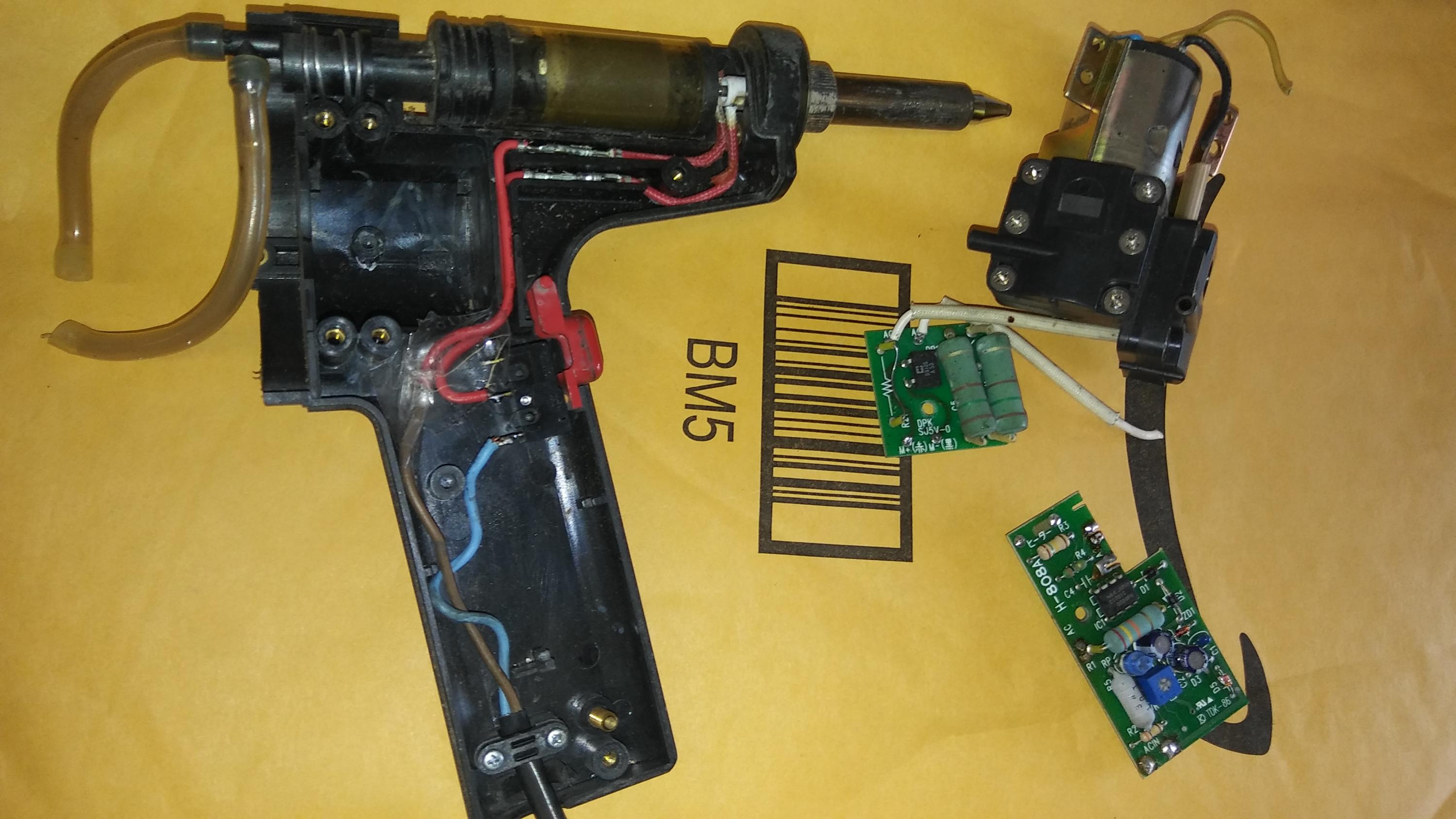

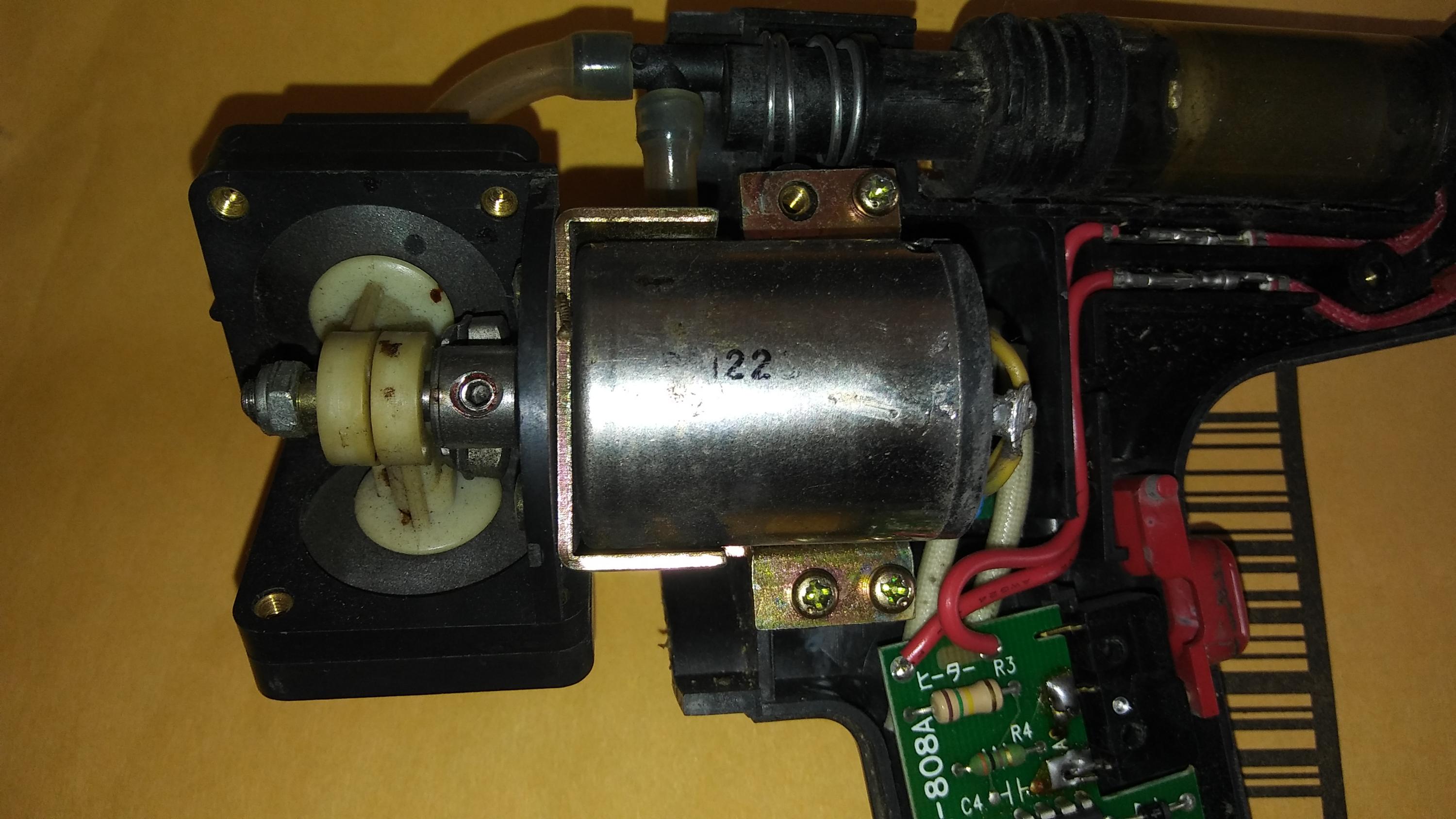

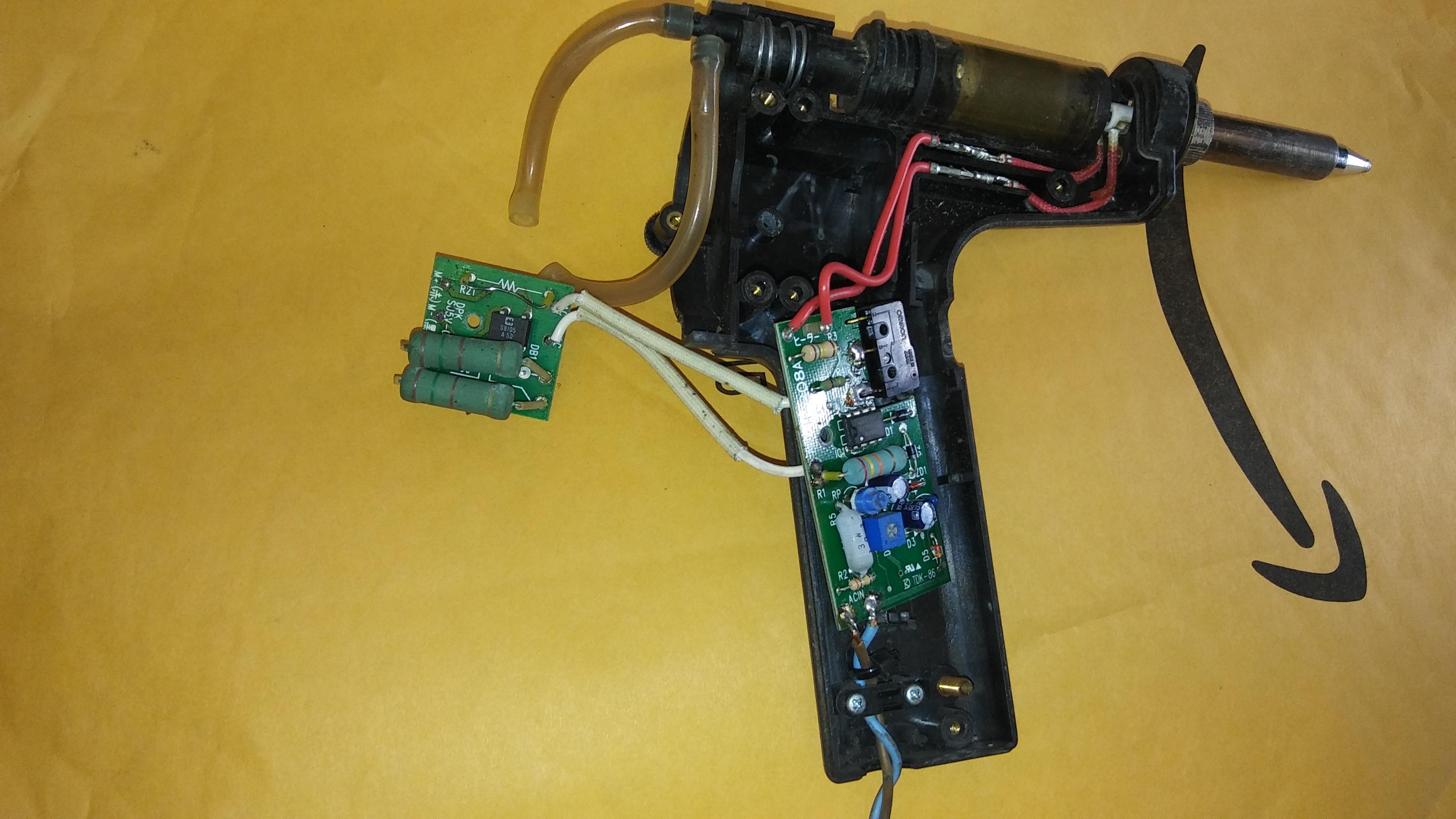

    Hakko 808 desoldering extrasensory perception tool.

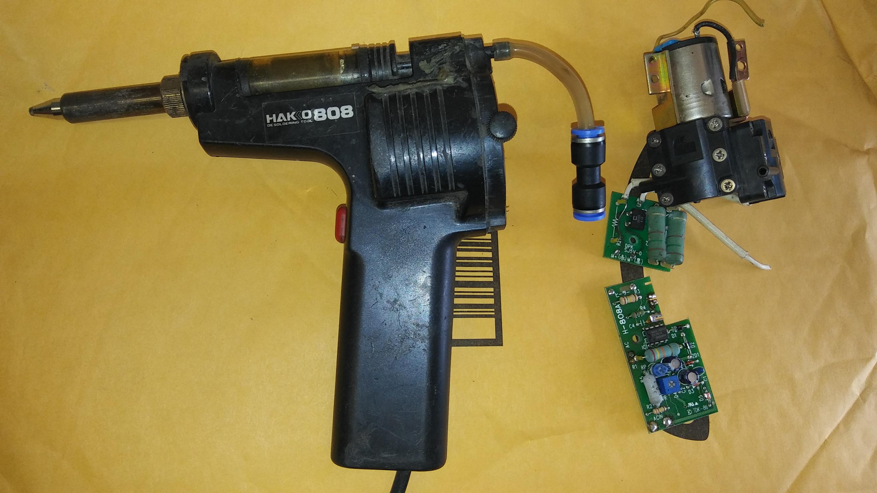

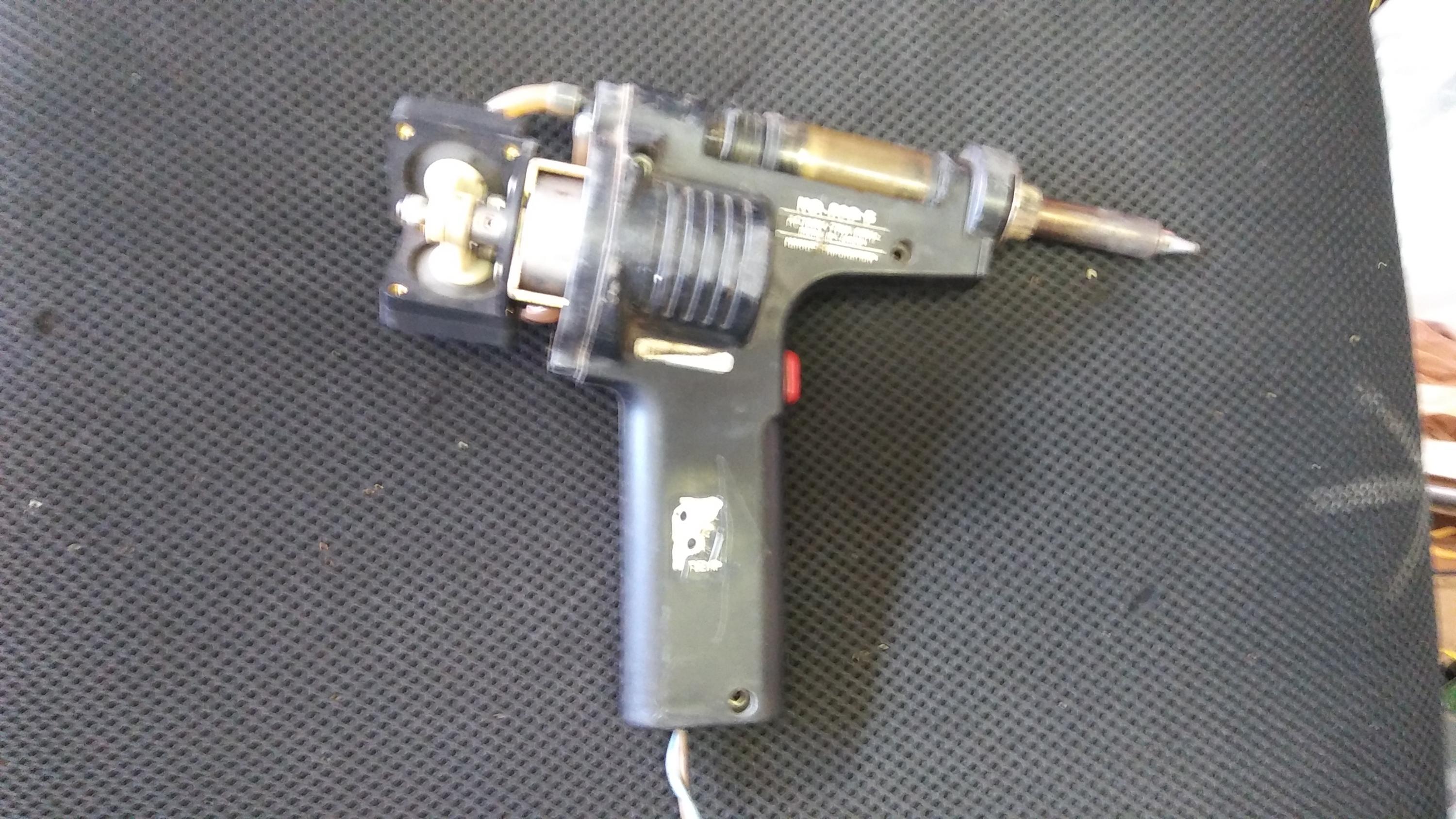

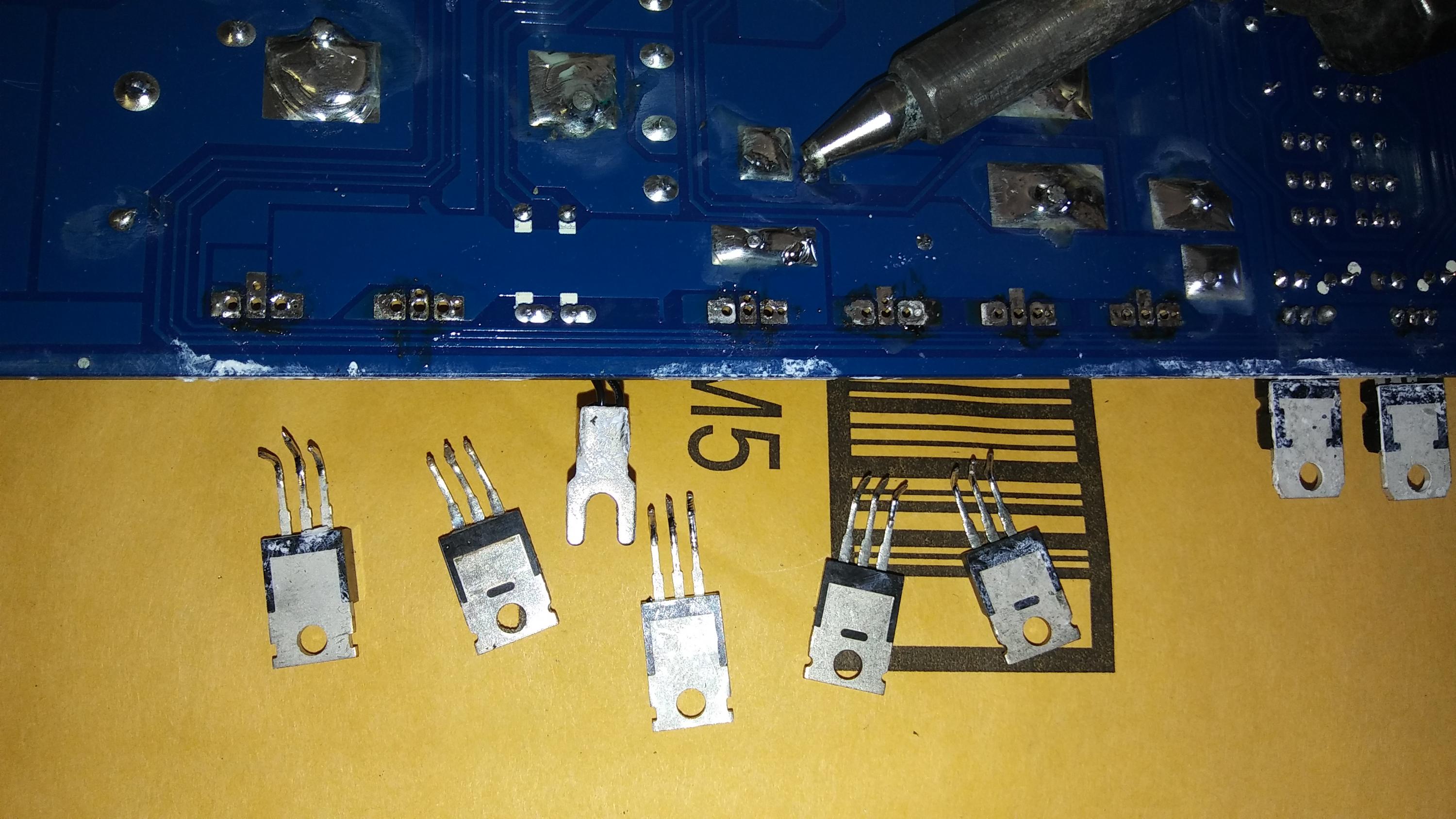

    I tried to change my old, unfunctional Hakko 808- 5 desoldering tool to extrasensory perception desoldering tool.

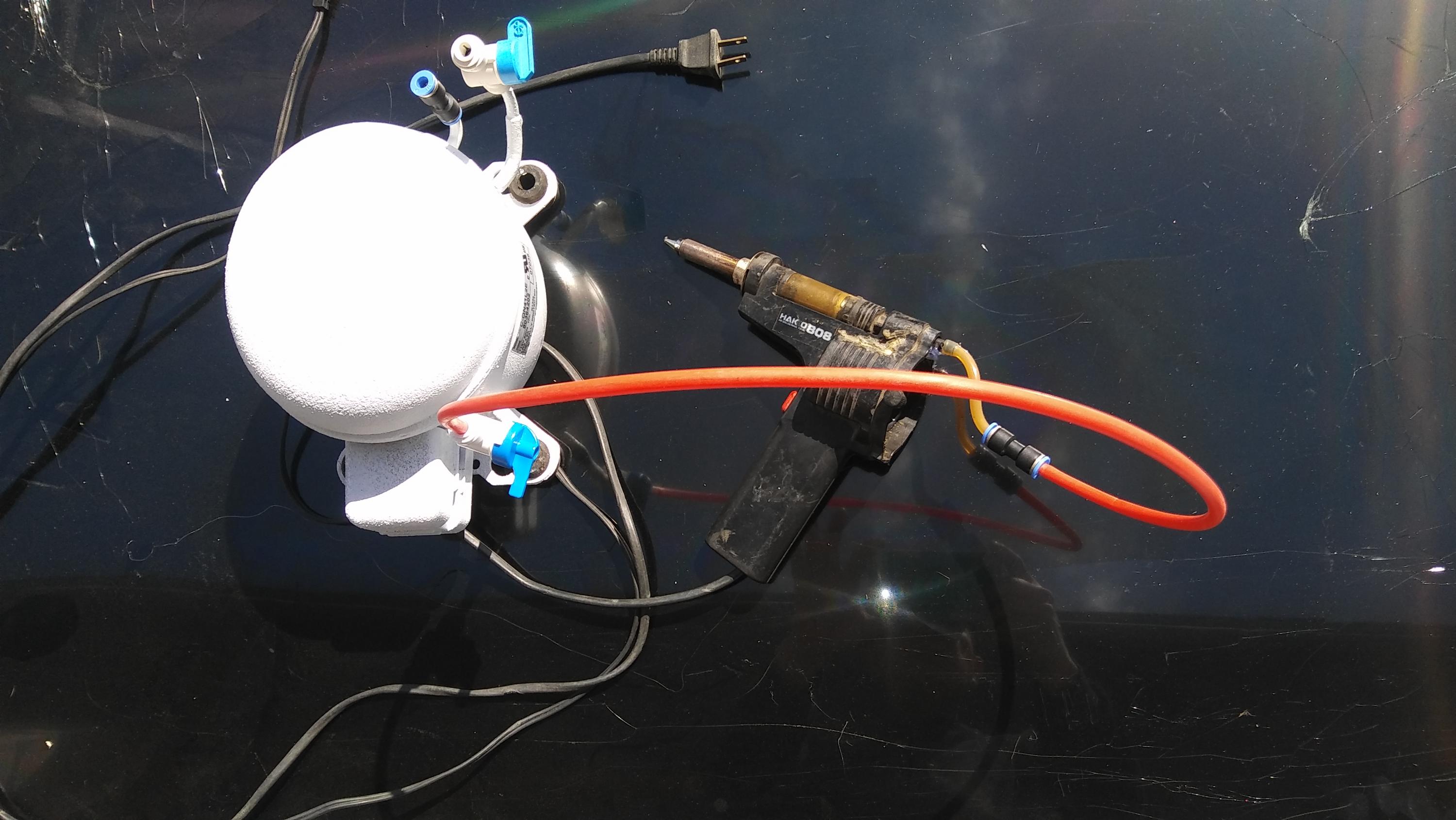

    Re: Hakko 808 desoldering extrasensory perception tool.

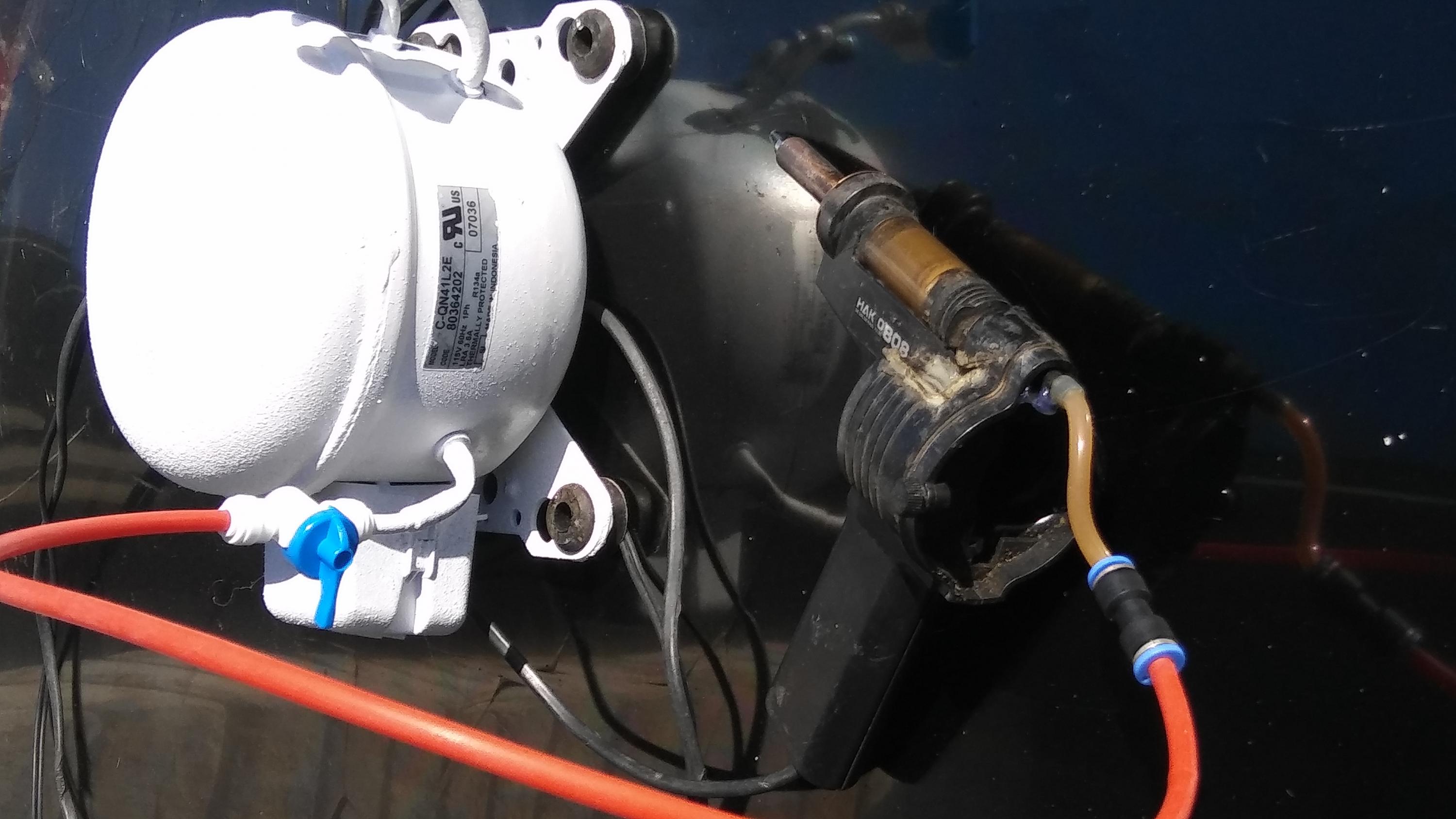

    Best combinations! Best results.
    No needs container when using the vacuum because the iron case of the compressor itself is a vacuum container.

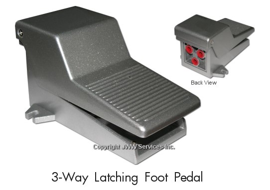

    I have a question every time I need to turn the valve to make a vacuum suction. Is there any footswitch for a vacuum valve or push on-off valve? I try to keep it simple, don't want to use electronic valve.

      something like this https://www.veneersupplies.com/produ...-Position.html
      There may be similar units cheeper
      Or this one: https://www.amazon.com/Air-Mite-Mini.../dp/B00P6XL0T6

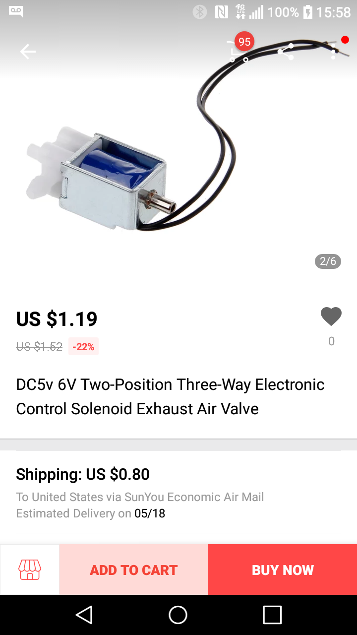

        I appreciate your help. But my budget is only ten dollars. So I will go with this one. Picture1.
        One more benefit is I can use the same outlet switch between vacuum and compressed air. Why? I will show you once I get the parts.

          I appreciate your help. But my budget is only ten dollars. So I eat my words, I will go with this one. Picture1.
          One more benefit (3 ways) is I can use the same outlet switch between vacuum and compressed air. Why? So 852D+ could heat up SMD part with hot compressed air then pick up with a vacuum.
            I was going by this
            thats why I picked them.
              You might not be able to use it for vacuum function because if it uses pressure to assist the valve function
              Because the description says exhaust valve
