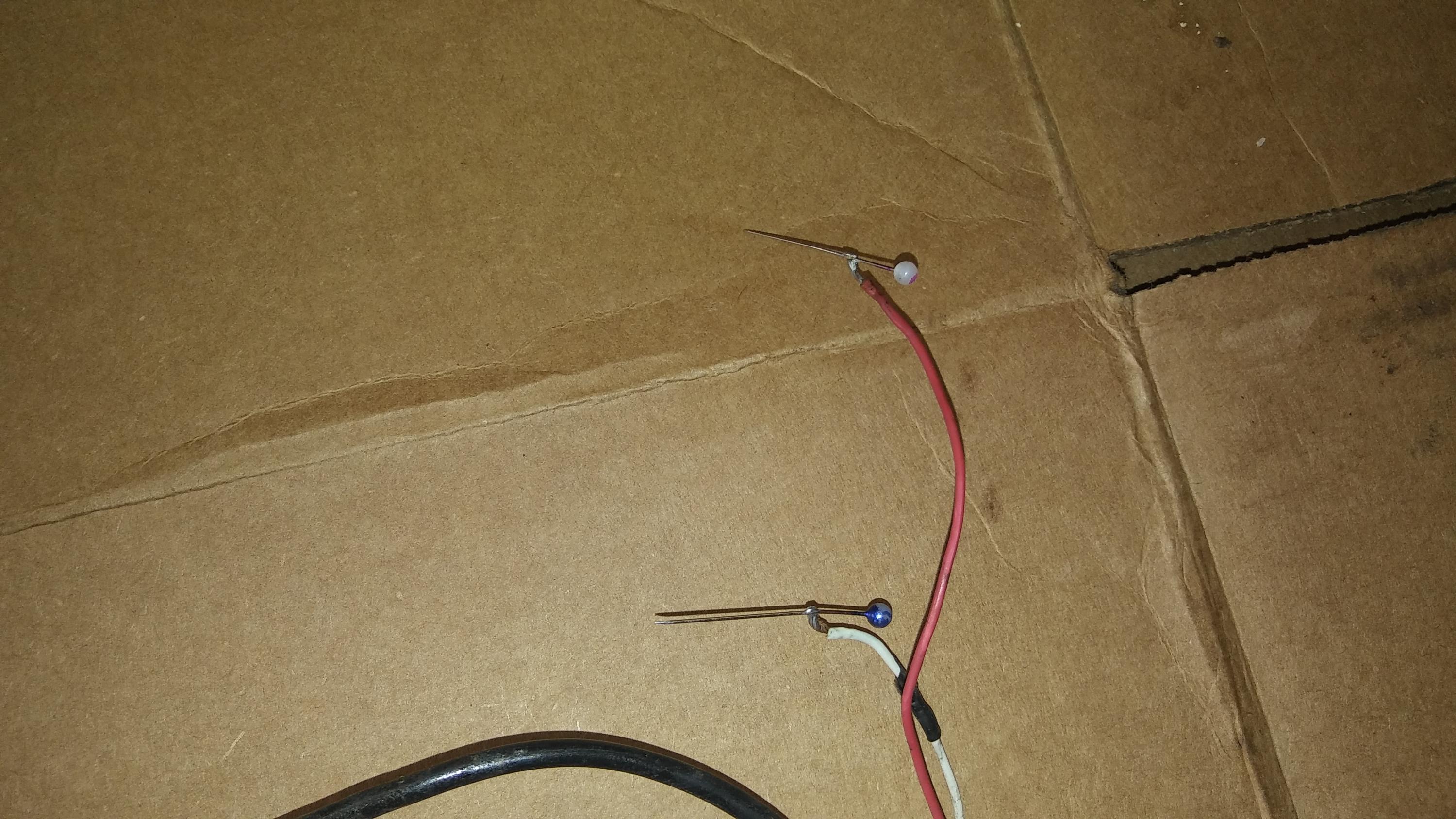

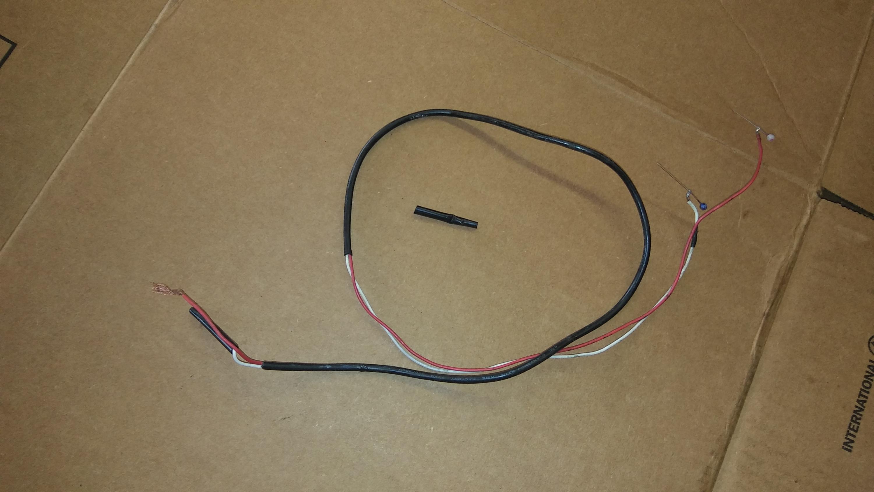

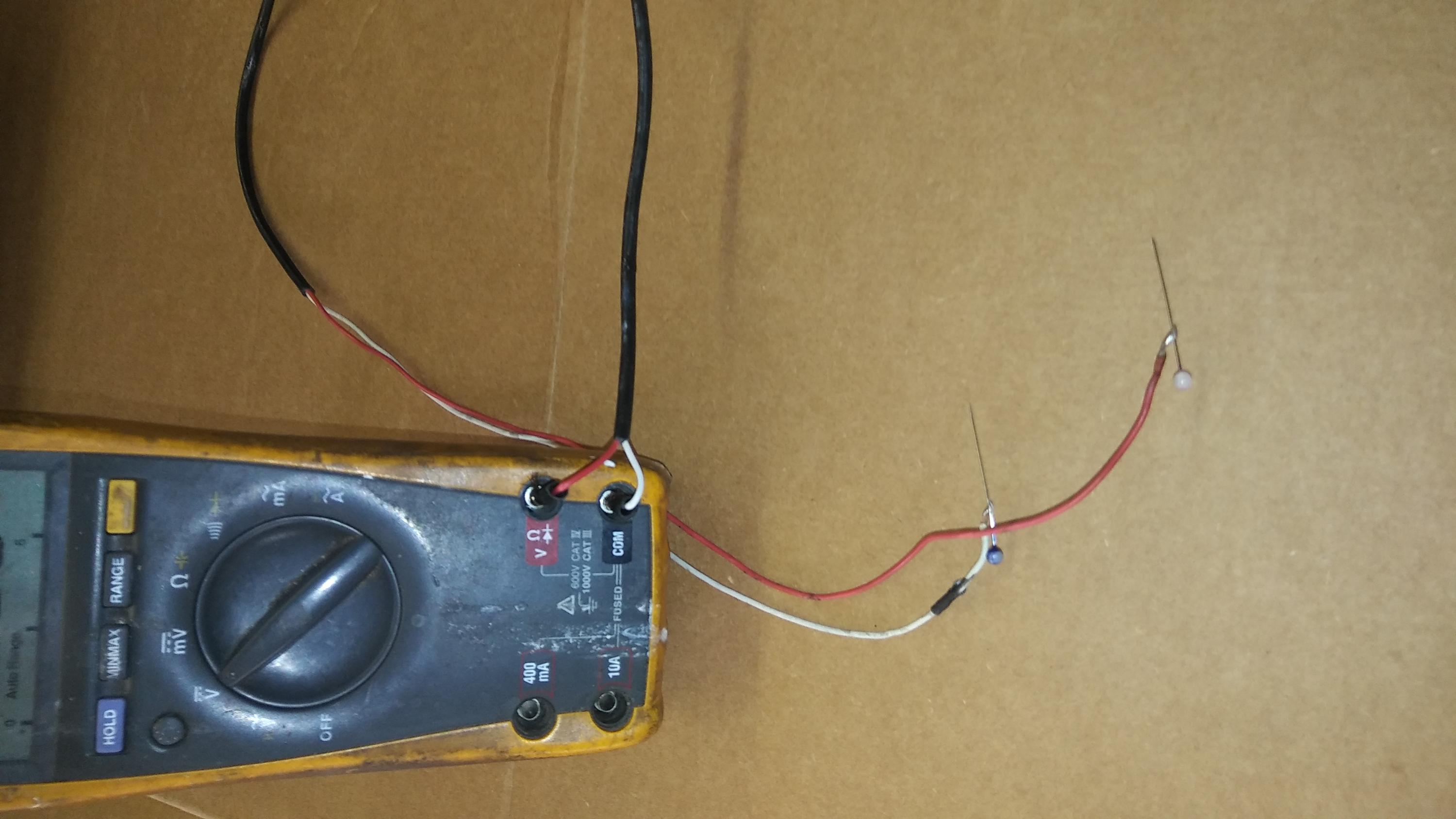

    Tips: Homemade test leads.
    The black tube is a Disposable Plastic Coffee Stirrer Straw from McDonald's.

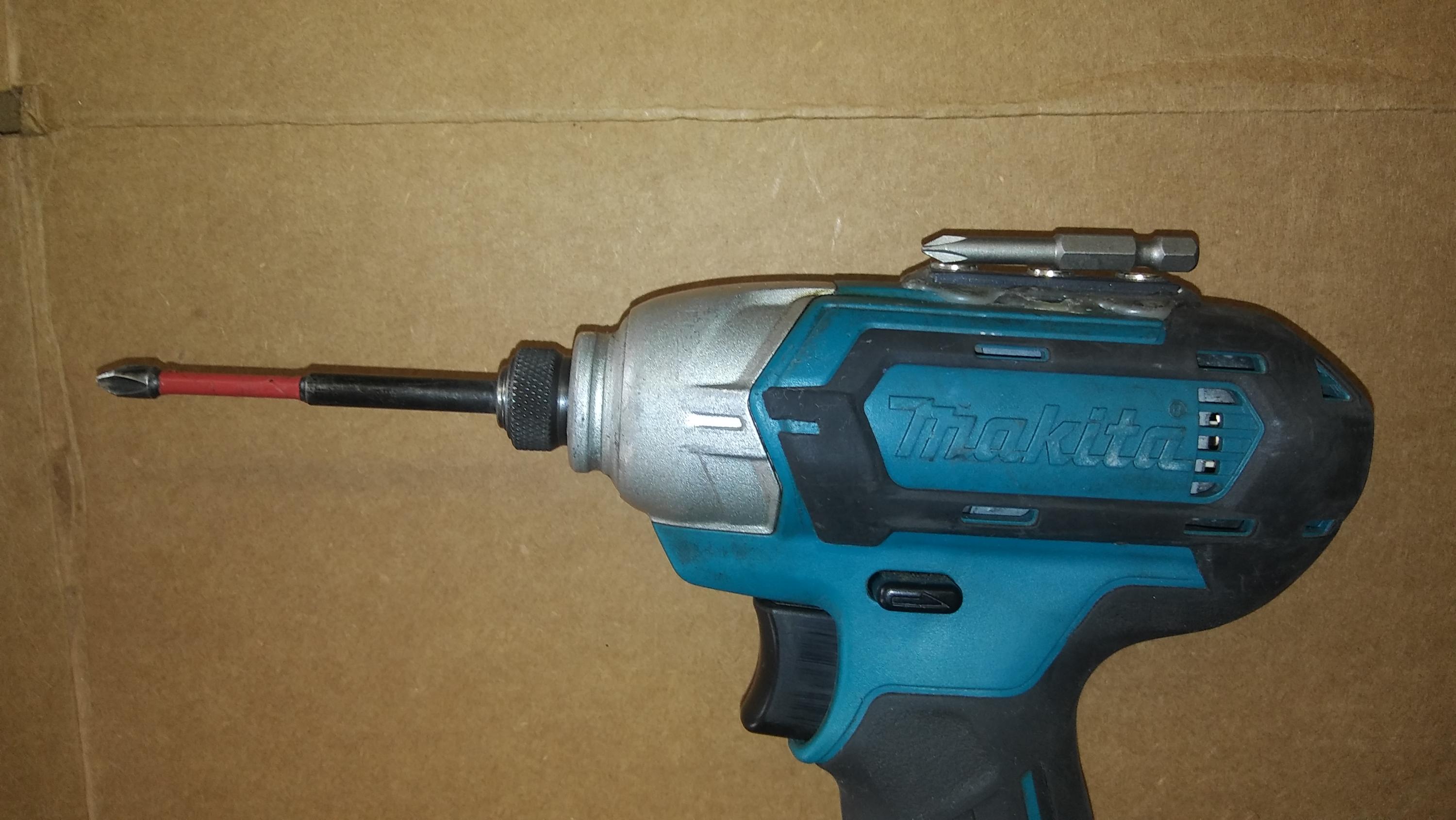

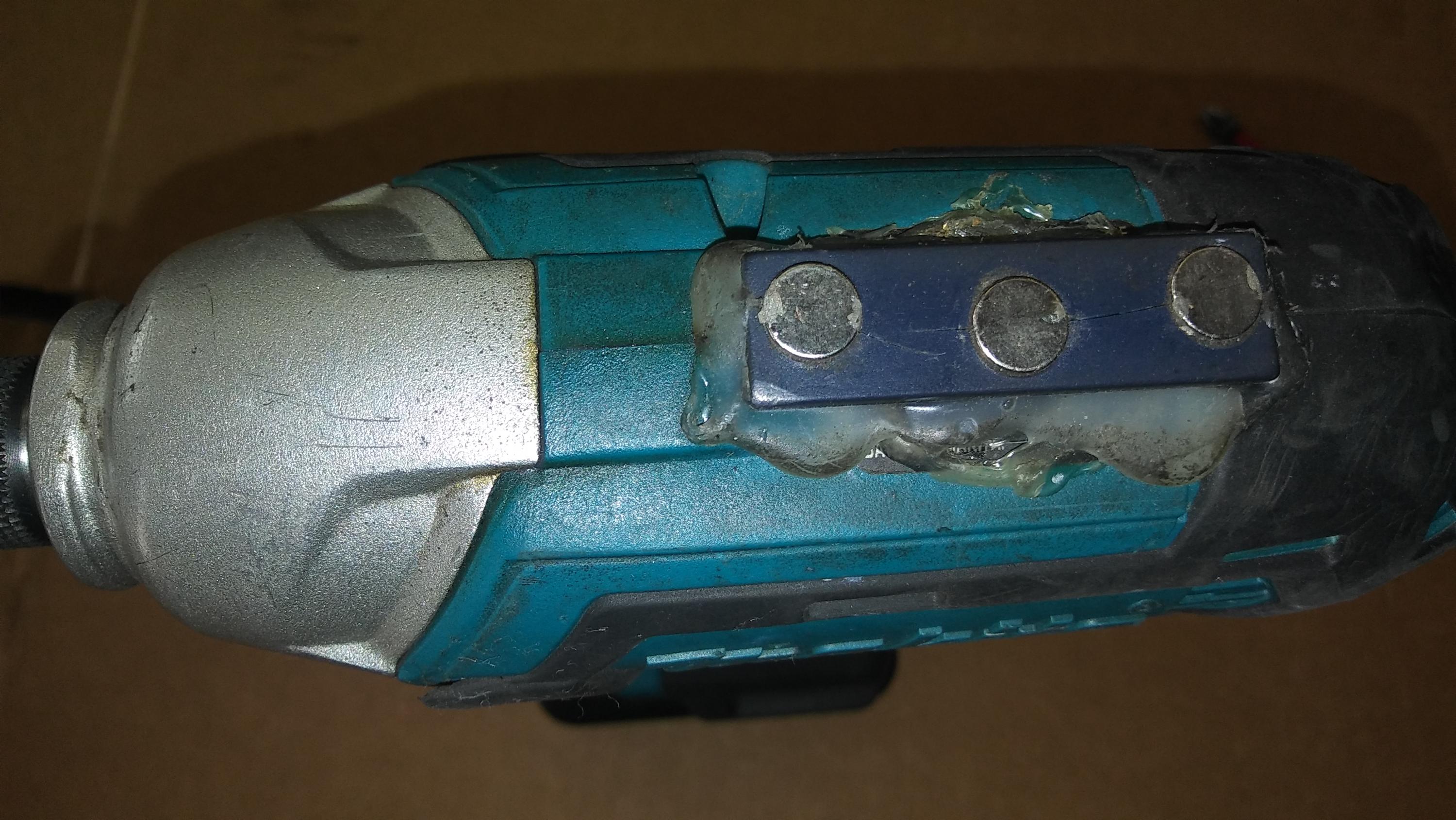

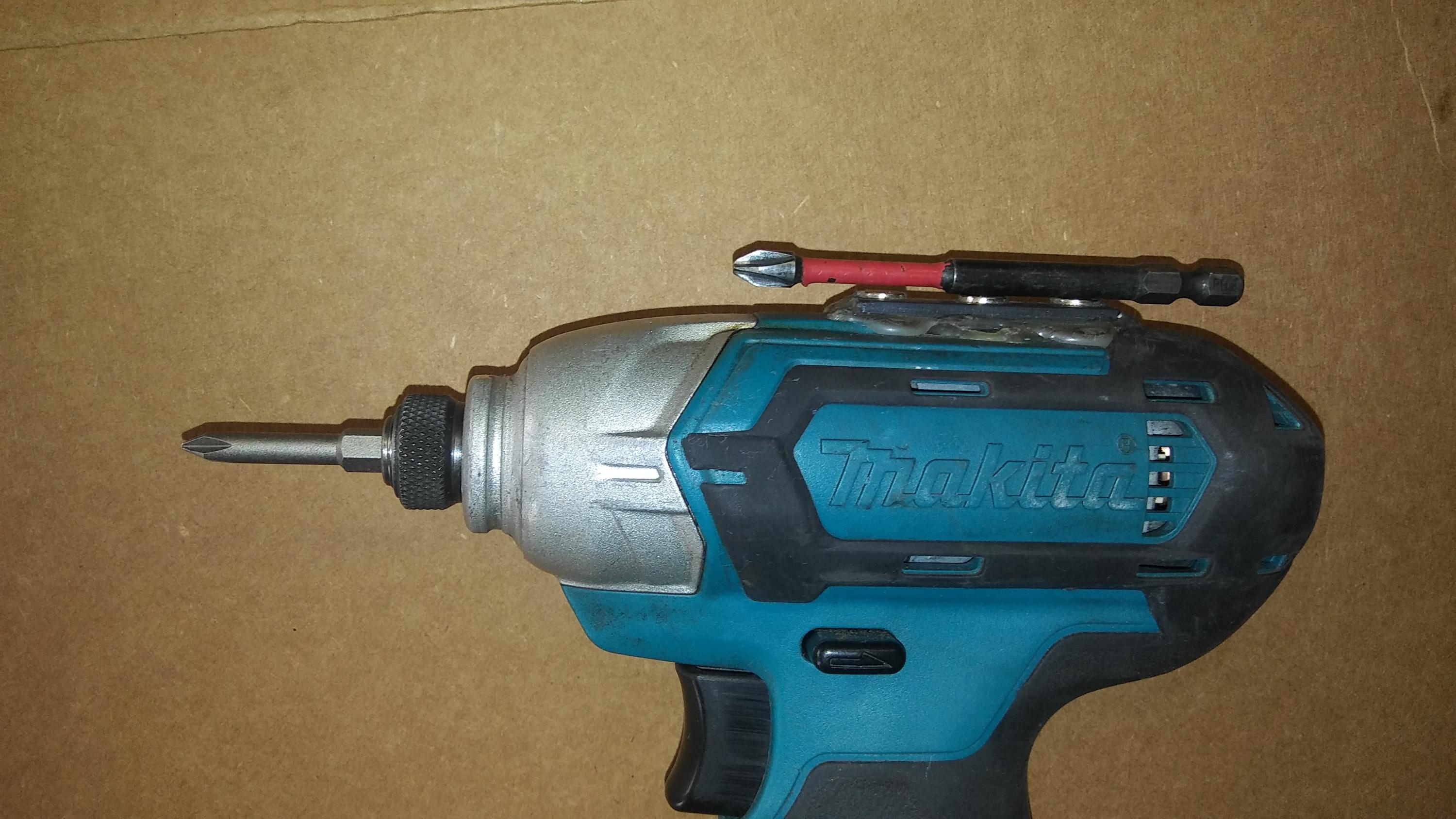

    Tips: The most common one I use is the screwdrivers of Philips 1 and 2 and I often can't find it so I put it on the magnet with my cordless drill.

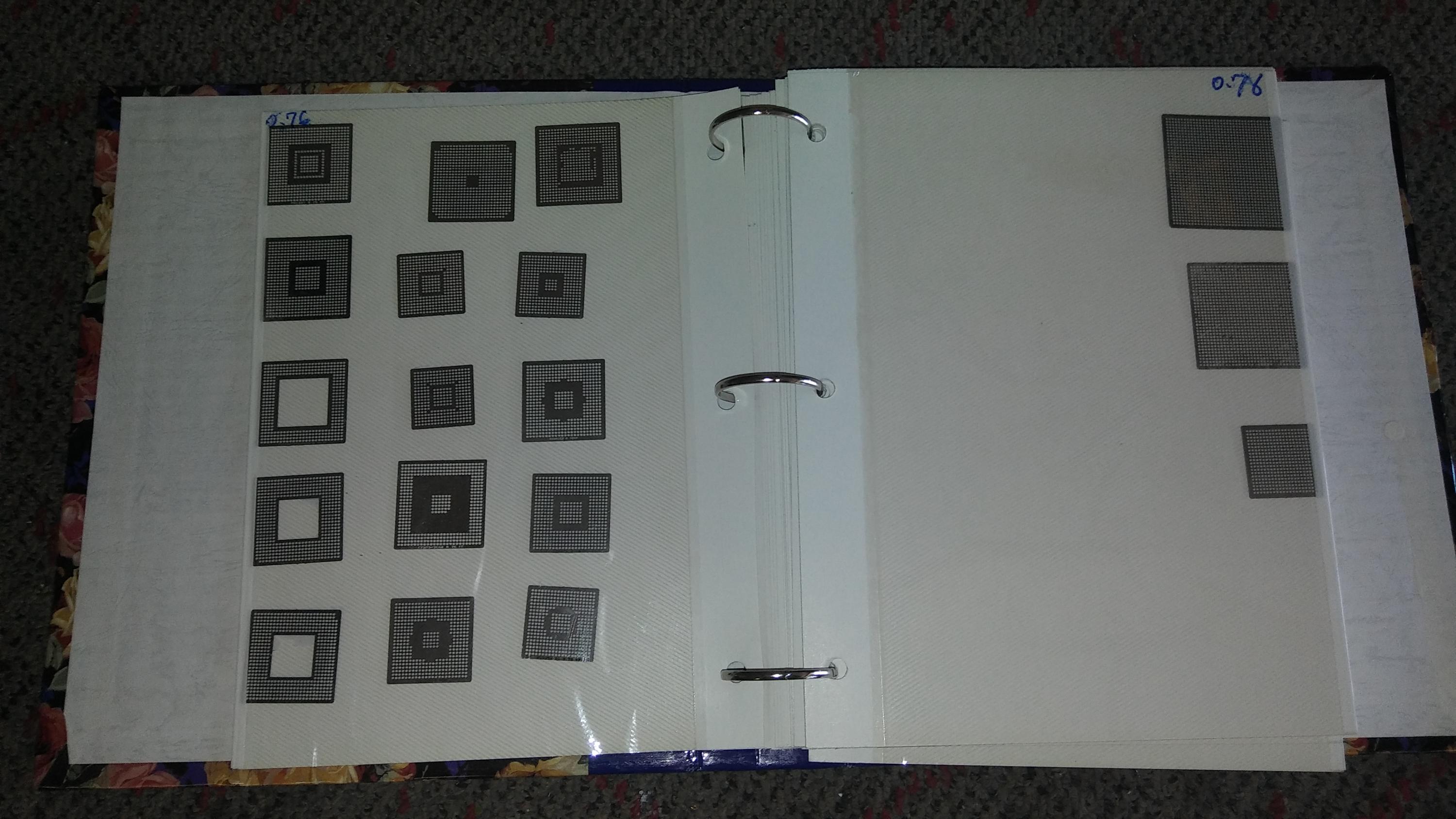

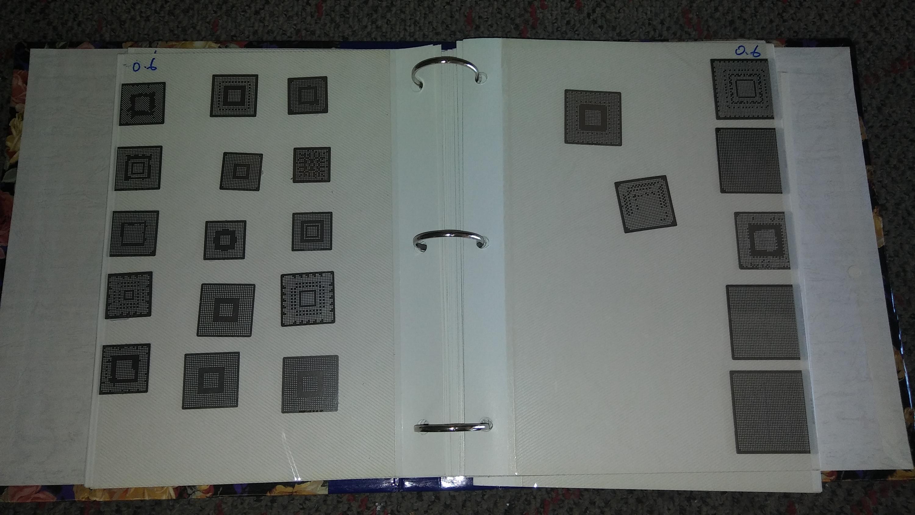

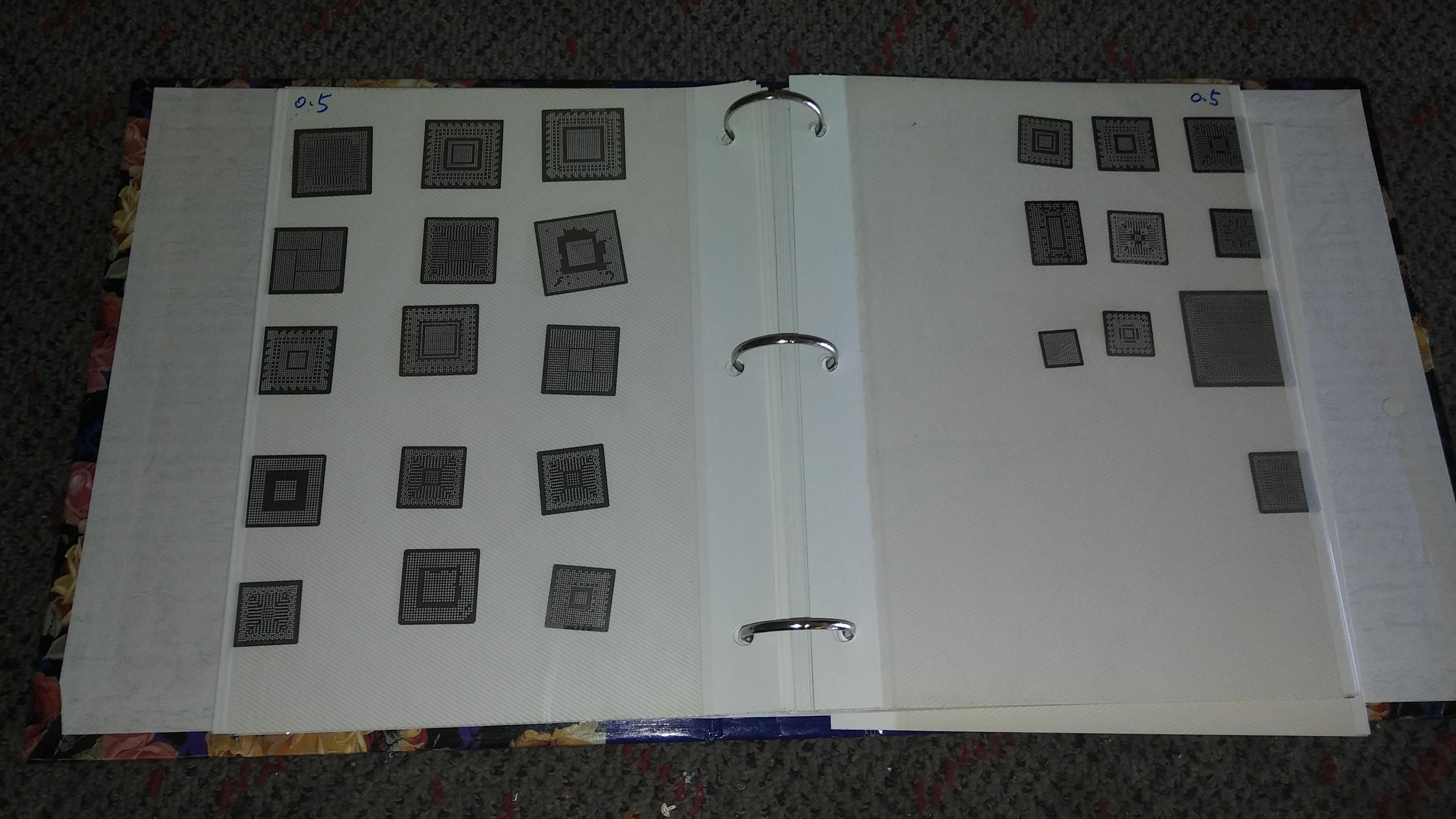

    Tech tips: aren't those photo albums beautiful?
      Re: One Thousand and One tech tips
      Originally posted by capwizard
      Tech tips: aren't that photo albums beautiful?
      Are they Anti-Static?
      • capwizard
        • Jun 2016
        • 1991
        No, but, those are BGA stainless steel templates, no BGA ICs are inside of it.

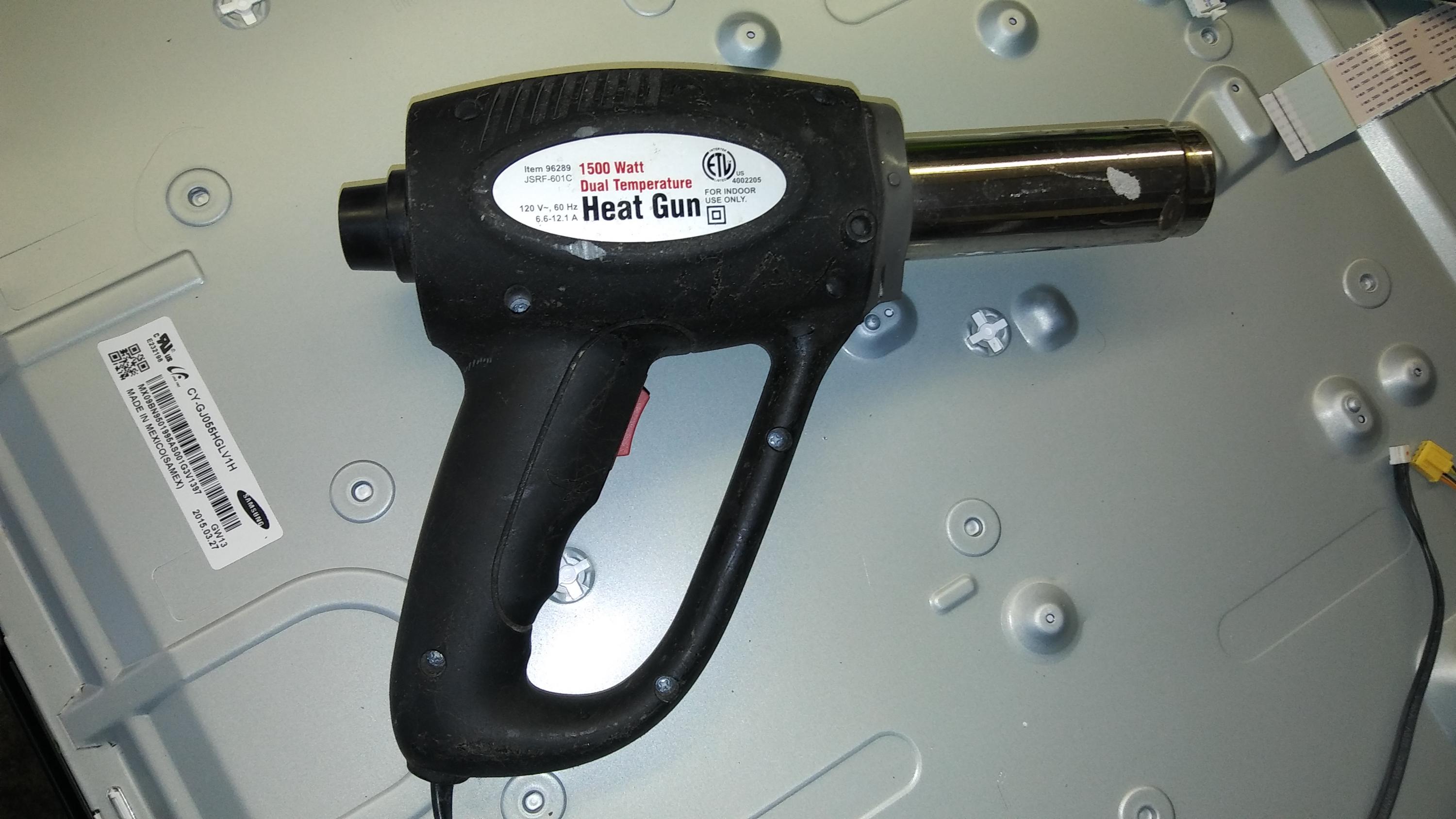

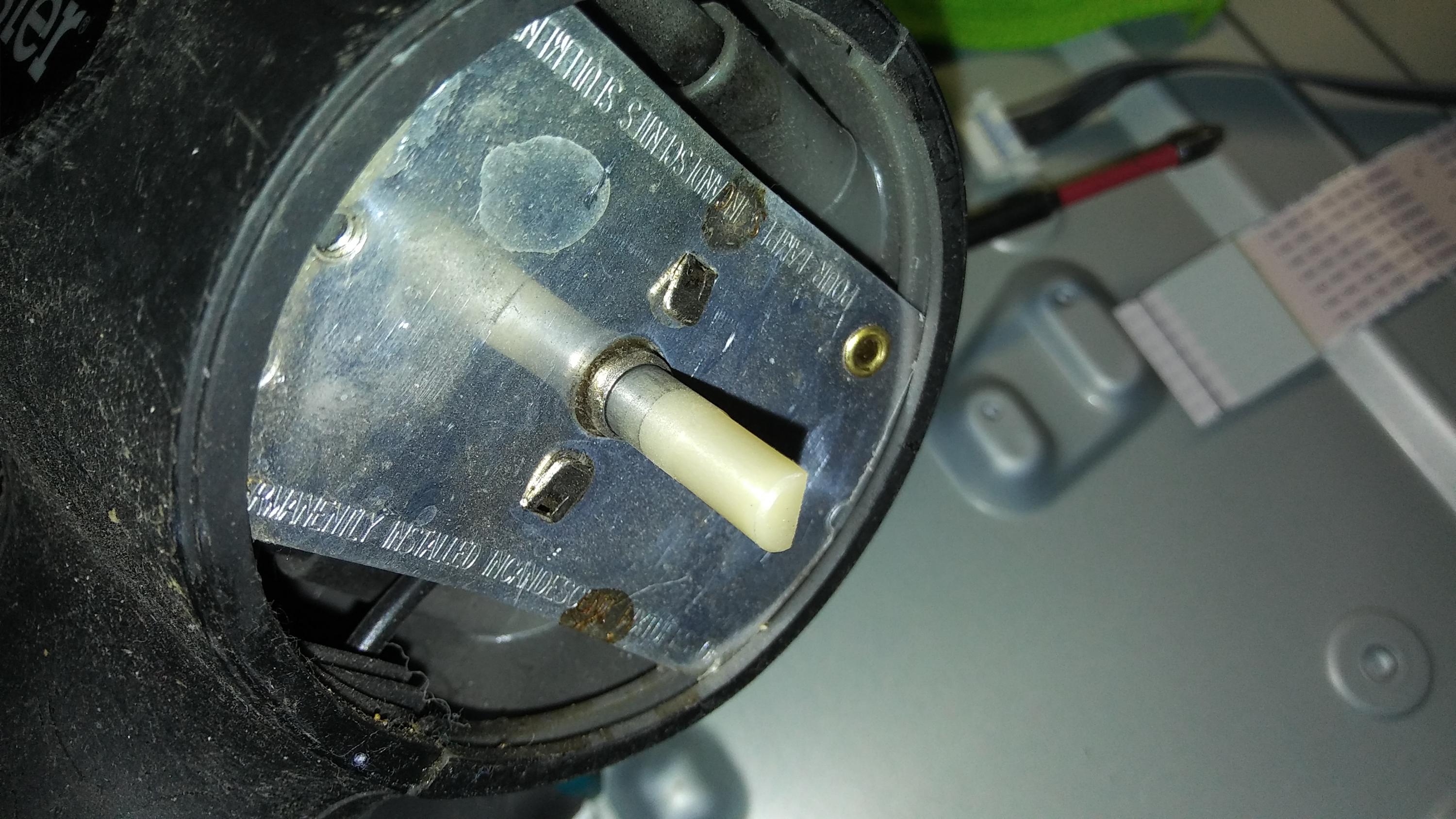

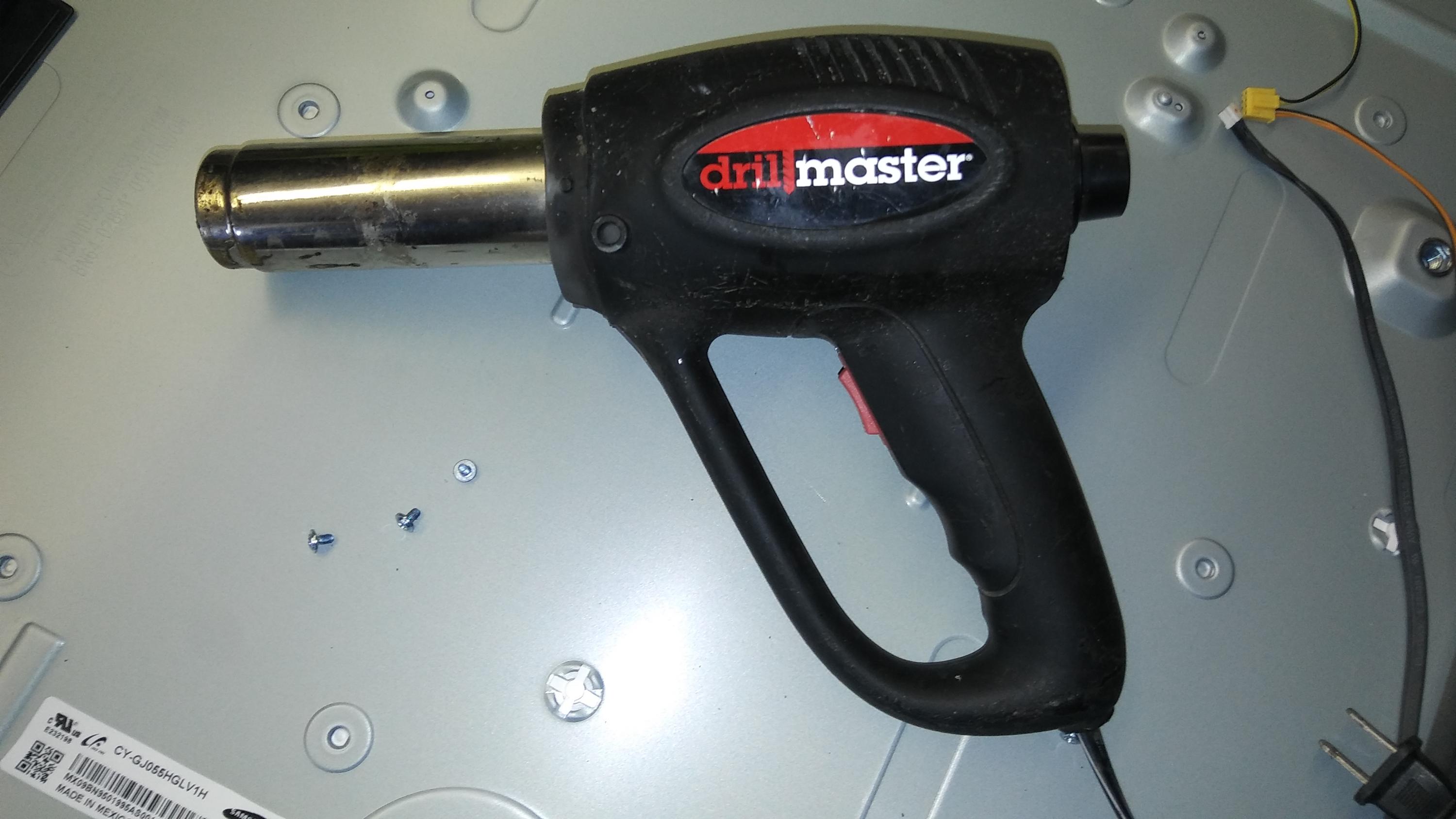

          Add a light dimmer change it to an adjustable heat gun.
