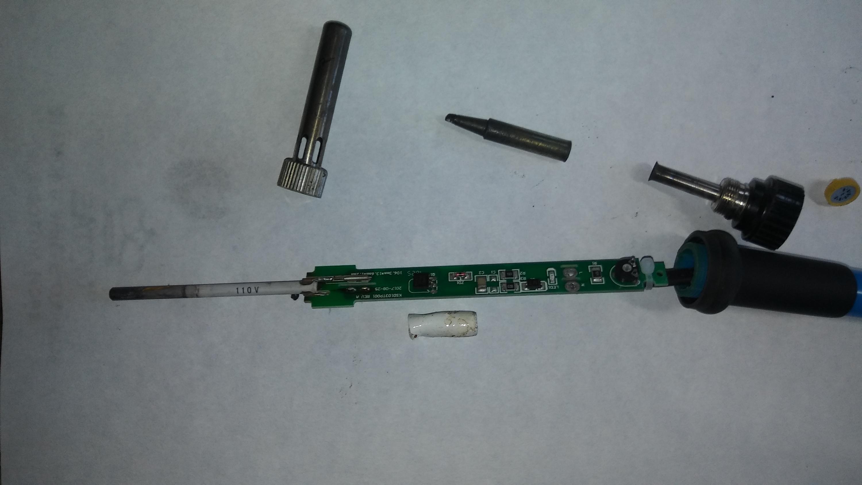

    The extrasensory perception solder iron.

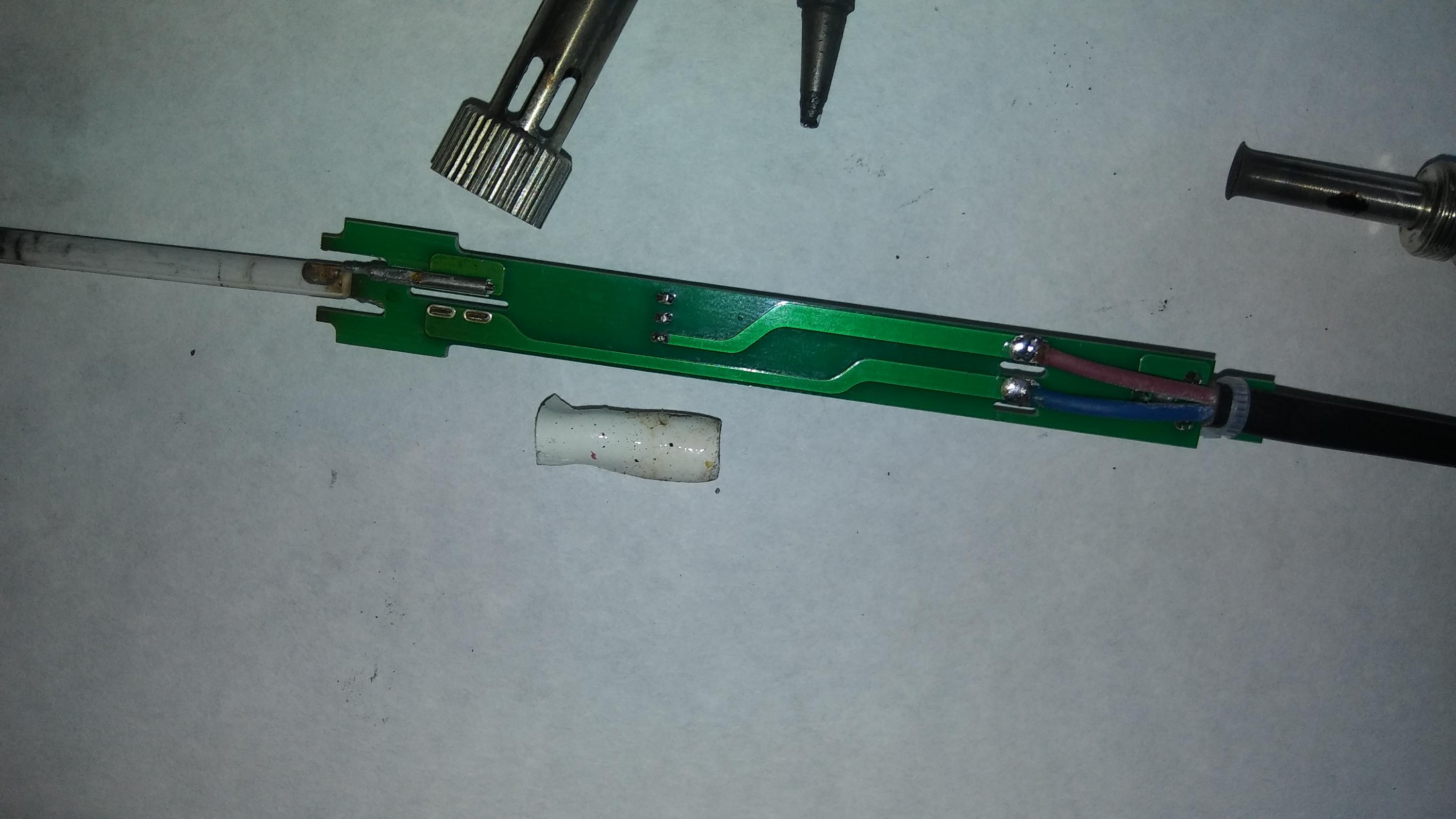

    How to modify normal temperature controlled solder iron to extrasensory perception solder iron.

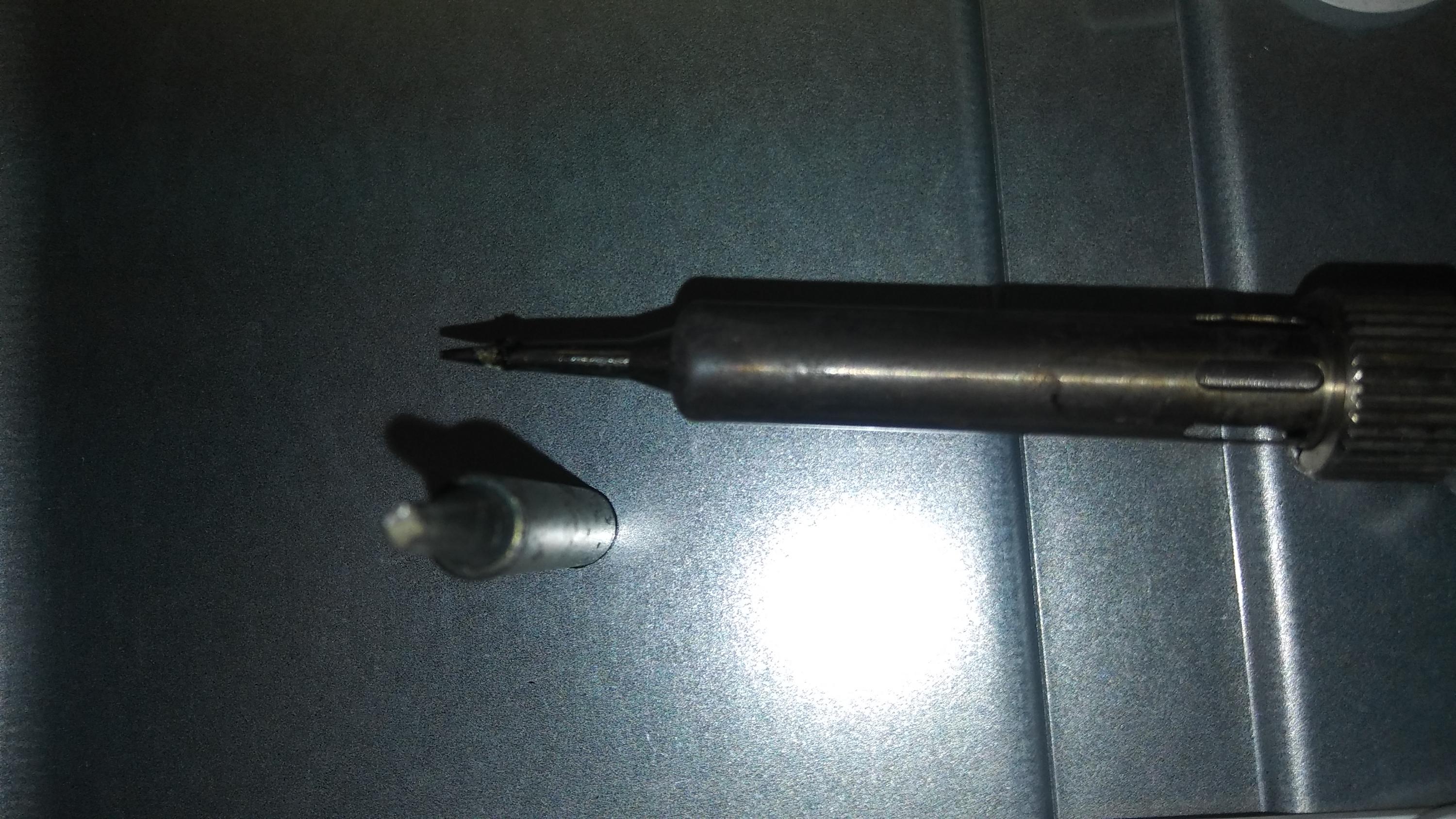

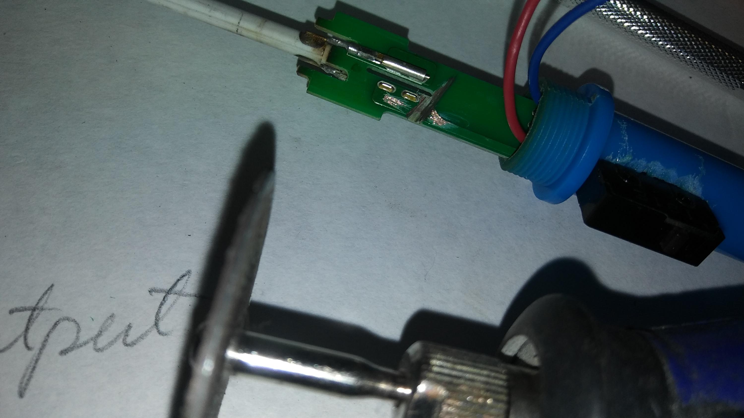

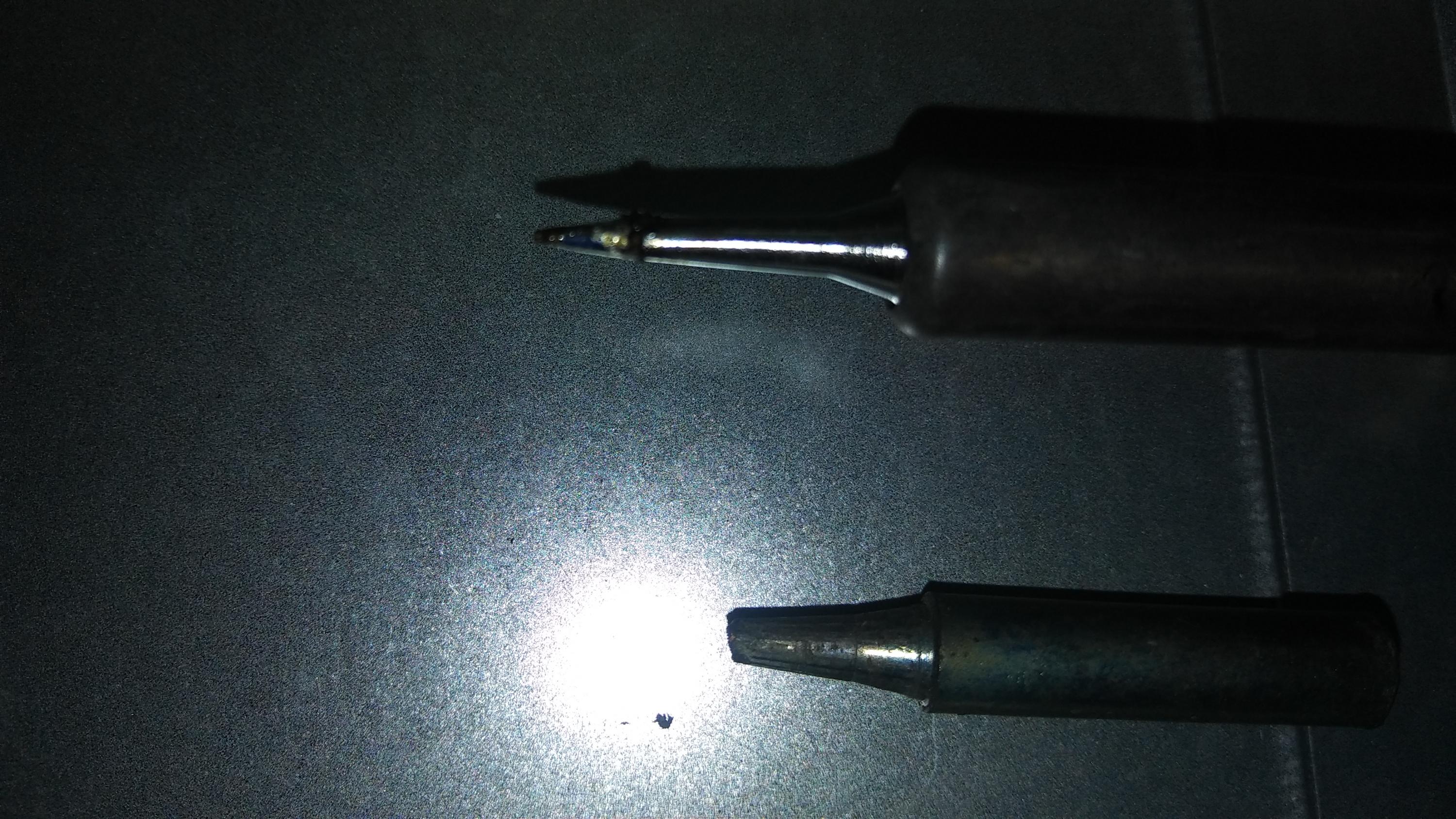

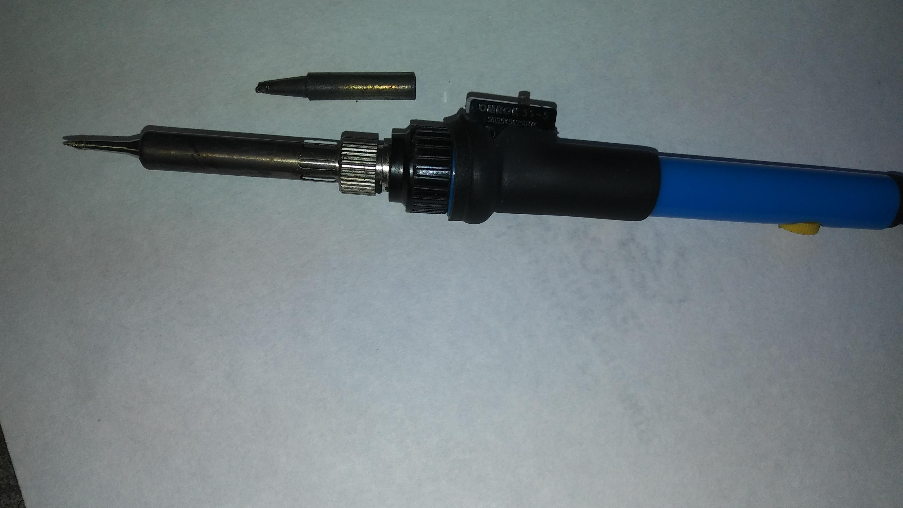

    1,2) The new soldering iron tip is oxidized after two or three days of usage. Opened it, so tiny Triac.
    3) cut the Trace, connect to a contact switch. Adjust the temperature control potentiometer to maximum power.
    4) here is the extrasensory perception solder iron. Close your eyes, you can feel your soul connect with your solder iron together and mind combination. With a touch of your fingertips, you control the whole world.

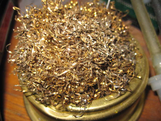

        your supposed to use BRASS wool - lol

            I'm kind of worried that there are some "imitation" brass wools out there, which are really plastic that has a metallic copper color on it... Sticking a hot iron in this stuff would not quite clean the solder iron tip...

                    Probably too stingy. Brass wool isn't necessary but it sure keeps things in good shape. I have one piece of brass wool and have yet to change it, though it probably is time. I'm too stingy to buy more
                    You can make your own brass wool, it's pretty much just copper shaving.
                    Taking a closer look at my brass wool, it's not as bad as I thought... I thought it would be too contaminated with solder, burnt flux, dross, and other crap to be used anymore.

                      anybody with a lathe can make the stuff, just give them a brass rod and let them cut it down.

                        I hate (Hakko) brass wool, I find it's hard on tips scratches the plating. Damp sponges have always worked fine. Not making a steam bath like some dumb people seem to enjoy.
                        If there is black slag on a tip, I use a piece of wood to scrape it off.

                            let's just say for example the soldering iron I post over #1 is very small and lightweight, 110v, so I like it.
                            1,2) Problem is the temperature control not even use Bang Bang worse than that it uses Triac to control the temperature. that's why every 2-3 day I need to change another solder iron tip.

                              let's just say for example the soldering iron I post over #1 is very small and lightweight, AC 110v, so I like it.
                              1) Problem is the temperature control not even use Bang Bang worse than that it uses Triac to control the temperature. that's why every 2-3 day I need to change another solder iron tip.
                              2) Another one is the soldering iron tip after I modified, tip no needs to clean. The main difference is one is always on, the other one is always off.

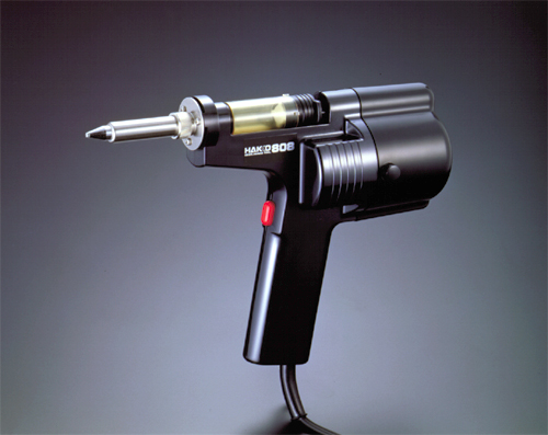

                                        I used to have this resistant Soderling iron from RadioShack after I used and opened it to see what's inside then I threw it in my junk piles.
                                        The best soldering tools I ever used which I have had more than 10 of them is this: Hakko 808 Desoldering Tool. I know it is a desoldering tool but I used as soldering Iron. Hakko 808 only has one problem is very hard to clean. In this rapidly changing electronic world (SMD), it is no longer useful than a hot air gun.
