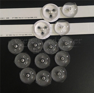

    optical convex lens?
    HI have a question, what those TV backlight LED lens (optical convex lens? ) are called. If they fall, how can we glue it back? Hot glue gun or super glue?

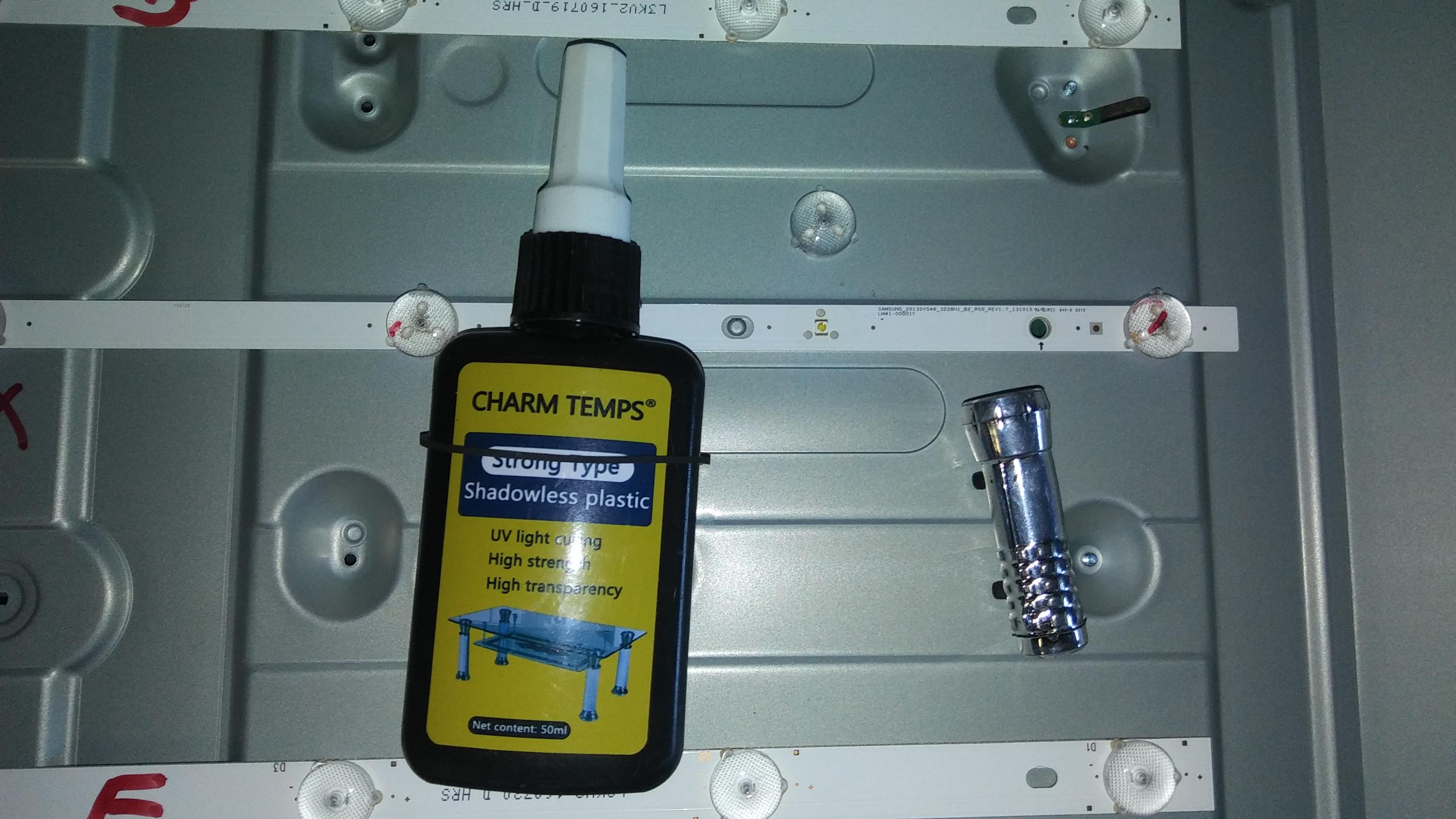

            Can I use 10 seconds UV glue for promptness?
              • 31277
              Re: optical convex lens?
              you can try.
              but first, harden some on a bit of tape or card, then bend it
              if it cracks it wont work, if it bends then it might.
              it also has to be heat-proof.

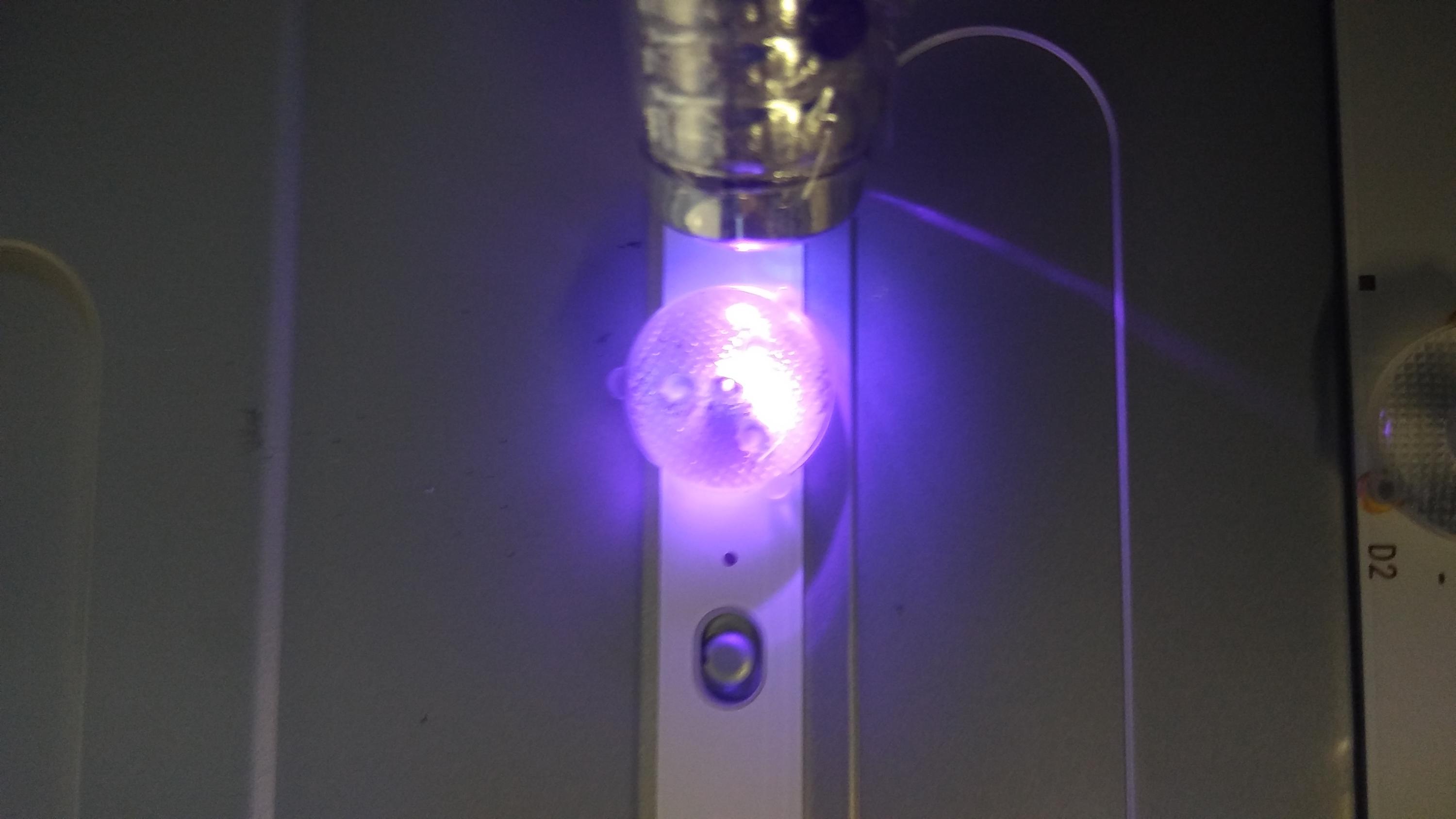

                      A....three crops of UV glue.
                      B....UV light for 10 seconds.
                      C....it is ready.
