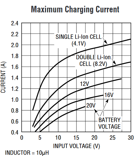

    Hi, will 10uH be enough to charge a 12.6V battery at 1.5A from a 5V input?

      You are trying to charge 12V battery from 5V source, so look here: It may not fir your requirement, but it is a starting point.
      http://www.linear.com/product/LT1512
      LT1512 - SEPIC Constant-Current/Constant-Voltage Battery Charger
      Features
      Charger Input Voltage May Be Higher, Equal to or
      Lower Than Battery Voltage
      Charges Any Number of Cells Up to 30V*
      1% Voltage Accuracy for Rechargeable Lithium Batteries
      500kHz Switching Frequency Minimizes Inductor Size
      100mV Current Sense Voltage for High Efficiency
      Battery Can Be Directly Grounded
      Charging Current Easily Programmable or Shut Down

        OP is asking for 20W output and 5V input, datasheet says impossible.
        It can't handle 5V 4A input
          Re: Inductor value for LT1513?
          It is just the guide to look for the one that will fit his requirement. He needs to know that he needs to boost the input Voltage from 5V to 12.6V (which I am sure what kind of batteries he is trying to charge) so the 1513 is not the right one for sure.
          Just look through the LT website and see.
