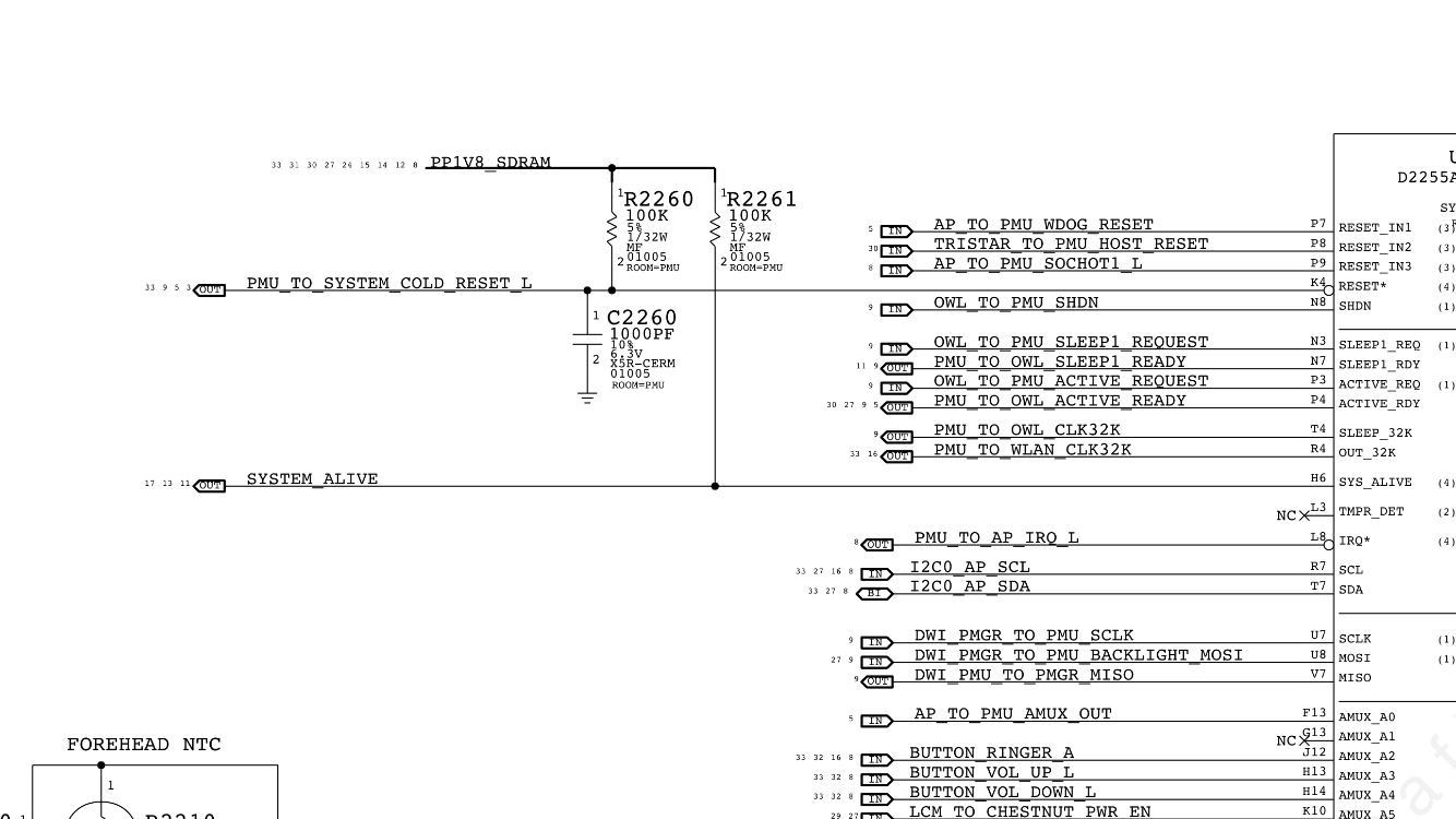

                              Is there a way to know via a schematic if a resistor is blatantly being used as a pull-up/down?
                              For example the schematic attached, are r2260 and r2261 providing 1.8v to the reset and system alive lines, or is 1.8v being sent from those lines to the resistors? This confuses me at times

                                Re: Pull-up resistor question / data lines
                                They are pull-up resistors.
                                You can also look up the spec sheet of that IC to see what the requirement are.
                                  No spec sheet it's an ic from an iPhone. Impossible to find spec sheets for their components.
                                  So if they're pull-ups that means those reset/system alive lines would always be pulled to 1.8v unless some other circuit pulls them low?
                                    Those pins are connected to other circuits which you should find so you can see how they function.
                                    The example above as you can see, the 'reset' has line on top of the word reset, which mean it will go into reset when that pin goes low, normal operation the pin will be high.
                                    Your IC 'RESET' pin is active high, so high = reset, so in normal operation that line should be low, but it has * after the RESET so you need to find out what the * is for.
                                      Just took some measurements, there was 0v when the phone was off and 1.8v when it was on.
                                      So looks like it's in reset mode when that line goes low. That's why schematic is confusing it appears to be the opposite like you said
                                        01005 resistors are smaller than a pepper spec. You got guts measuring this!
                                        Notice your schematic net labels tell if a signal is an input or output or bi-directional.
                                        The body outline has an arrow: <- OUT, -> IN, <> BI for bidirectional lines. Bubble symbol means, example on RESET and IRQ, pulled low to assert.
                                        A MCU input can have a pullup or pulldown resistor or nothing- this is assigned in firmware.
                                        Pullup resistors are used on open-drain (driven) signals like RESET or IRQ because several IC's can activate (pull low) the line. It is a "wired-OR" setup. This IC or that IC can pull RESET low, for example.
                                        A MCU output can be push-pull or open-drain.
                                        For that iPhone, I think those are open-drain MCU signals (RESET and IRQ), so they need pullup resistors to +1V8.
                                        They should stay high unless pulled low by anybody connected to cause RESET. BUT during off/sleep I think the +1V8 is switched off so it is confusing.
