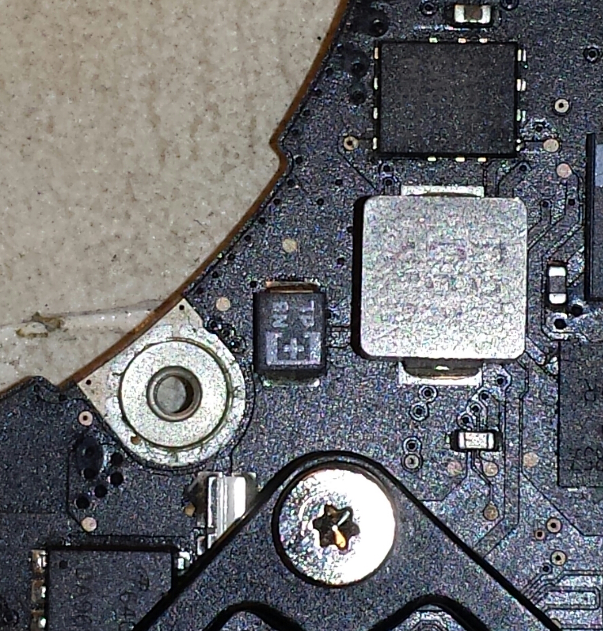

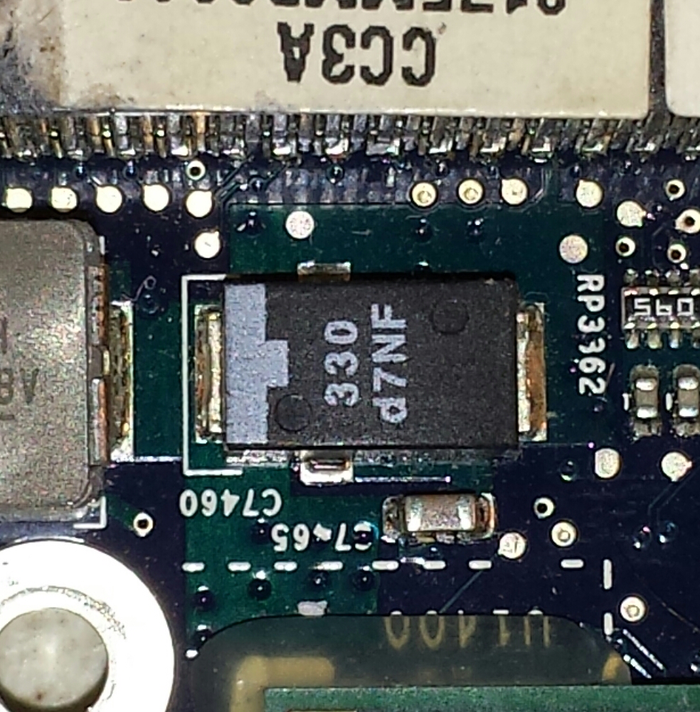

    That being said I am now faced with something I have very little knowledge of which is SMD cap value.
    I have a Macbook Pro 2010 with the video crash problem which is caused by an under-performing SMD cap (I'll attach a photo of it) that is repaired by replacing it with a 330 microfarad 2 volt non-tantalum poly-film cap.
    Here is my problem, I only had a couple of them on hand and am now in need of a couple more.
    They are on back order from Mouser or cost prohibitive (shipping mostly) at this time from other suppliers that are out of the US.
    I simply don't know enough (which means I don't know squat) about cap's to figure out what I could use instead.
    It was suggested by another to simply pull one off of a dead board but again, I have no clue as to what to look for.
    The mod does require increasing the mounting area so a larger size isn't a problem.
    So in short, can someone help guide me in the direction of an alternative cap?
    I have found some 330 caps on an old scrap board but simply don't know if they would work.

    They may not be 330 uF , on some surface mount capacitors the last digit is the number of zeroes. So 330 could mean 33 x 10^0 = 33x1 = 33 uF
    Those are polymer capacitors, not tantalum (which are usually dark yellow / brownish) ... tantalum capacitors would have too high esr.
    It would be best to use a multimeter with capacitance measurement to measure them... or built a RC circuit and measure capacitance by how fast the voltage rises.
    See https://youtu.be/VylC8JFoiBo?t=613 you can replace the oscilloscope with a multimeter and a clock timer

      I love Digi-Key, gave them a call and they came up with a substitute in seconds.
      Got 4 of them on the way.
