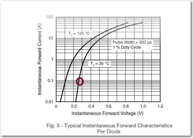

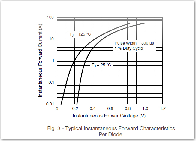

                                    compare with this chart ....
                                    • bianchi77
                                      • Jun 2016
                                      • 1121
                                      Re: SB240 diode test ?
                                      with DMM diode test on 90mA Vf must be inside the red circle, correct me if I'm wrong
                                        https://cdn.badcaps-static.com/pdfs/...de6c30ae15.pdf
                                        https://cdn.badcaps-static.com/pdfs/...2f0cb7ec39.pdf
                                        Not all brand will have same exact Vf.
                                        So just try it and see what you get.
