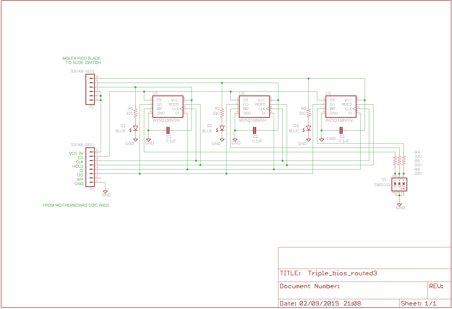

thats it stj albeit quite a messy schem, first time using eagle had to spend sometime getting to grips with it. does it need modifying?
