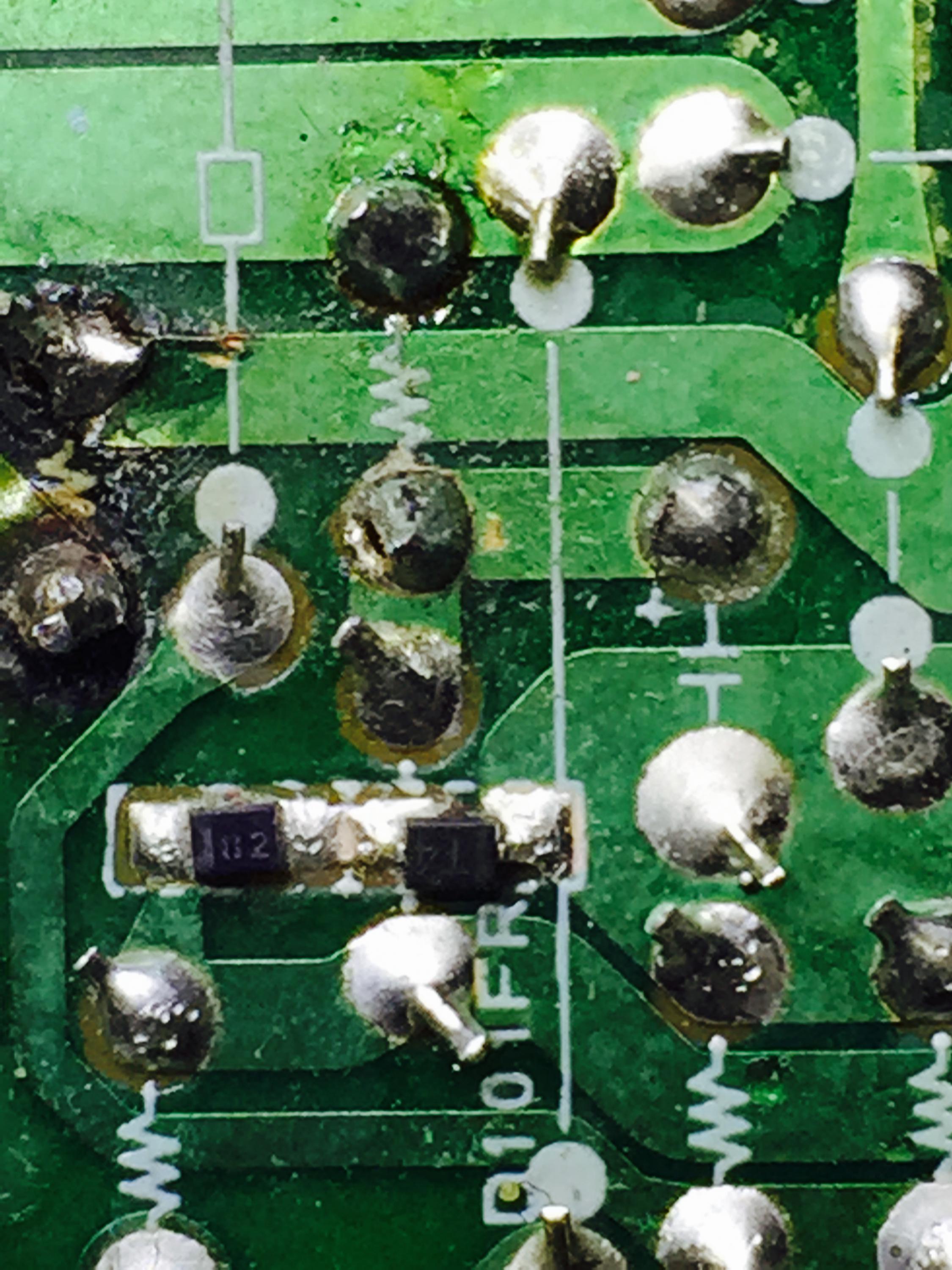

I am repairing a Denon receiver and found 2 shorted diodes. one is a zener and the other is unknown. I took a picture and the markings are T4 and what appears to be B2 or 82 or 8Z. Can anyone identify these parts and know the part number. thanks
HELP identifying parts
Re: HELP identifying parts
Hi
Tech2014 that part T4 is a Silicon Epitaxial Planar Diode.
https://cdn.badcaps-static.com/pdfs/...6534b2f8a8.pdf
