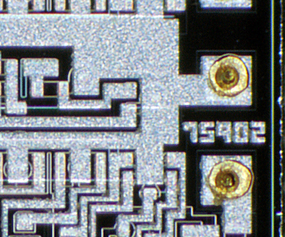

            I managed to find a die shot of LMT324 which is the quad version of the LMT358 (which is a dual op amp).
            The link to the die shot is below. On the linked page click on the die image for a higher resolution image.
            https://www.siliconpr0n.org/archive/...ola:lmt324dopt
            This is on the siliconpr0n site which is a great site for IC die shots and has a number of contributors including Antoine Bercovici who took this shot.
            Antoine also has an X page with more die shots.
            https://x.com/siliconinsid
            On perusing this die shot I noticed the marking "75902" on the righthand side of the die. There's also a "1" on the bottom which confirms to me that the "75902" marking is the right way up.
Name:	LMT324 - Motorola - Bercovici mz - 75902.png
            Normally on dies you get the IC device code plus occasionally the revision id directly after. Sometimes they just give the IC device number. Other markings can include the manufacturer, the mask code, copyright symbols, and pad alignment marks ("1" in this case).
            Antonie provides some Motorola and OnSemi LM324 shots as follows.
            https://www.siliconpr0n.org/archive/...ola:lm324adopt Marking "LM124N".
            https://siliconpr0n.org/archive/doku...onal:lm324nopt Marking "LM124".
            Note LM124 is the base code for the die used in LM124, LM224, and LM324 parts. "N" in the first link is the revision.
            Obviously "75902" is not "LM124". Neither is it LM75902 or MC75902 (MC is a common Motorola prefix).
            On a bit of searching I found two parts that match: Toshiba TA75902 and Korea Electronics Co (KEC) KIA75902.
            Korea Electronics Co was originally a subsidiary of Toshiba so this is the same part.
            The link to the Toshiba datasheet is below.
            https://www.alldatasheet.com/datashe.../TA75902P.html
            On comparing this datasheet I found that the simplified schematic basically matches the Motorola LM324 schematic and the parameters seem to be the same except the temperature range matches the automotive version of the LM324 which is the LM2902.
            Furthermore National Semiconductor in their "1988 National Linear Databook: Volume 1" linked below includes a cross reference from the TA25902 to the LM2902.
            https://archive.org/details/bitsaver.../2up?q=TA75902
            So it seems that the Motorola LMT324 in the die shot and the Toshiba TA25902 IC are the same IC.
            While some may be inclined to think that the LMT324 shown in the die shot is a counterfeit, Toshiba and Motorola (and OnSemi) have a long collaboration including co-owning semiconductor fabs in the past (and also presently).
            At the time this IC was produced Toshiba and Motorola didn't co-own a fab but were collaborating on other things.
            My inclination is that Motorola decided in 1993 to upgrade the LM324 to the ESR version and for customers wanting a non ESR version they used the Toshiba TA25902 marked as LMT324.
            So it seems "T" based on this case and probably the other ICs (not checked) is "T" for "Toshiba".
