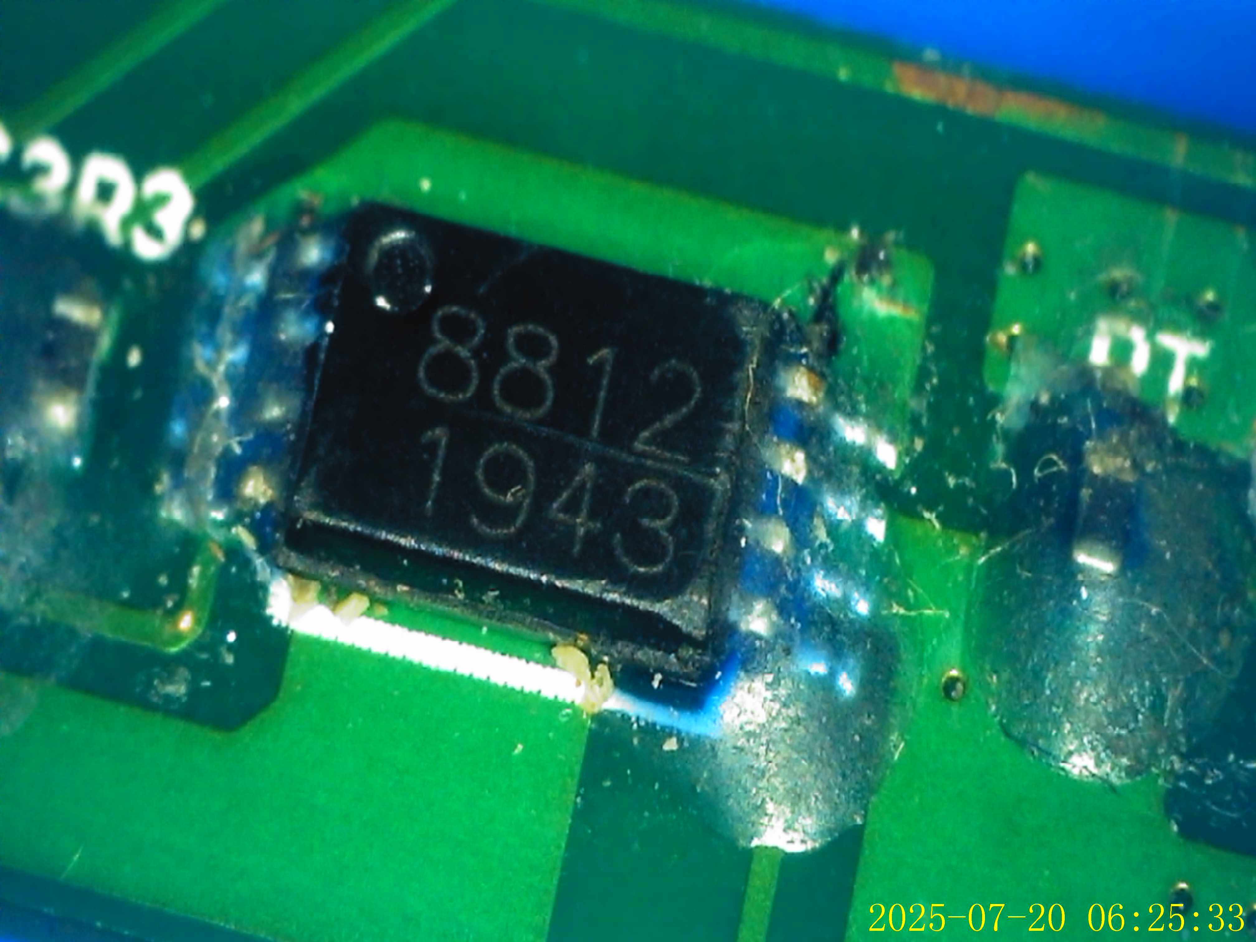

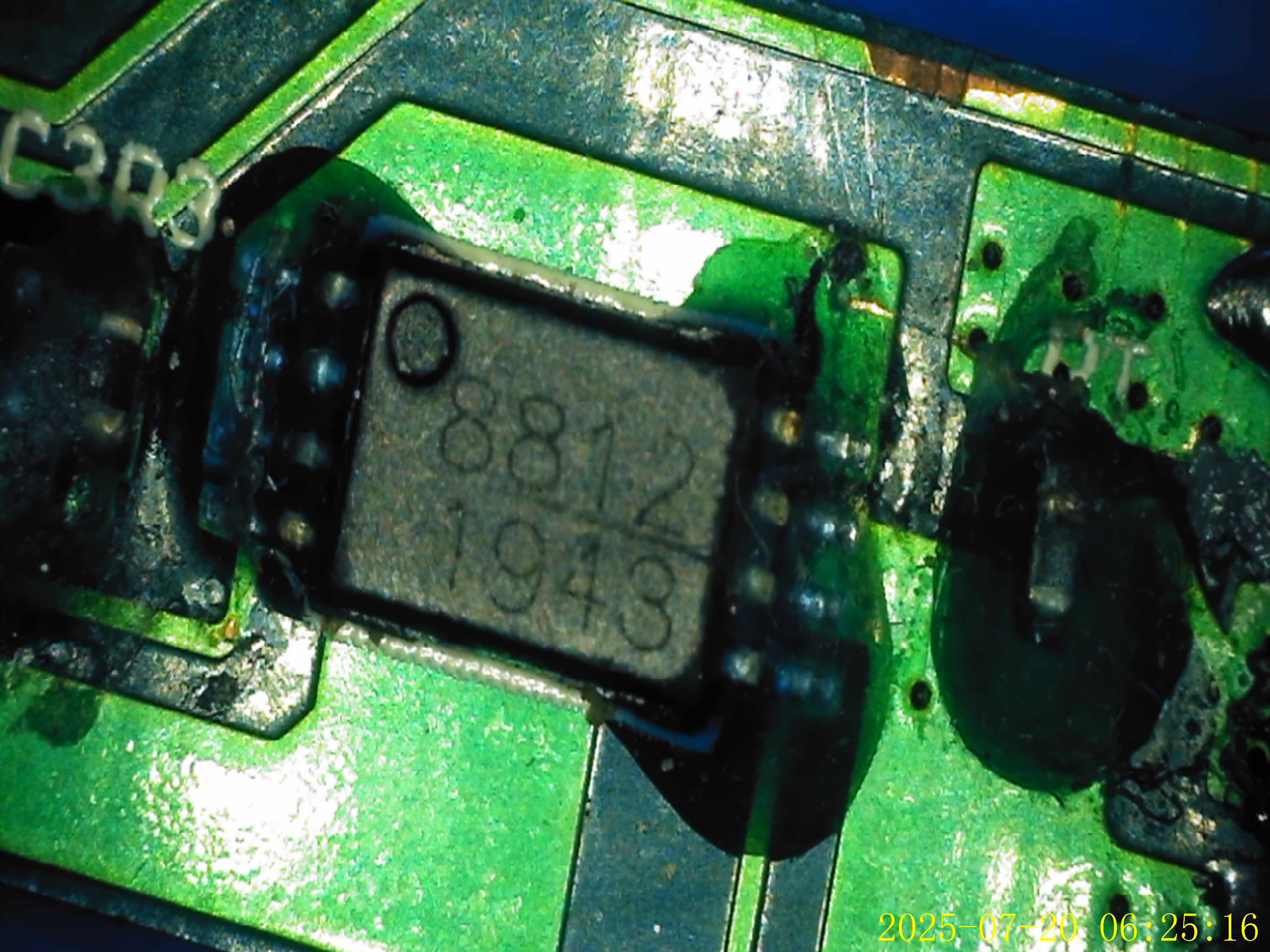

    Hello, I'd like to know what type of reference this chip has. They're similar to the BIOS on TVs' T-con boards. It comes with vacuum pump batteries.

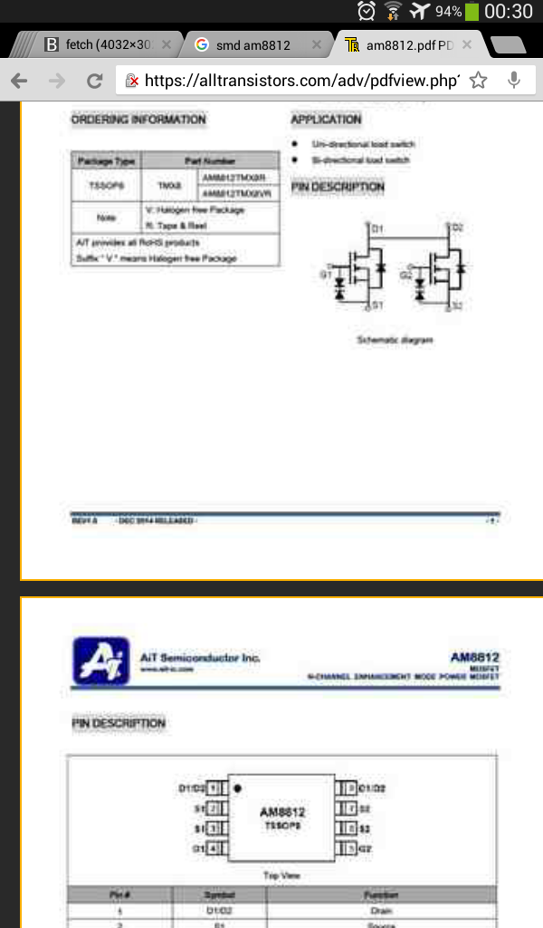

    It look like dual mosfet, maybe am8812 or simmilar Gate is 4 and 5, drain is 1 and 8
