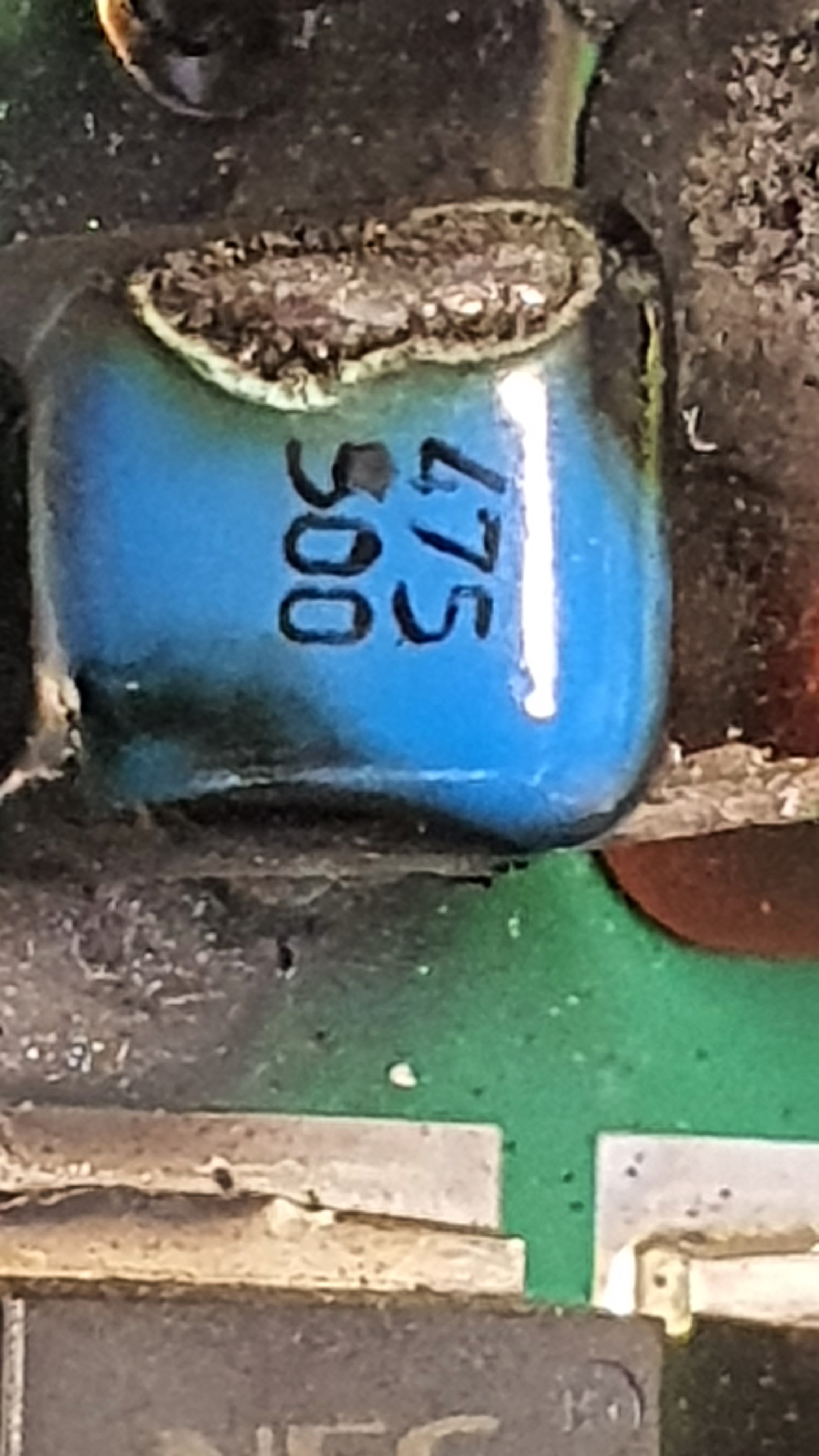

MLCC THT identification
  • Slydder
    • May 2017
    • 45
    body width is about 7mm. any help greatly appreciated.
  • lotas
    • Jan 2016
    • 4803
    • Russia
    4u7 500v
    https://www.aliexpress.com/i/3256805...apt=4itemAdapt
    • Slydder
      • May 2017
      • 45
      that's what I was afraid of. I cannot find anywhere to get a replacement due to the body size of the thing
