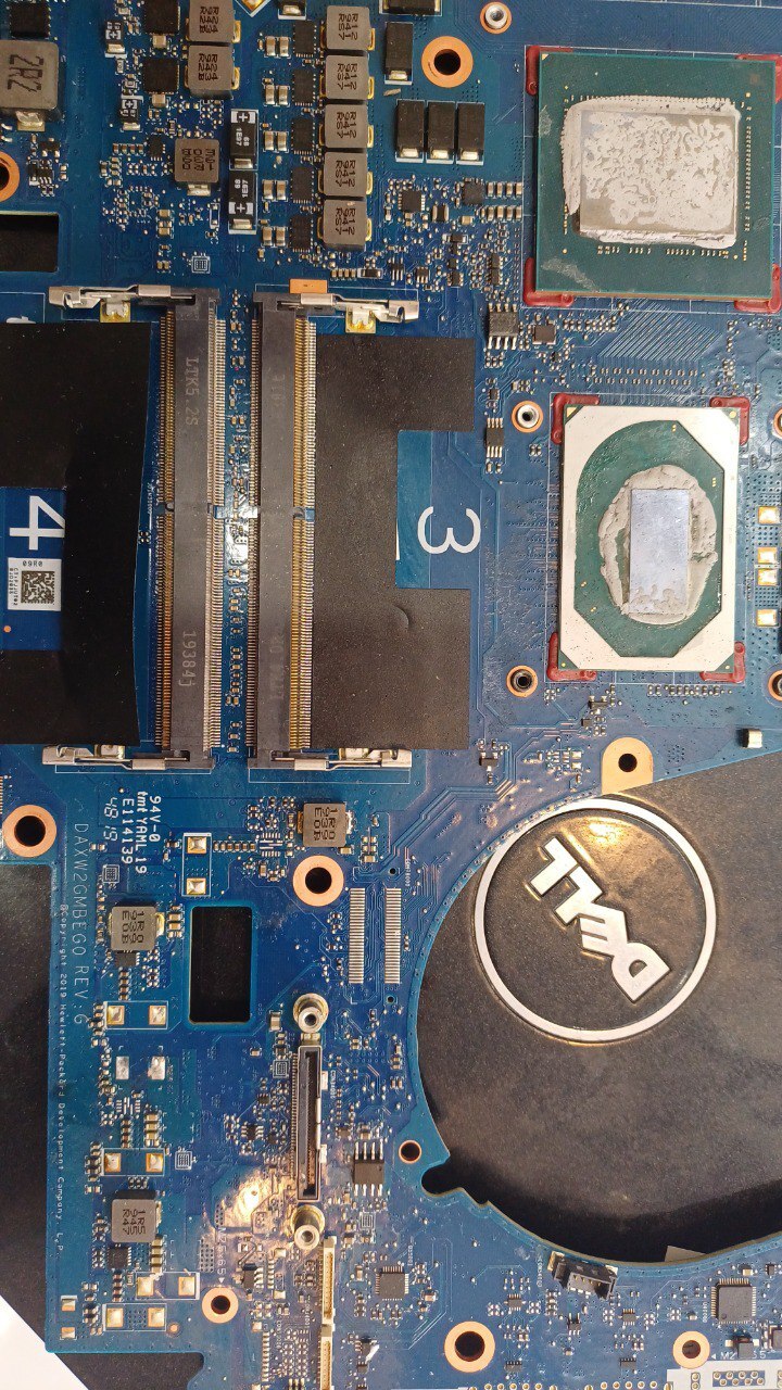

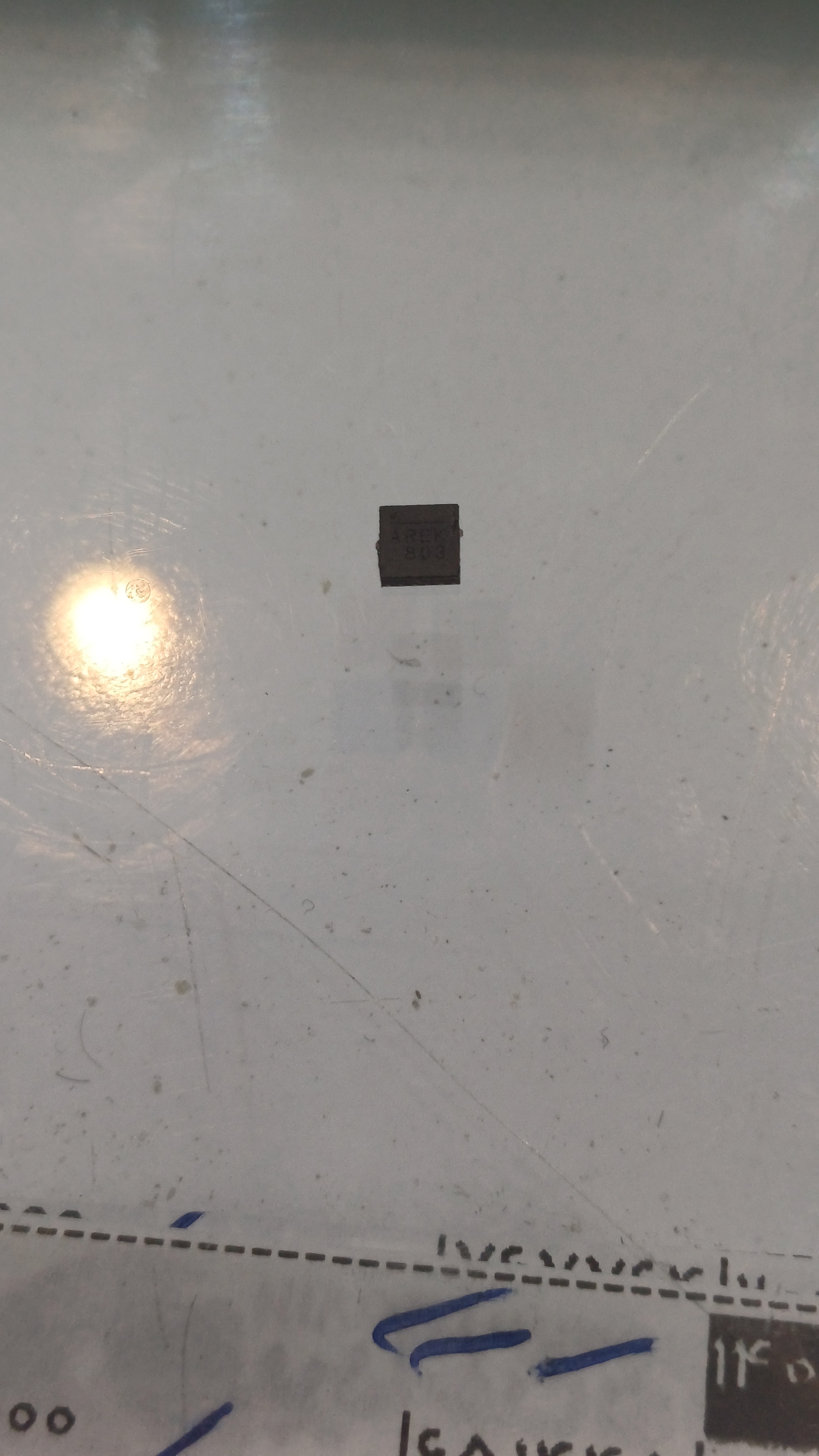

    hello
    What IC should I replace the 2 ICs with the following codes?
    AREK 803, PBK904​
    • 21936
    Pictures of the IC`s would be useful. Give more info, what motherboard are these on, whereabouts in the circuit are these IC`s

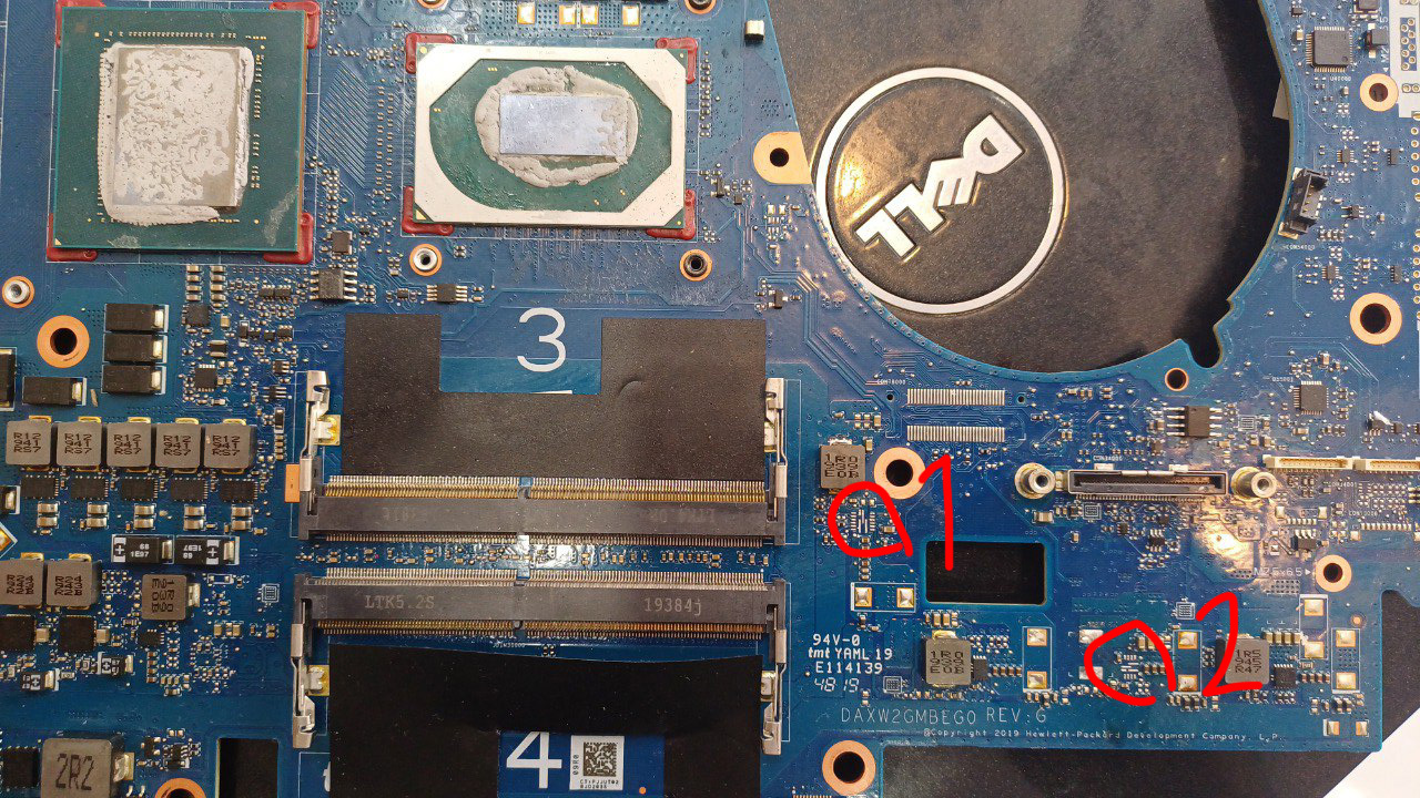

        hello
        HP ZBOOK 15 G6 laptop
        Board model:
        DAXW2GMBEG0 REV G
        I specified the location of the ICs in the picture.
        The exact number of IC 1:
        APRK 803
        IC number 2: It is not well known, but it seems to be one of the following 2 numbers:
        PBK904
        APBK904​
        • truclacicr
          • Apr 2019
          • 352
          • australia
          APBy+xxx = NB680A
          https://www.monolithicpower.com/en/d...en/sku/NB680A/
          I expect that APRy+xxx is also a Monolithic Power part, but I haven't been able to find it.
