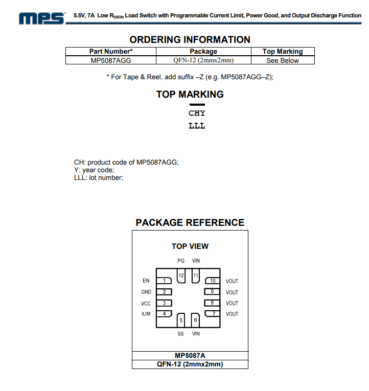

    Help me identify this component Kingston SNV2S 500Gb NVME drive
    The drive is dead. I was able to identify the culprit and it's this chip marked "CHN 031". I am unable to find it.
    Can someone tell me what this chip is? Thanks.

    Its a Monolithic Power IC , but don`t know what the part number is yet https://www.badcaps.net/forum/troubl...20#post1482820
    How many pins does it have. Can you measure it

      Similar to product code CHx xxx - MP5087A

        The chip appears to have 12 pins: 4+2+4+2
        I am assuming it's QFN-12

          You can bypass this IC by connecting Vin to Vout. Just be sure that there aren't any shorts downstream. Also, make sure that the input voltage is correct.

            • mon2
              • Dec 2019
              • 14691
ID:	3450678 Yes, it looks like a match.
              monolithicpower.com/en/documentview/productdocument/index/version/2/document_type/Datasheet/lang/EN/sku/MP5087A/document_id/1813/
