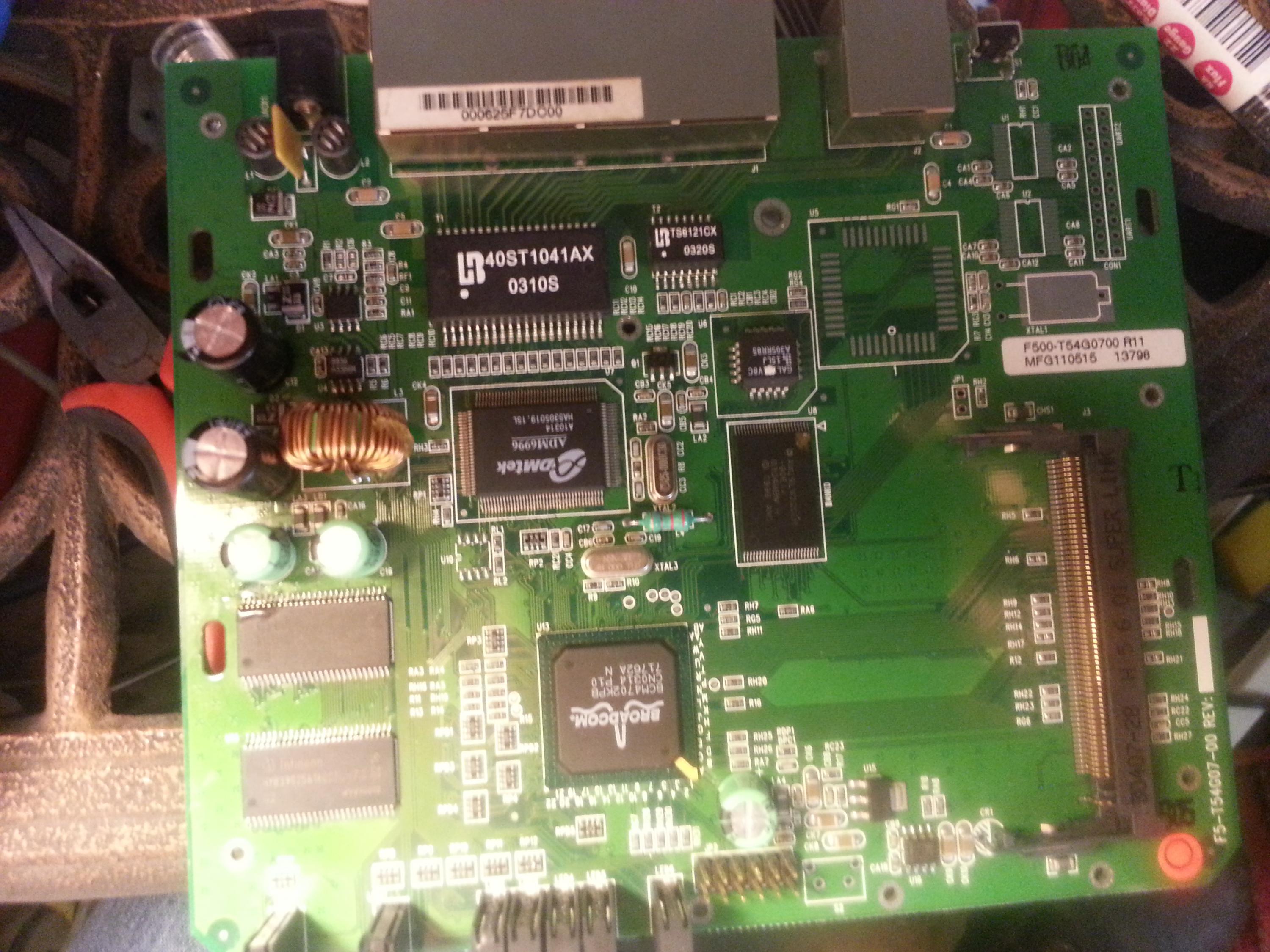

    hi.
    I have a router that died some years ago. Recently, I replaced all the caps, some were obviously bulged. I also upgraded the ram chips.
    When I plug it in, I get nothing. No power light, no leds. A quick once over on the board shows that the rt9202 is hot to the touch. Its a pwm buck voltage controller.
    So, how do I start here? Is a hot voltage controller indicative of a short somewhere else?
    I'm also considering pulling the ram chips off and check if I see the same symptoms.
    Thanks!

    Re: router troubleshooting
    Very likely. Check your work on the capacitors, there may be solder bridges, make sure the capacitors are not backwards. The short may even be inside the IC itself.
    Probably easier to look around the DC-DC converter first.
    Photos would be good
    -David VanHorn
      Hot chip is closest to the power jack.
      How would you chase down a short? Remove components until the chip stops heating? Would that work for memory chips? Capacitors?
        Start with basic components, diodes and transistors then check for possible shorts from caps and resistors and so on, then work up to logic and gate components.
          That RT9202 drives the dual 9936 MOSFET right next to it. I would check it is not shorted first
          Also check the RT9202 is not shorted from supply to ground etc.

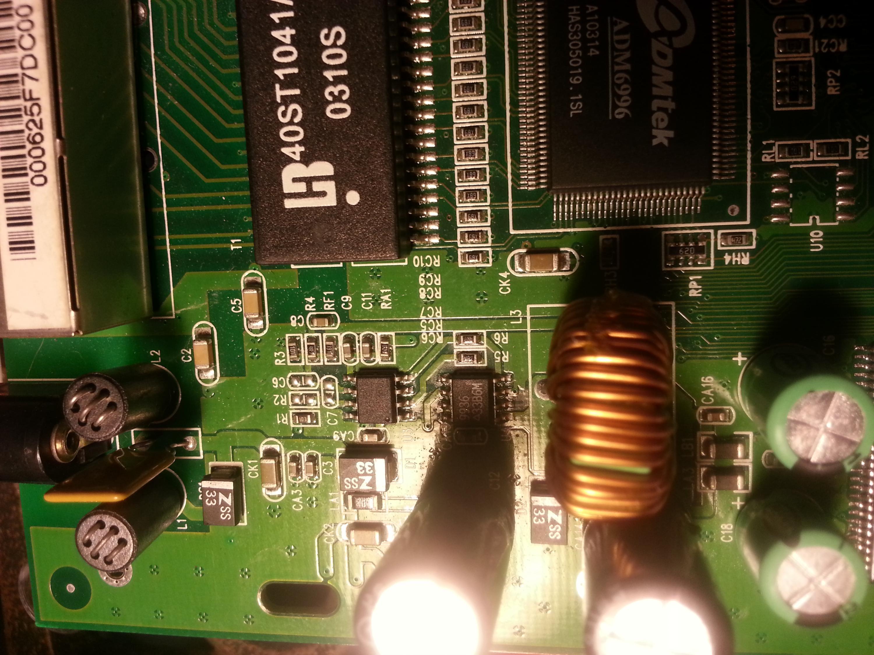

            On the rt9202 I get a connection to ground on Ground, ugate and phase.
            On the 9936, i get a connection to ground on s1, g1, s2, and both d2 pins. That assumes the triangle on the chip marks pin1.
            Would that indicate a problem with the mosfet? I wasn't expecting to see a connection to ground on the drain. Or g1 for that matter.
              It could be a problem, best to remove the MOSFET and check it out of circuit for sure.

                                So, I have a possible lead here. I have been going back to basics as I have never had any formal electronics training, and I have also been centering my troubleshooting back on the rt9202 chip.
                                Vcc, by the spec sheet, expects 5v. On the circuit board, to the right of RA1 (the side with the printing) I see 5v. To the left of RA1, I see 1.5v. I don't see a voltage divider here. I'm at a loss as to what would cause a voltage drop like that.
                                If resistors burn, would this be expected? Would a shorted ceramic capacitor pull the voltage low like that?
                                      Going to pull the rt9202 and possibly the resistor and some smt caps off the board and see what I can learn. Hopefully I can chase down why I'm not getting 5v to vcc.
                                      Either RA1 is has gone high value or a decoupling capacitor or the RT9202 itself is shorted.
                                      Since the RT9202 is what gets hot, it is most likely the problem. I suppose it's *possible* that the decoupling capacitor(s) could go open circuit and cause the controller to become unstable and overheat, but more likely it's shorted.
                                        I pulled the rt9202 off and tested the board without the mosfet or the rt9202. Now I get 5v on both sides of RA1. The rt9202 is toast.
                                        Seems I can actually source some of these, going to end up coming from china though.
                                        Thanks guys!
