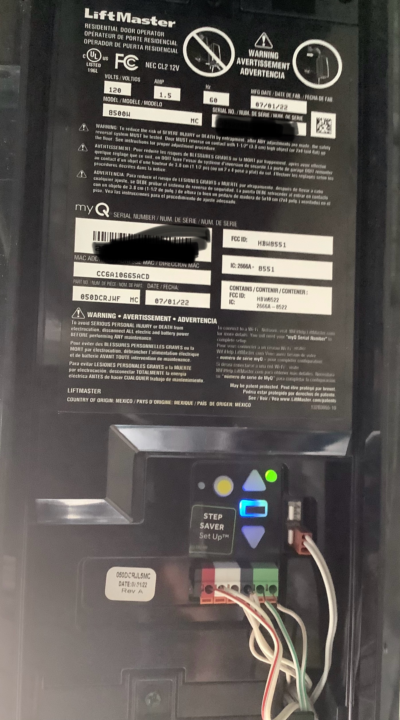

Lift Master Garage Door wall switch display / motion sensor controller display disappeared no back light
    • Jul 2011
    • 6031
    Originally posted by redwire
    We don't know the model number to check the instructions, I can see a need to cold reboot the whole thing. Again, some units had a recall over safety with their bad firmware.
    Here is the data plate with the serial number and MAC address black out
    So far it has stayed online and the wall controller has been online as well
    • redwire
      • Dec 2010
      • 3902
      Thanks sam_sam_sam- I see it's a LiftMaster Model 8500 Garage door opener. There was a few relevant recalls for the Wall Control switch. (I see the MAC address barcode, serial number and know where you live LOL).
      888LM was recalled due to phantom door operation. Some mention due to failing capacitors.
      The replacement unit 889LM then recalled due to being able to close the door with obstructed photo eyes if the button is pressed more than once.
      "The LiftMaster 889LMMC, Chamberlain 041A7928-3MC, and Raynor 889RGDMC wall control panels manufactured between March 2022 and October 2022 have been recalled. You will know your wall control panel has been recalled if you see the letters “MC” in the model number and a manufacturing date between March 2022 and October 2022." source
      880LMW known for LCD going blank with backlight on.
      The myQ Wall Control panel was recalled because the obstruction sensors did not work if you clicked more than once on the button.
      What a mess. Also they say the Wall Control Panel needs to be first powered up for 5 minutes, they might have a battery in it now or the WiFi is that slow.
