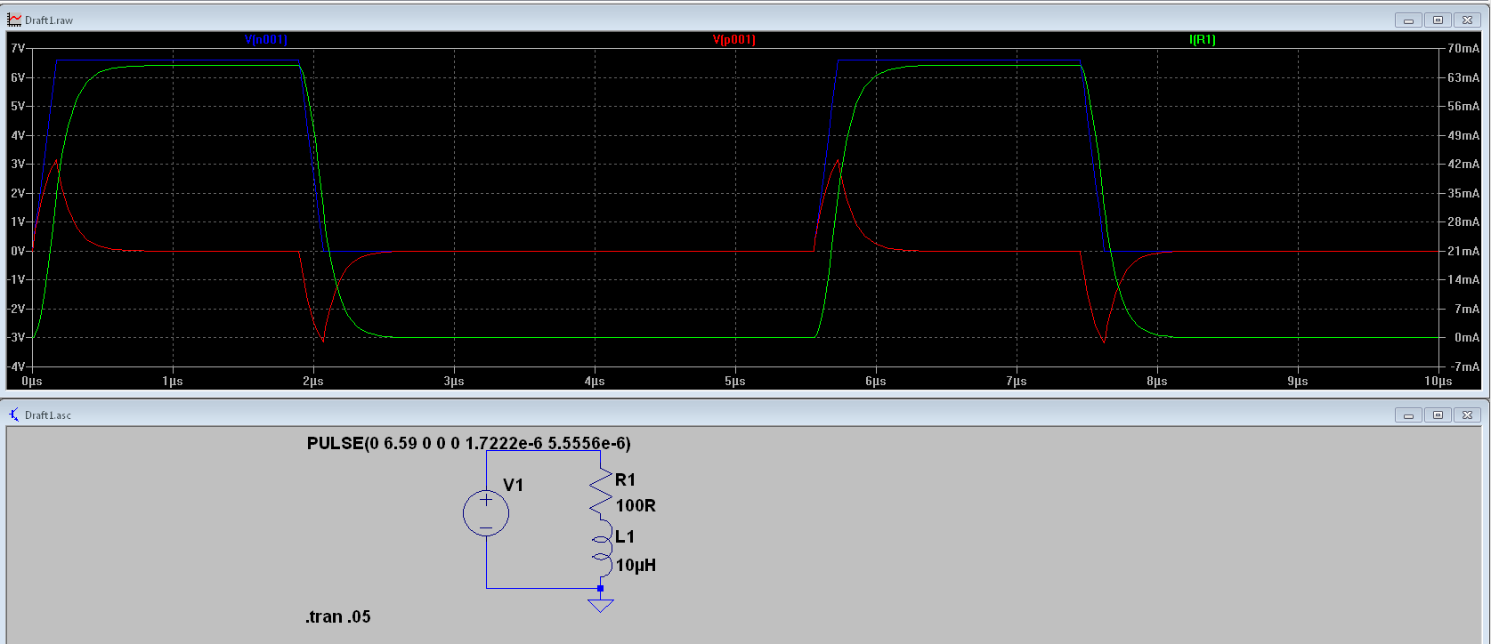

    Hi everyone,
    I have a series circuit. Inductor of 10uH is in series with 100 ohm resistor with pulse train voltage of 6.59 V with a duty cycle of 0.31 and frequency of 180 kHz. I want to calculate the total current flowing in this series circuit. Can anyone help me finding this? I will be really grateful.
    Thank you.

    Re: Series RL circuit
    I suggest using LTspice to simulate the circuit.
    I ran a quick sim and the inductor isn't doing much because the current is small due to the 100R resistor and L is small too.
        Hi Redwire,
        Yes, I agree and simulated myself as well and found the same results. Thanks for your help.
