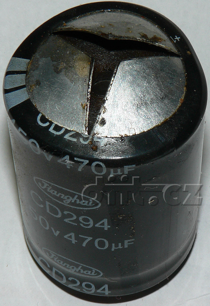

    Mother of holly crap, the bastard is just not giving up!!
    Look at this crap from Einhell ISG 1000/1 welder!!

    Looks like it could have vented due to overvoltage and managed to survive the event, amazingly.

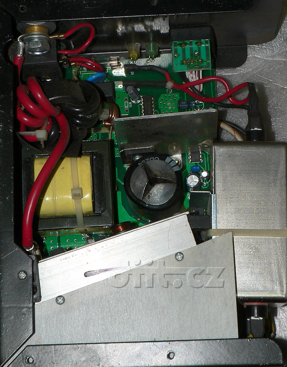

      Something on the secondary is shorted, either one of the fat TO-263 rectifiers (C16T20F) or the IB74 BKH transil (?). Primary seems fine, no shorts anywhere.
      The question is if the cap blew because of overload or it blew before and because of voltage and current spikes on secondary the rectifiers blew than.

        WOOOOOOOOW!
        That sucker was blown HARD!
        Could have been one of the diodes that shorted, putting AC through the capacitor, that would certainly make it vent like that.

            It has fuse, even though on neutral (?!) instead of phase. But the primary seems OK, no rectifier or transistor blown there.
            Problem is with secondary. I found this invertor was not really wery well rated by ppl. It is rated for 80 A, but being able to work only 15 % of time at 80 A output. No wonder, if you multiply 16 A (superfasts rating) by 5 (their number) you get 80 A but we all know it's not really how it works with diodes. Also the cooling system is weird, the diodes are soldered on PCB and the PCB itself is screwed to cooler. So the heat has to go through the PCB material first which is not really a good conductor!
            If I will even succeed in contacting the owner (I got this thing here for so long I don't even remember whose it is ), I'll recommend him replacing the rectifiers with 30A schottkies from STMicro, they should have like 15 W less burned power and provide that 80 A for some reasonable time.

                  Seems the heat transfer is not that bad - I was hardly able to desolder the transil, which was bad, using 60W pen (the high-power one, no micro-crap) and 125W trnasformer pistol. Will have to resolder the output joint which I tore out, probably using hot air and two pens (60+80 watt)s because it is insane.
                  Any idea what the transil is?
