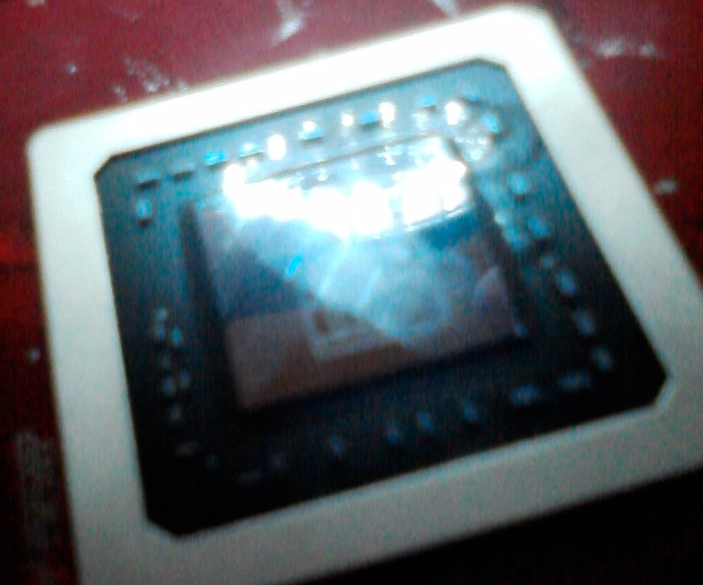

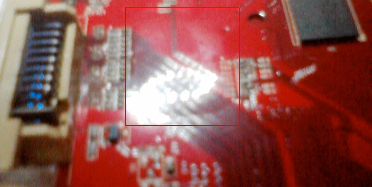

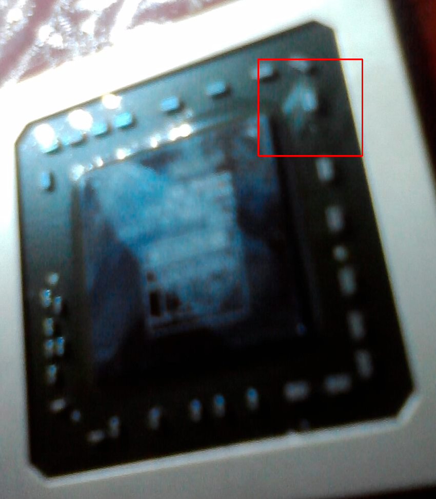

          I think I just screwed it up
          I overheated it and the laquer on the board is raised a bit.
          Also the coating on the GPU, very small area, like it's got a tiny air bubble underneath. What have my grubby lill hands done((((((((
          Can someone please look at the pics and give me good news?
          I'll be waiting with a gun at my head...
            Re: Palit HD Radeon 4850 - OvenTrick and Recap
            That's de-lamination. Happens when you apply too much heat too quickly (usually due to moisture trapped between the PCB layers). Unfortunately, there isn't anything you can do. Both the board and the GPU are done for .
            If you do occasional motherboard and/or video card repairs, keep the card for its SMD components.
            Also, if you do an over reflow next time, make sure to keep the board/card in there for for a good 10 minutes on low heat (around 100C) so that any moisture can dry out. Then after that, slowly bump the temperature up to 230C. 1 to 2 steps should be okay - first bump up to 150-170 and leave for a few (2-3) minutes, then set to 200C and leave again for a few minutes. Finally, set to 230C, leave for another few minutes, then turn off the oven, and slowly let it cool down.
