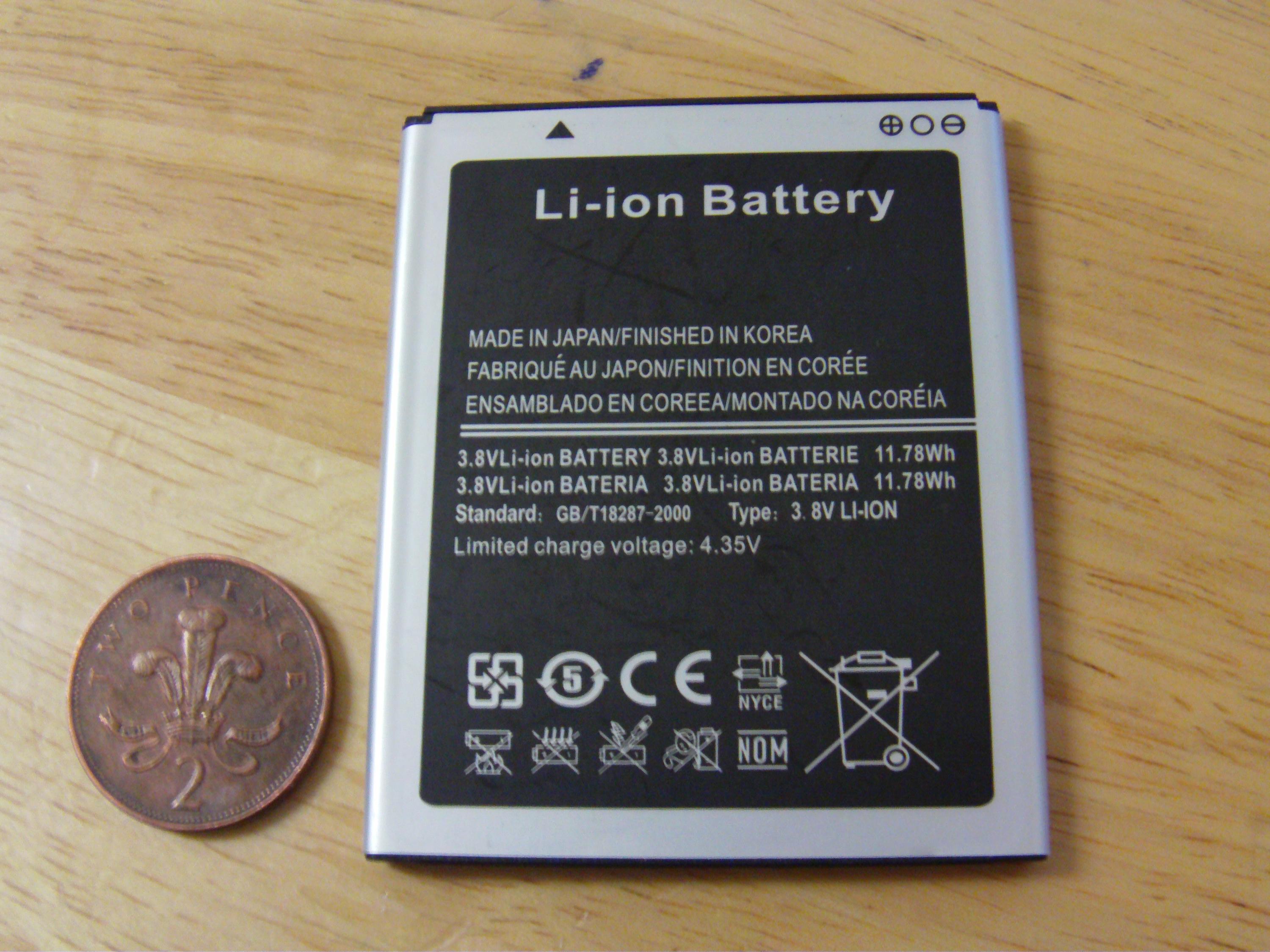

                            Any way of seeing if the battery is of good quality? I have a spare.
                            Do NOT touch heatsinks when testing for voltages as they may be LIVE!
                              Re: Galaxy note 2 clone. Anyone have one of these?
                              Not without a discharge rig. Or knowing who made the cells. Probably a standard size -- e.g. Nokia 3510i battery very common in Chinese products due to wide availability, low cost.
                              • gilly1984
                                • Jun 2012
                                • 751

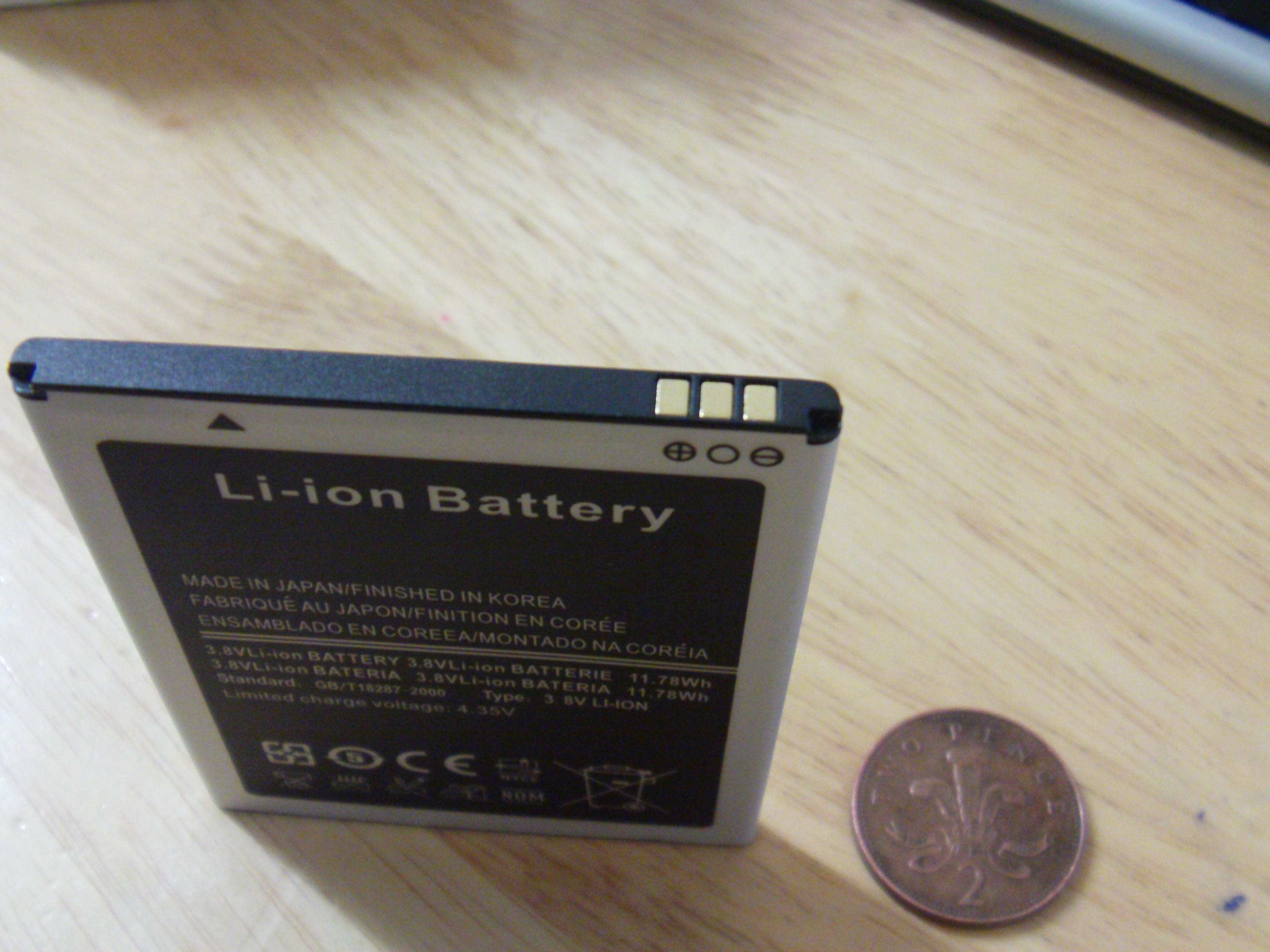

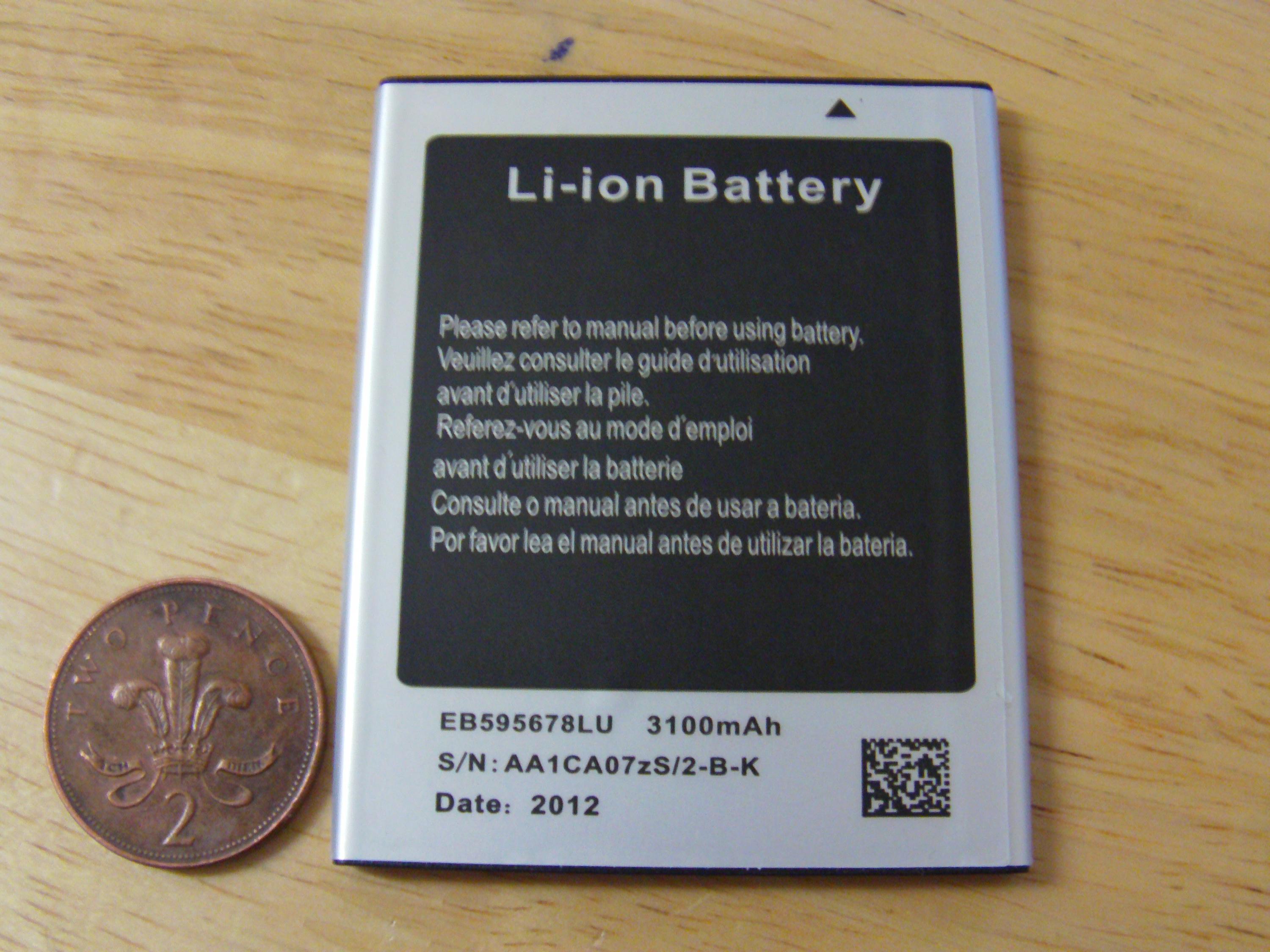

                                Battery is quite big.
                                  It appears to be the same as the Samsung Galaxy Ace i8160.
                                  No way it's 3100mAh. 1200~1300mAh looks to be about the max for that size.
                                  • gilly1984
                                    • Jun 2012
                                    • 751
                                    Battery monitor widget shows it as 1500mah, not sure how accurate that is though .
                                      That's probably closer to the true capacity. I see some Samsung originals at 1500mAh. But you can always source a genuine Samsung one which'll likely work.
