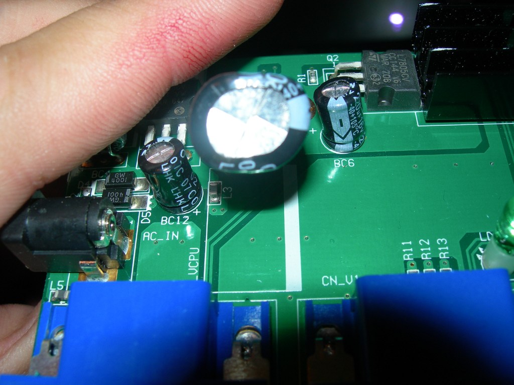

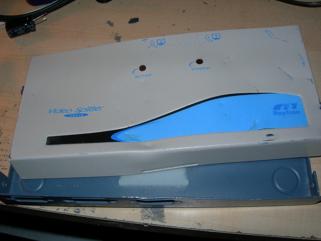

    I found this video splitter near the skip at my college, I walk past it every day and there's usually a piece of broken electronics there every week.
    On first look, the case is very, very bent up - like something heavy was placed on it, or it was stepped on. Not sure what the fault is. It takes AC (for generating +5V and -5V) but I gave it DC and the power LED came on fine. Apart from that I've done no other testing.

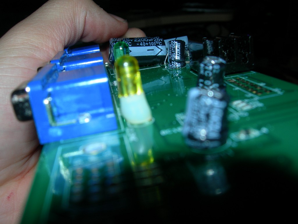

    What's amazing is the big 2200u 25V cap is quite squashed, but still measures 2300uF 0.01 ohms. However, I think I found the fault; one of the smaller 220u caps is squashed near the base and shows as shorted, for the negative rail. If this is the case then this would stop it working. I wonder if it was thrown out because of this, or if there's another fault. Amazingly, every other capacitor shows readings well within tolerance.

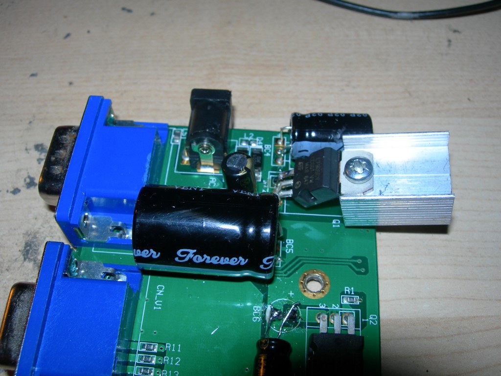

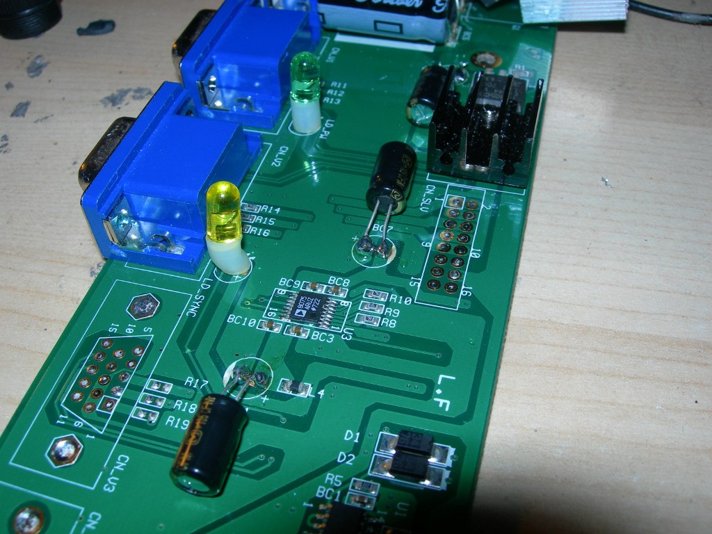

        Okay the "recap" is complete.
        The little Jackcons were replaced with Panasonic FM... just because I had them lying around. I kind of surface mounted them because the board holes weren't big enough for the FM leads.
        I also added a heatsink to the 7905. The tab got a bit bent, I don't think this will hurt it.
        The big 2200u 25V was replaced with a "Forever-C" capacitor, nothing special, a general purpose cap and in the application it is used in, it is fine.
        The remaining 1000u 25V was not replaced as it was not deformed.
        Will need to find a 9-12Vac adapter...
        The case is really, really beat up. I am going to have to figure out how to smooth it out.
