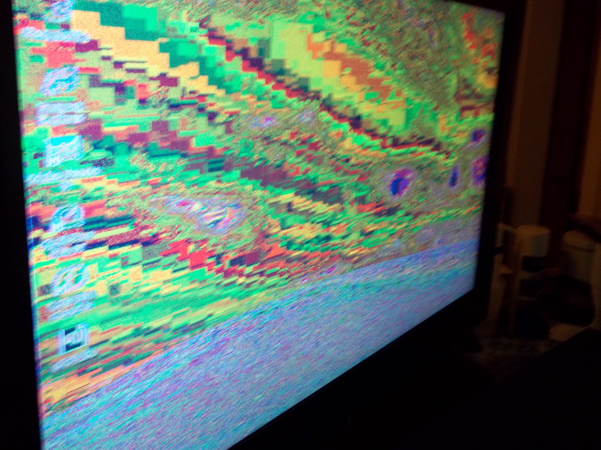

    I was watching Top Gear on my 42" syntax-brillian Olevia tonight and of course it randomly shuts off.
    When I turned it back on I noticed weird artifacting but had normal color. I waited till commercial break and switch off my TV from the plug. When I turned it back on I got something similar to this.
    It won't display normal color it really looks like something that you would see in the 90's when they scrambled the premium channels. Tried a different input went from HDMI to composite same thing even the white from the Wii is displaying as red.
    But if you first turn it on and you get the nice bright white OLEVIA! logo that displays normally then the set would go to no signal which is blue but it's displayed as a lime green.

          That picture reminds me of when the Windows video driver had an error and
          disabled everything except for 4 BPP (16 colors) color! O_O

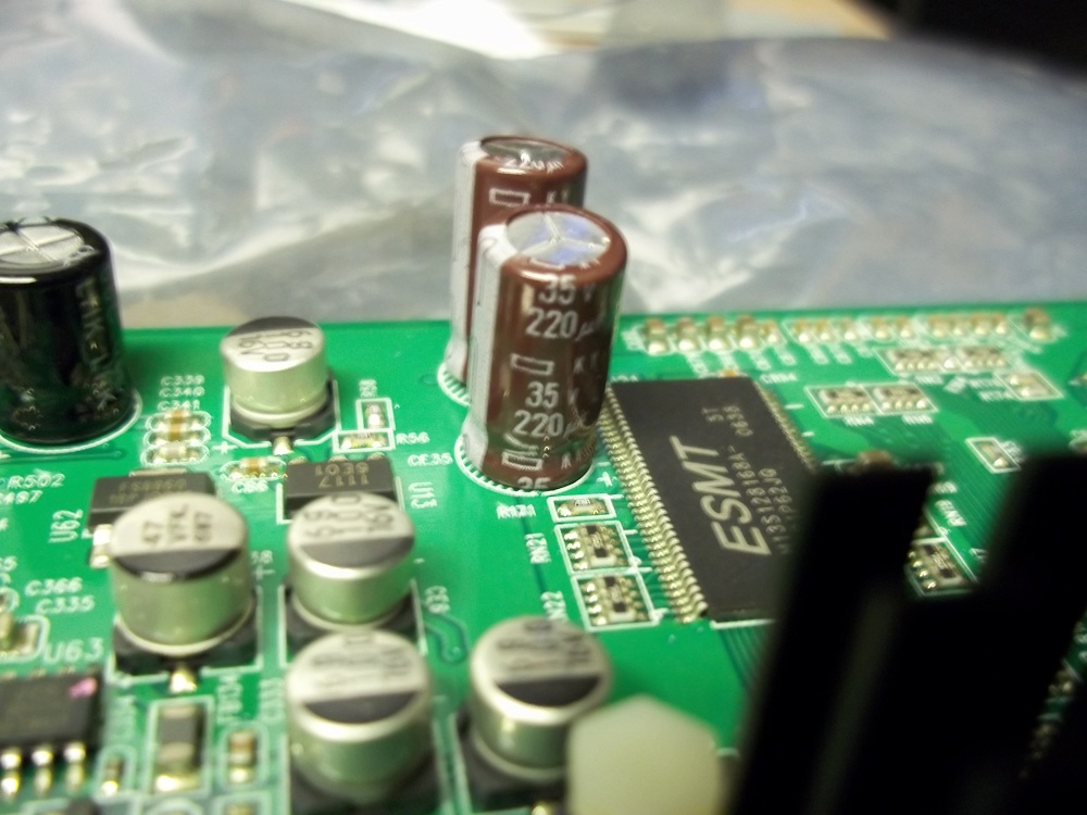

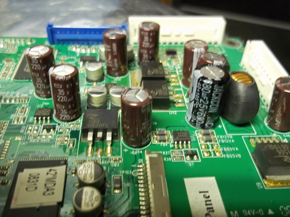

            Some of the KYs look wrong. Factory caps usually aren't that crooked. Maybe failed at the bottom. The vent on C404 looks bulged, but the picture isn't sharp enough to tell for sure.

              c404 is not bulged. The caps are crooked but nothing is coming out the bottom. There a few around the board like that. It looks like they just drop the caps in but did not push them to the board.
              Should I just go ahead and replace all of them just incase?
              Also what cap can I use for LHK since the datasheet doesn't list the ESR.

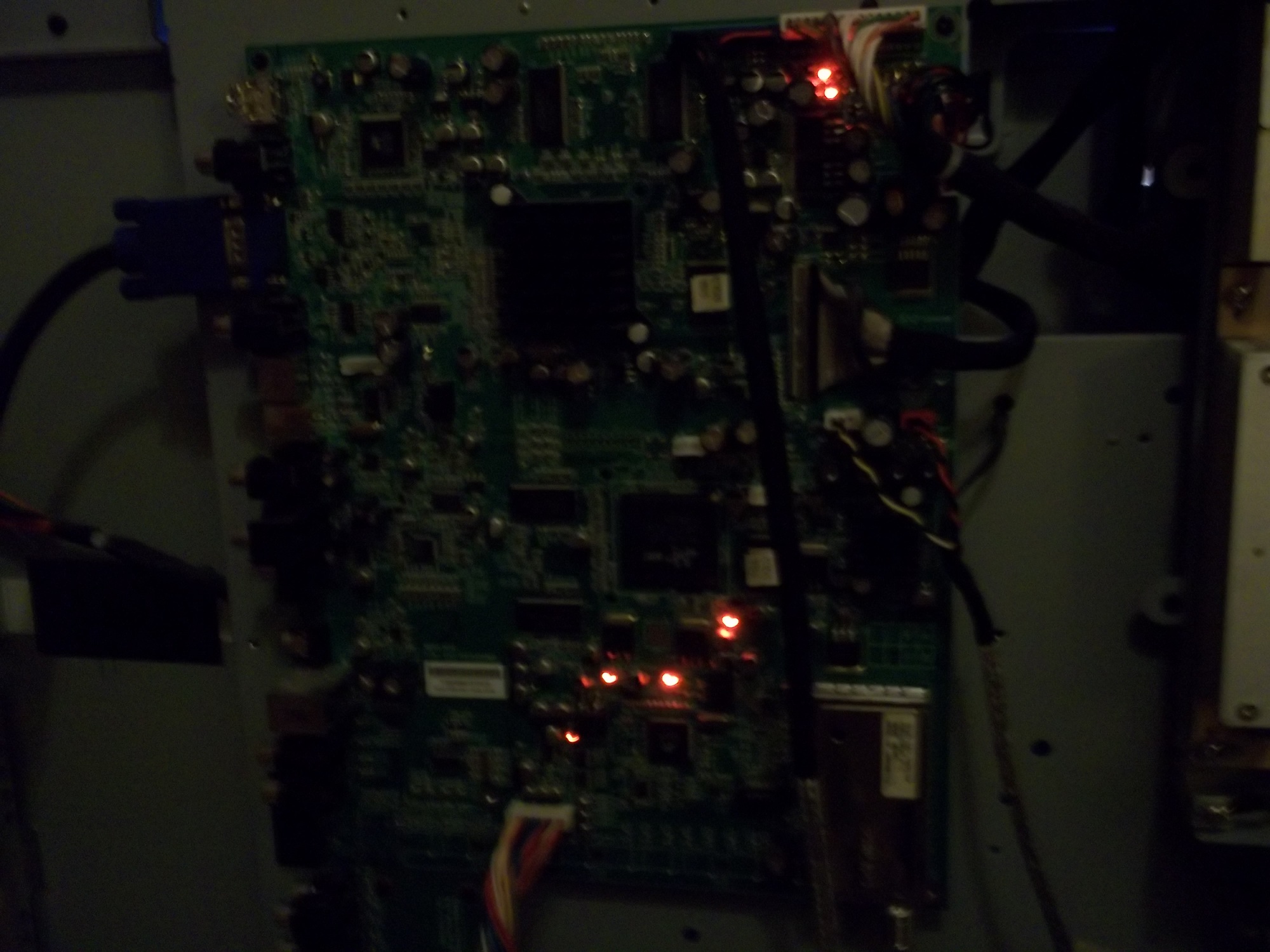

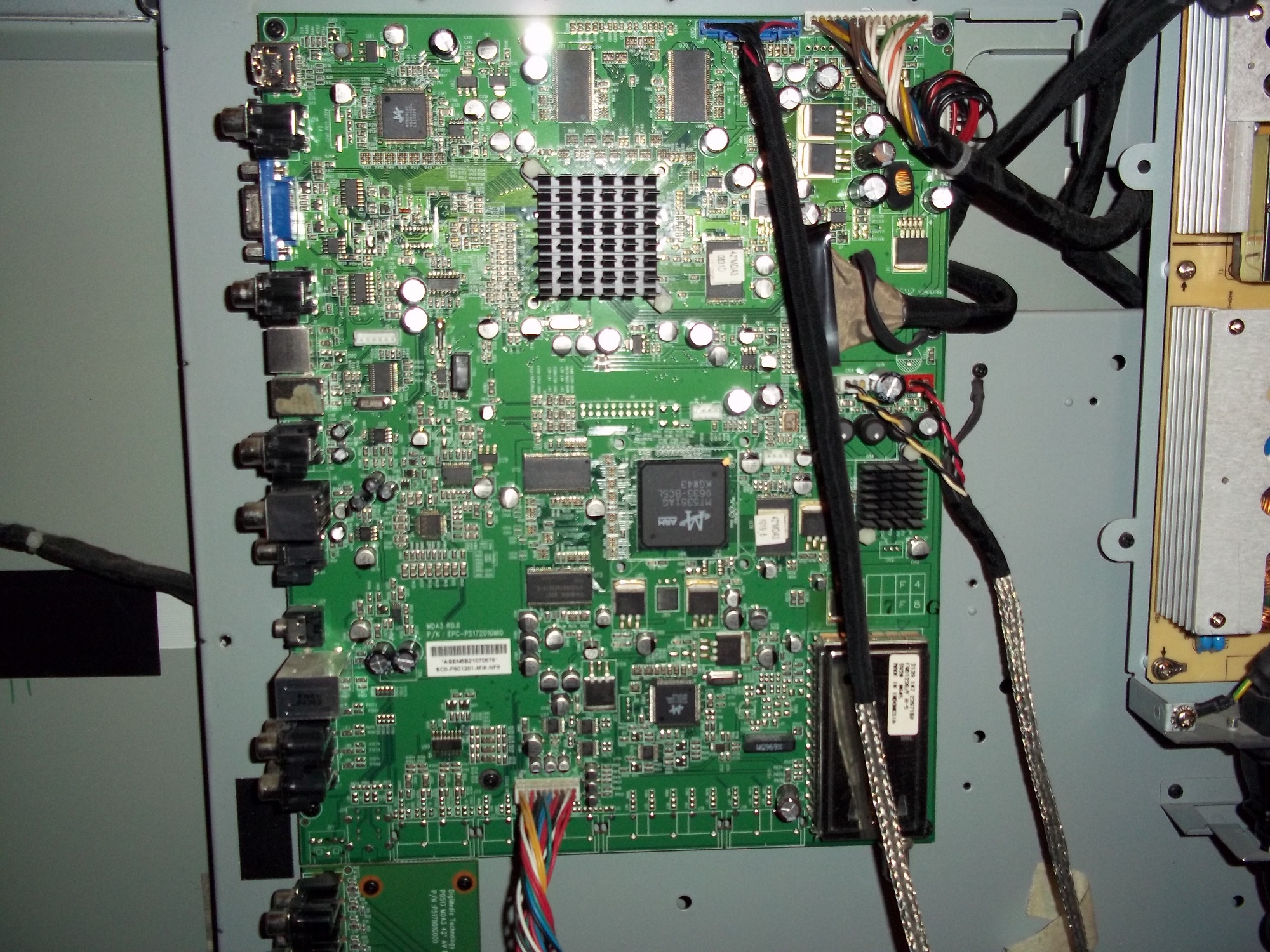

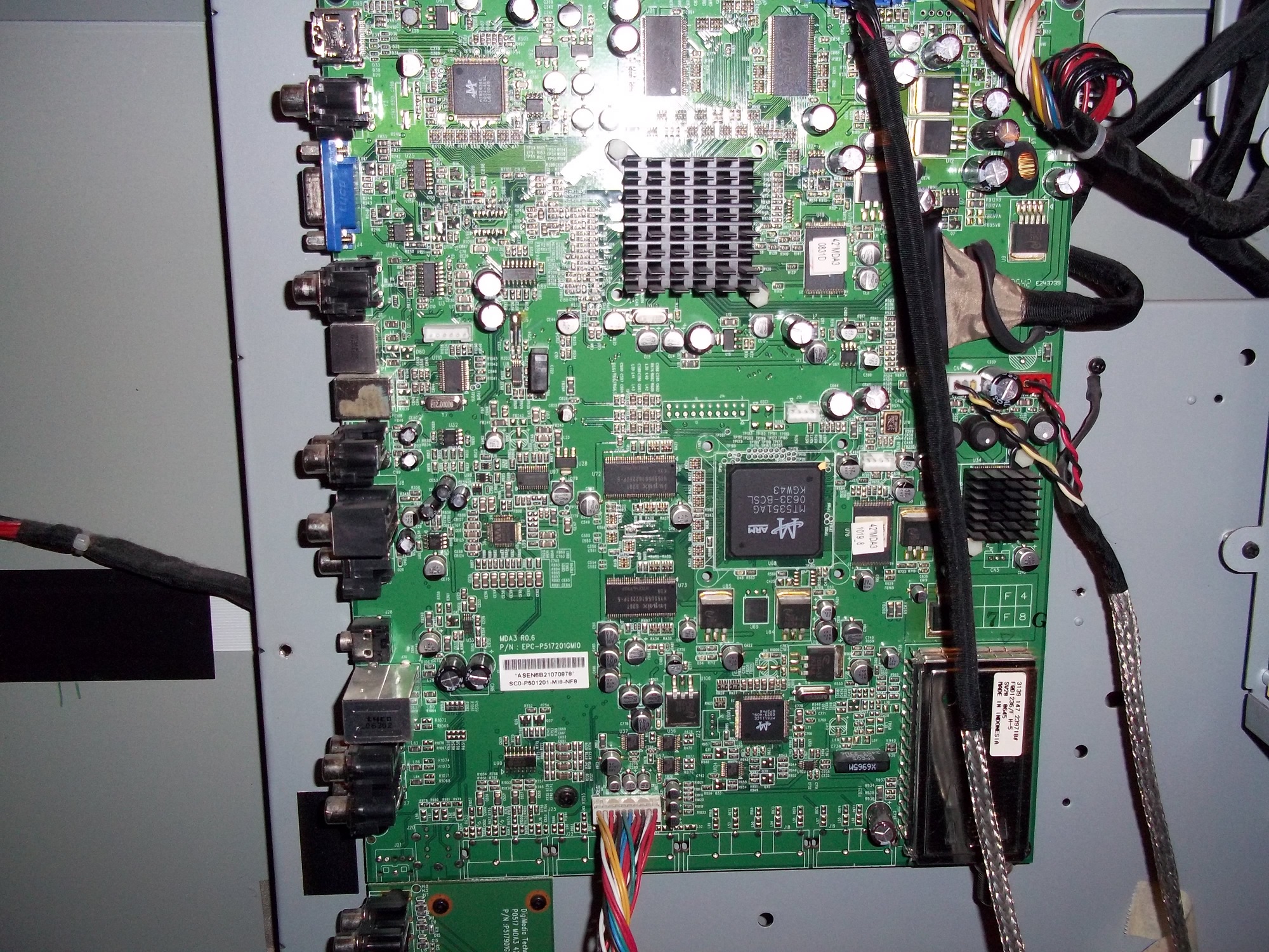

                    Replaced large jackcons
                    It didn't fix the problem.
                    Anyways photos below, was going to get close up of board but camera ran out of juice.
                    It should be displaying Winodws XP default background icons and taskbar. Second pic is the board when it's on.
