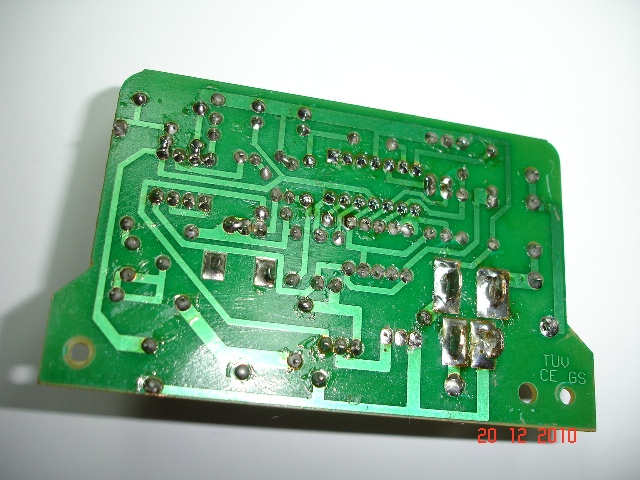

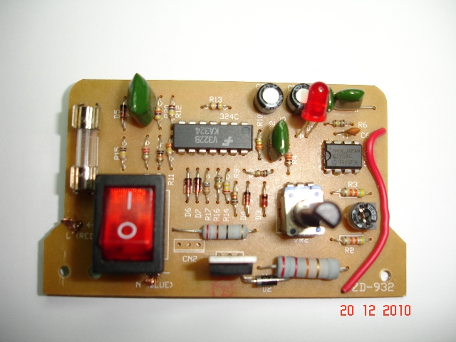

    Hi guys,
    I'm having trouble finding the defect of this soldering station:
    Toyo TS - 905
    The iron heats up to + / - 60 ° C and maintains this temperature. Turning the pot nothing happens. When it reaches this temperature, the LED which indicates that the temperature is always blinking.
    Replace the C1701C, but the problem still remains. After that, replace also HA17324.
    Has anyone had a problem like this?
    Thank's!

          The Triac it's OK. Was my first hint.
          The IC's are:
          C1701C = 8 pins
          HA17324 = 14 pins
          Yesterday, I removed each of the components and measured them. Nothing, all were within the limits ...
          Tonight I will keep trying

            Re: Toyo TS - 905 don't heat...
            Please upload your photos in your posts rather than using an external hosting site. That way they will always be here even if the originals site gets changed, goes down etc.
            I have taken the liberty of adding them to my own post here.
                I have good news! After several days of trials and tests I discovered by chance that the 50k trimpot was defective ....
                Yeah. He seemed to be charred. When I measured the total, everything seemed fine, but after removing it to measure the resistance across its course, he "went mad"!
                After replacing it, the station was OK!
                Well, anyway, thank you all and here is a tip!
                Bye
