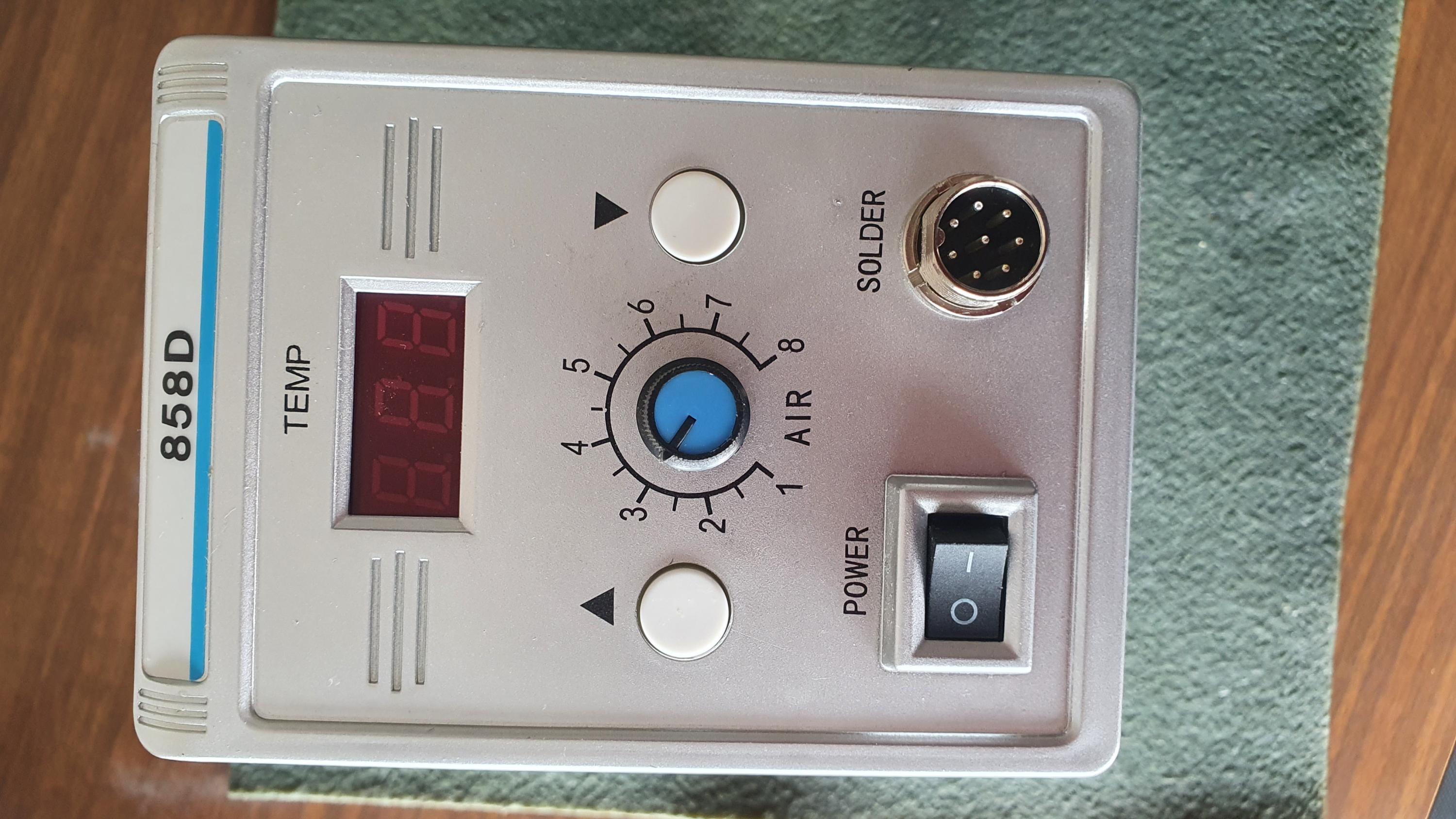

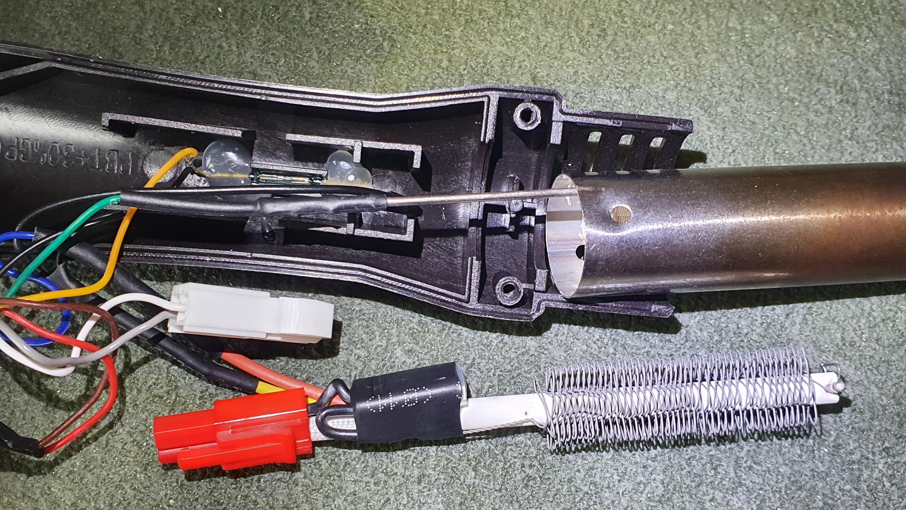

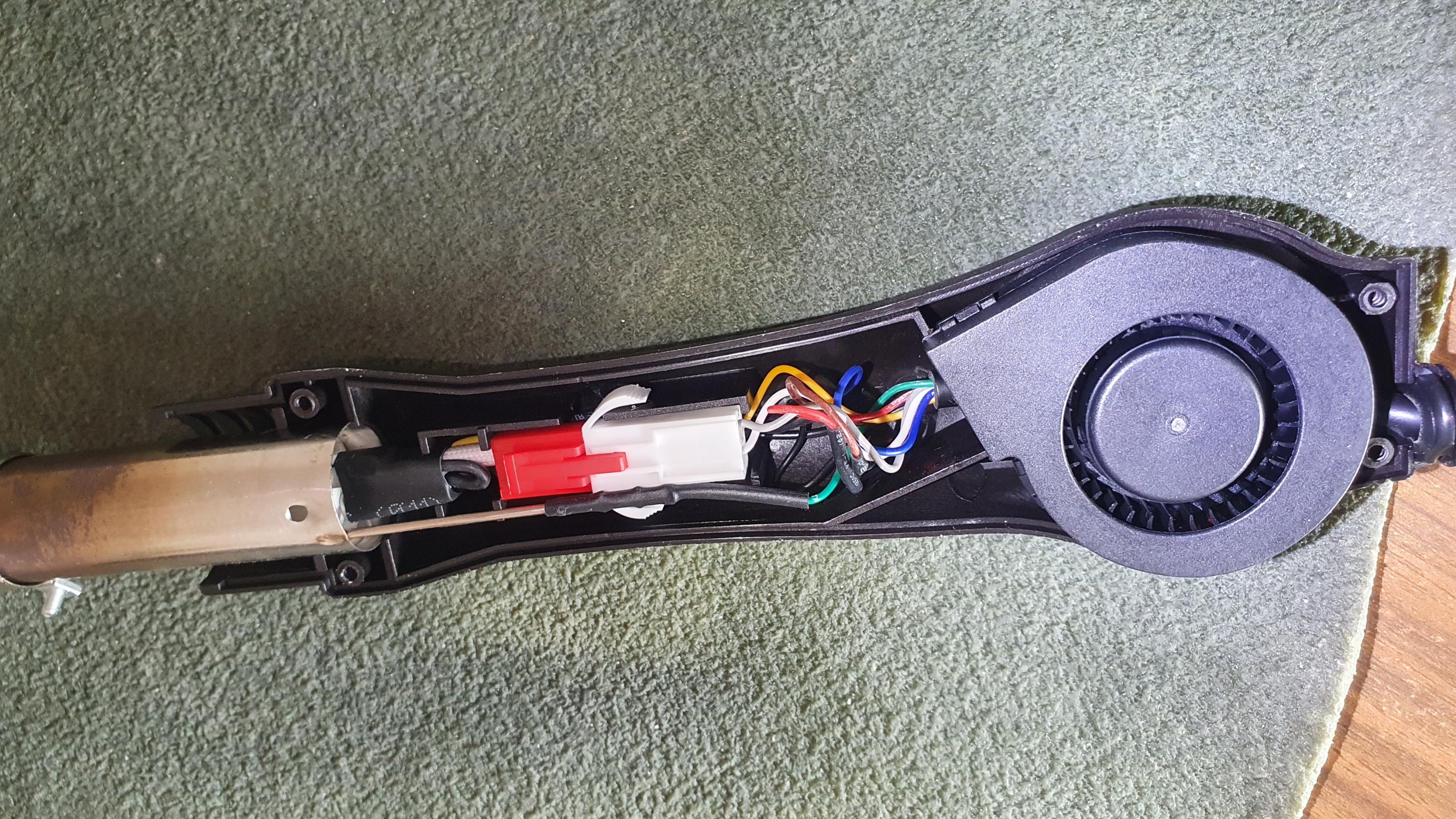

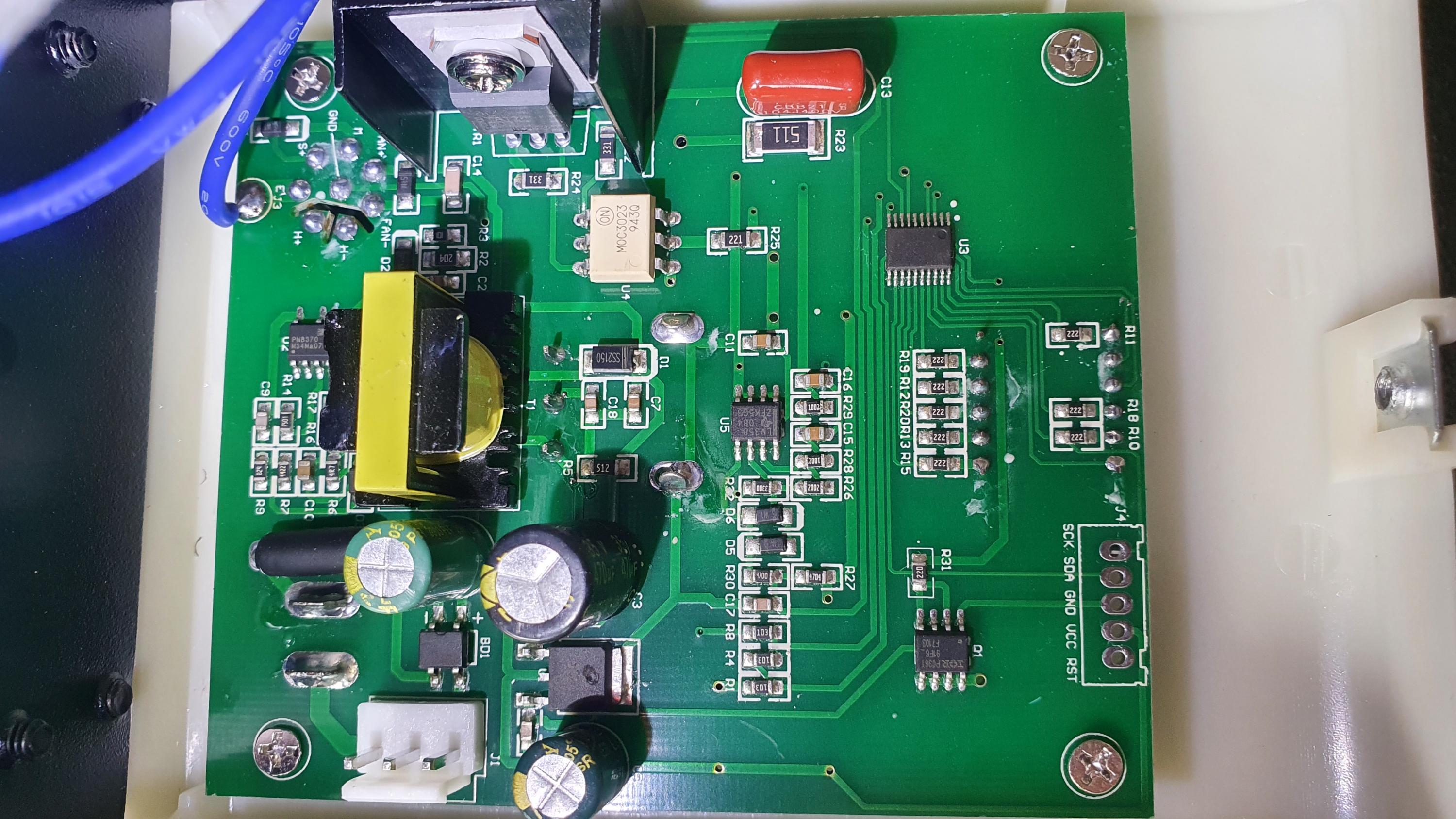

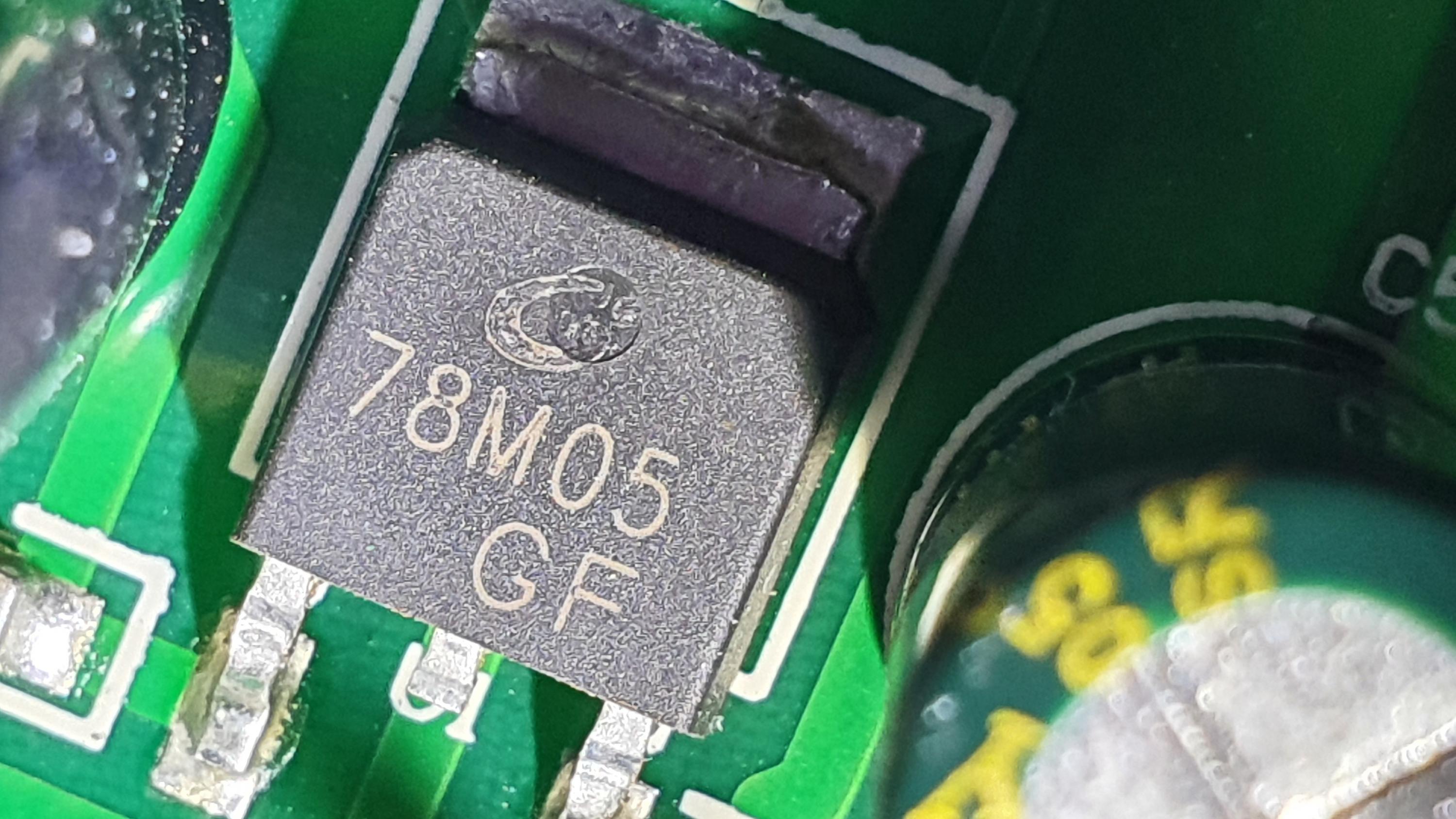

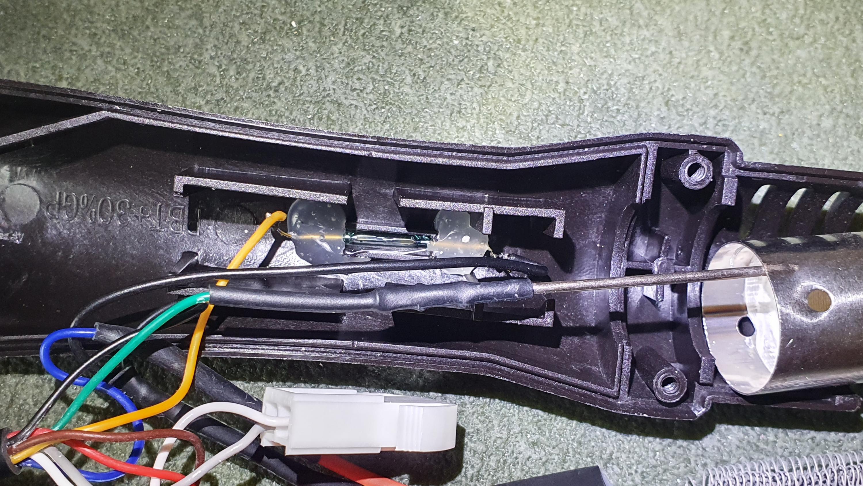

858D hot air station provide air at 200 degree instead of 500
  • corrize
    • Apr 2021
    • 288
    • France
    858D hot air station provide air at 200 degree instead of 500
    Hello, I noticed that was become almost impossible to desolder component with my hot air station. I measured with meter : air at output is at 220 degree celsius max, even set at 500 degree. So something is bad. Maybe temperature probe inside ?
    Not yet disassembled, have you see some « well know » ou frequently issues to this sort of tools pls ?
    • 31197
    Re: 858D hot air station provide air at 200 degree instead of 500
    post a picture of the board, i have some schematics
    • diif
      • Feb 2014
      • 6978
      • England
      Re: 858D hot air station provide air at 200 degree instead of 500
      Inspect the heating element when it's on. I must have knocked my nozzle as the element had become a little tangled and wasn't heating evenly/fully.
      • corrize
        • Apr 2021
        • 288
        • France
        Re: 858D hot air station provide air at 200 degree instead of 500
        I disassembled and there is nothing inside. The box seems good. The issue come probably from gun. That could be the heating element indeed, I will check that.
        • corrize
          • Apr 2021
          • 288
          • France
          Re: 858D hot air station provide air at 200 degree instead of 500
          I disassembled the gun, nothing obvious.
          I see a bimetal, probably good. Thermal probe taped with heating element.
          That could be wire of eating element touching other and reduce heating capacity ?
            • 31197
            Re: 858D hot air station provide air at 200 degree instead of 500
            when you turn it on, do you see the temperature rise on the display?
            if yes then it could be the feedback circuit.
            (we can check that with a soldering iron)
            also, look at the aviation connector contacts - those connectors arent really rated for this type of power
              • 31197
              Re: 858D hot air station provide air at 200 degree instead of 500
              on the board under c3 is a transistor or something - has it got a hole in it or is it the camera?
              • corrize
                • Apr 2021
                • 288
                • France
                Re: 858D hot air station provide air at 200 degree instead of 500
                I checked, it's factory mark, not a hole. The temperature rise on the display. I can't check the connector, the front cover is very hard to remove. I can't pull button.
                I don't know electronic for heat. It is alternat voltage feeding the gun ? And what's increase the heat when I turn the button, voltage or current ?
                  • 31197
                  Re: 858D hot air station provide air at 200 degree instead of 500
                  the heater is mains voltage 230v, the heat is controlled by the board pulsing the power and an ajustable speed.
                  • harp
                    • Jun 2022
                    • 622
                    • Planet Earth
                    Re: 858D hot air station provide air at 200 degree instead of 500
                    Check resistance of disconnected heater element, and compare measurement with same end on pcb board. Maybe some wire connection has loose and warming up.
                    Resolder all pins of triac and tracks from mains to heater on pcb, make it flooded with solder.
                    • Gregtheone
                      Hot air station - 858D opinions?
                      by Gregtheone
                      Hello guys!
                      I would like to ask your opinion on the hot air station Atten 858D or even 868D (there are many other producers of this very same product like W.E.R and so on).
                      Rough specifics:
                      Power consumption: 700W
                      Airflow: 120L/m (max)
                      Temperature range: 100-450 celsius
                      I would want to remove and resolder the RAM BGA chips of a graphics card and I was wondering if it is plausible with a 858D (or 868D) or not? I have heard others say, that for a RAM sized BGA it is better to use a stronger hot air station, but I was wondering if...
                      04-18-2022, 04:35 PM
                      HP Station de travail Z2 format tour G4 i7-8700 Specification for Upgrade or Repair
                      This specification for the HP Station de travail Z2 format tour G4 can be useful for upgrading or repairing a desktop PC that is not working. As a community we are working through our specifications to add valuable data like the Station de travail Z2 format tour G4 boardview and Station de travail Z2 format tour G4 schematic. Our users have donated over 1 million documents which are being added to the site. This page will be updated soon with additional information. Alternatively you can request additional help from our users directly on the relevant badcaps forum. Please note that we offer no...
                      09-12-2024, 02:20 PM
                      MSI Gaming GF66 11UG-820FR Katana Dragon Station Notebook GF Specification for Upgrade or Repair
                      This specification for the MSI Gaming GF66 11UG-820FR Katana Dragon Station Notebook can be useful for upgrading or repairing a laptop that is not working. As a community we are working through our specifications to add valuable data like the GF66 11UG-820FR Katana Dragon Station boardview and GF66 11UG-820FR Katana Dragon Station schematic. Our users have donated over 1 million documents which are being added to the site. This page will be updated soon with additional information. Alternatively you can request additional help from our users directly on the relevant badcaps forum. Please note...
                      09-07-2024, 05:20 AM
                      HP EliteBook 840 G6 + UltraSlim Docking Station Notebook 800 Specification for Upgrade or Repair
                      This specification for the HP EliteBook 840 G6 + UltraSlim Docking Station Notebook can be useful for upgrading or repairing a laptop that is not working. As a community we are working through our specifications to add valuable data like the 840 G6 + UltraSlim Docking Station boardview and 840 G6 + UltraSlim Docking Station schematic. Our users have donated over 1 million documents which are being added to the site. This page will be updated soon with additional information. Alternatively you can request additional help from our users directly on the relevant badcaps forum. Please note that we...
                      09-06-2024, 06:00 PM
                      HP EliteBook 840 G6 + UltraSlim Docking Station Notebook 800 Specification for Upgrade or Repair
                      This specification for the HP EliteBook 840 G6 + UltraSlim Docking Station Notebook can be useful for upgrading or repairing a laptop that is not working. As a community we are working through our specifications to add valuable data like the 840 G6 + UltraSlim Docking Station boardview and 840 G6 + UltraSlim Docking Station schematic. Our users have donated over 1 million documents which are being added to the site. This page will be updated soon with additional information. Alternatively you can request additional help from our users directly on the relevant badcaps forum. Please note that we...
                      09-06-2024, 12:30 PM
