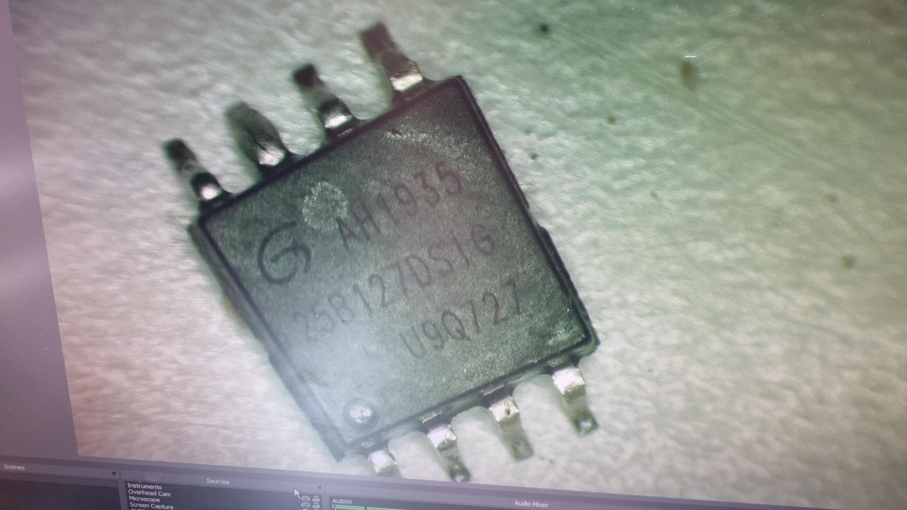

    Hi guys
    My TL866CS doesn't have this eprom in the list of devices (Minipro v6.85) 25B127DSIG
    Possibly because I have an old version of the software? I tend to stick with something until it let's me down.
    Can I select some other device or is there a link where I can get an updated version of the software if needed, and not worry about malware etc
    I downloaded XGeko pro V8.51 but that does not list this eprom either
    I also have a CH341A but never actually used it.

    Re: 25B127DSIG programming with TL866CS?
    127?????
    you mean 25b128d?
      Hi stj
      No mate it is 25B127DSIG (see pic)
      It's from a Lenovo S145 laptop
      According to the schematic the chip should be W25Q128JVSIQ. This is not on the list of supported IC either so I used W25Q128BV
      This seems to have worked
      https://www.badcaps.net/forum/showpo...&postcount=153
      I guess it is compatible.
        thats wierd, the part number is suposed to be binary - maybe it has some bad bits!
