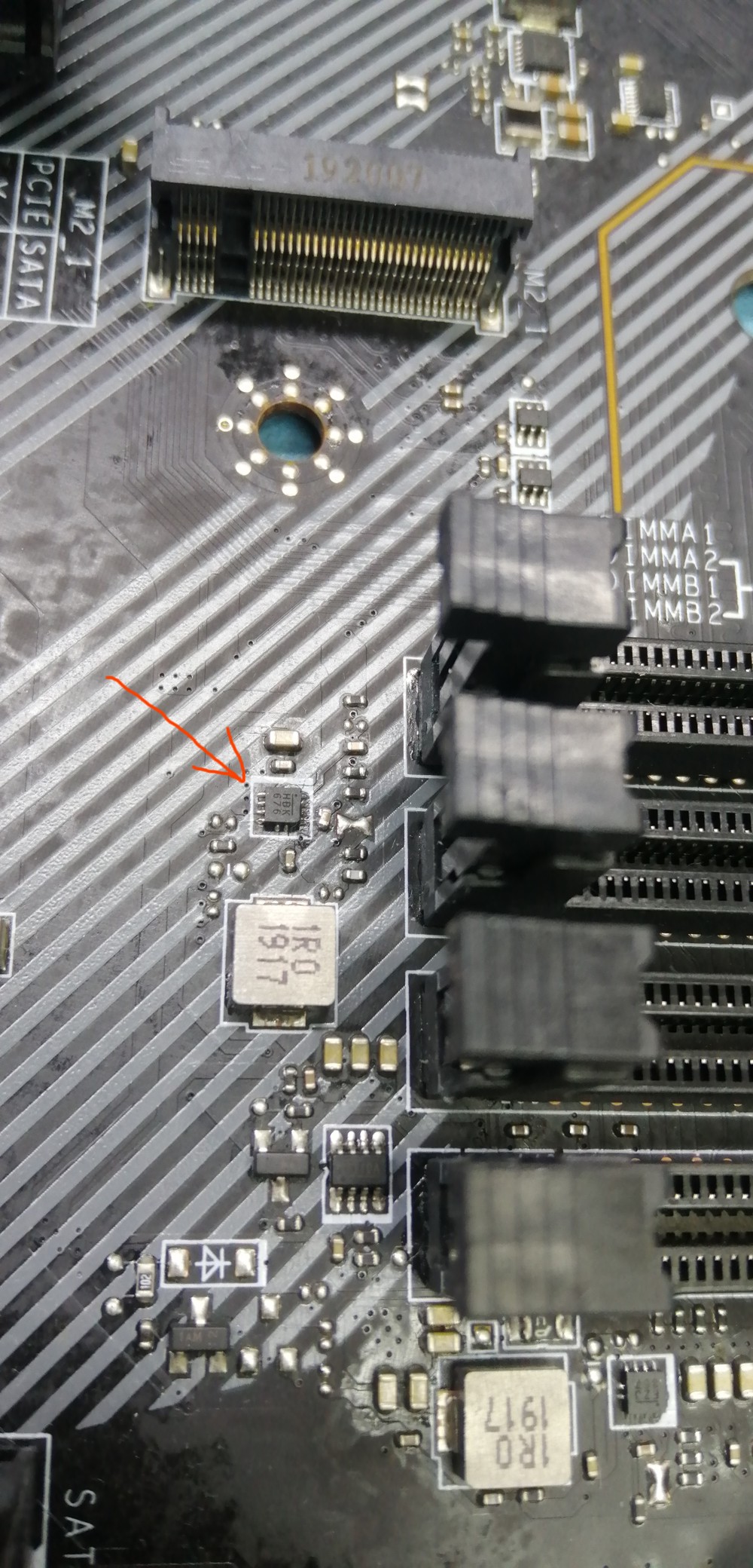

    Hi guys
    You can see the attached pic - the QFN is faulty and needs changing. It is closer than 1cm to the DIMM sockets and of course I must not damage these
    So.... best suggestions and techniques please. Desolder and Resolder. I have some thoughts myself but don't want to distort the responses

    shield the sockets with tin-plate
    i use old tuner covers.
    and consider heating the underside first.

      You could Dremel the top off if you're worried about heat. I'd shield the ram socket with foil and kapton tape.

        Worried about heat? Use a QFN soldering iron tip
        ... don't bother to buy one: that qfn ic is so small that your everyday soldering iron will be enough:
        just make a solder bubble and drag it to the unused space (top left corner on the picture)
        or live life to edge and throw it off by quickly flipping the motherboard upside down.

          try hot air and iron at same time . crank both up and do it as quick as possible .oh add low melting solder to speed things up .

            I normally add leaded solder to all the pins of an IC, or SMD cap/resistor before using hot air to desolder - It seems to help a alot, but I'm not sure how effective that would be on a QFN where most of the pads are underneath the IC
            Are you suggesting if I add leaded solder as best I can then place a large tip (T12 BC3) to the top left corner of the QFN, hit Boost on the KSGER T12 and I can just lift it off with tweezers?
            I can see that may work if, especially if I use my hot air preheater (Kada 853B) and a thermocouple to get that area of the board heated from below to around 100C first. Hmmm........... interesting.

              Since it's a (very) small QFN IC package not only add leaded solder to the pins but also make a solder bubble covering all the IC.
              Therefore, don't bother with the underneath, the leaded solder will reach there.
              Yes, but again since the IC is so small using tweezers will cool the solder before you manage to grab it.
              Instead use the soldering iron tip to drag it.
              imo there's no need to add complexity to the procedure using a hot air preheater below the motherboard.

                I'll look for some small QFN on scrap boards to practice this method first. The 'solder bubble' method is something I already use with other SMD devices
