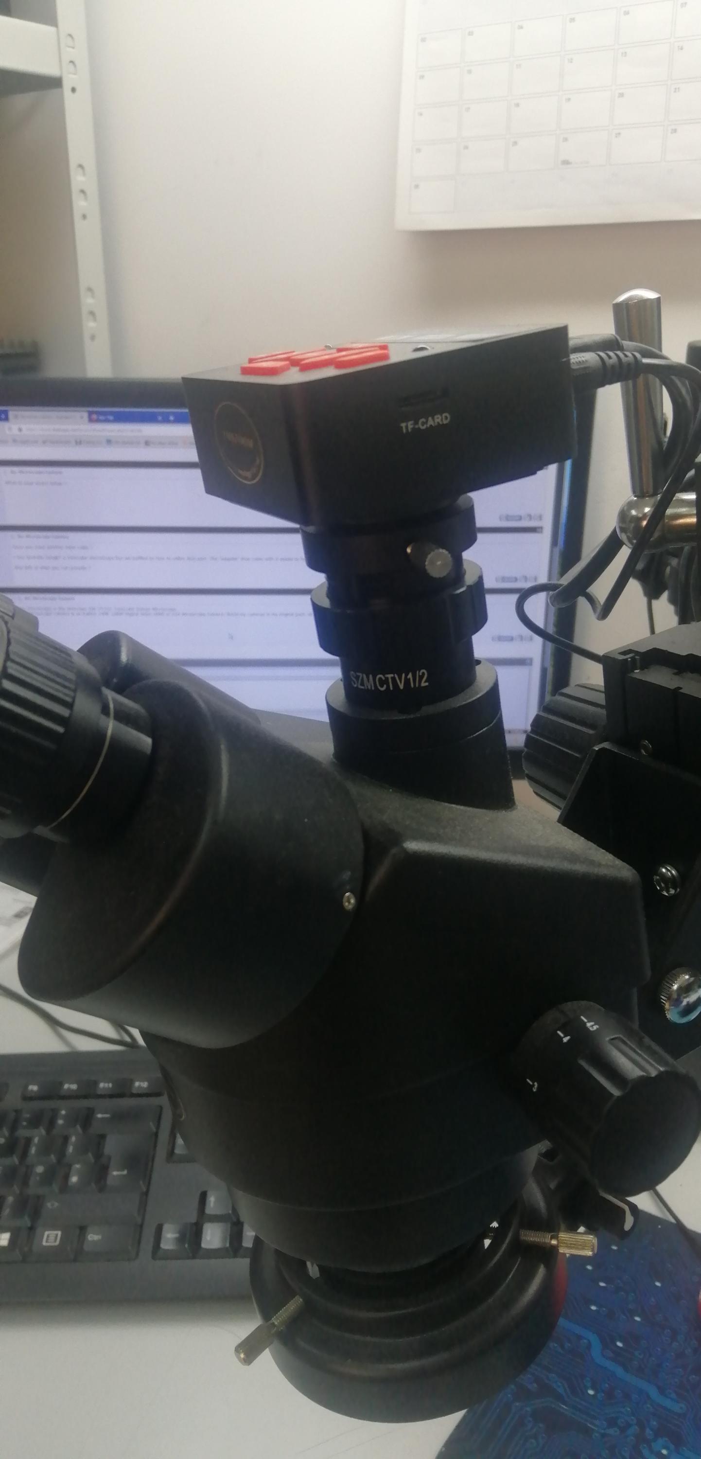

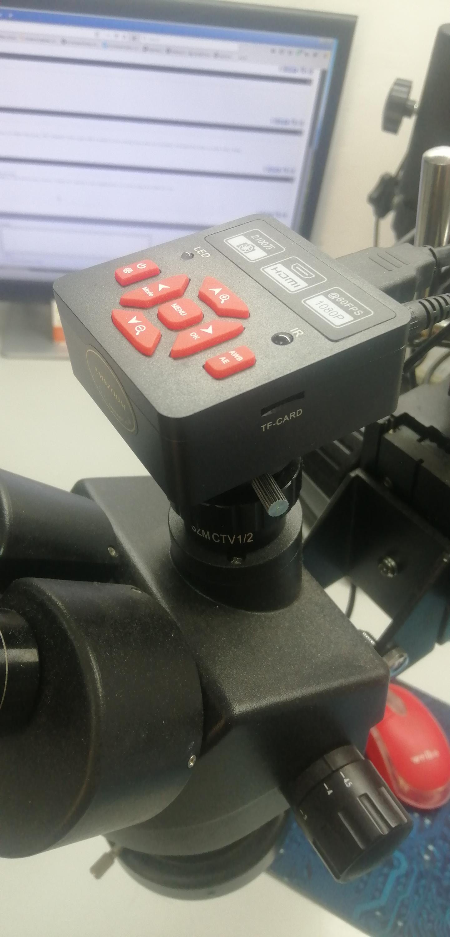

            Re: Microscope Camera
            This is mine - it is some clone of the Amscope I am sure. Mine had the hollow tube to mount the camera and I had the same problem that the HDMI image was much more magnified than the view through the microscope.
            I had to fit this SZM CTV1/2 adapter and now the image is a similar size. It's still a bit wider field looking through the eyepieces but the size difference on the HDMI image is not too bad, certainly close enough for inspection or making youtube videos.
