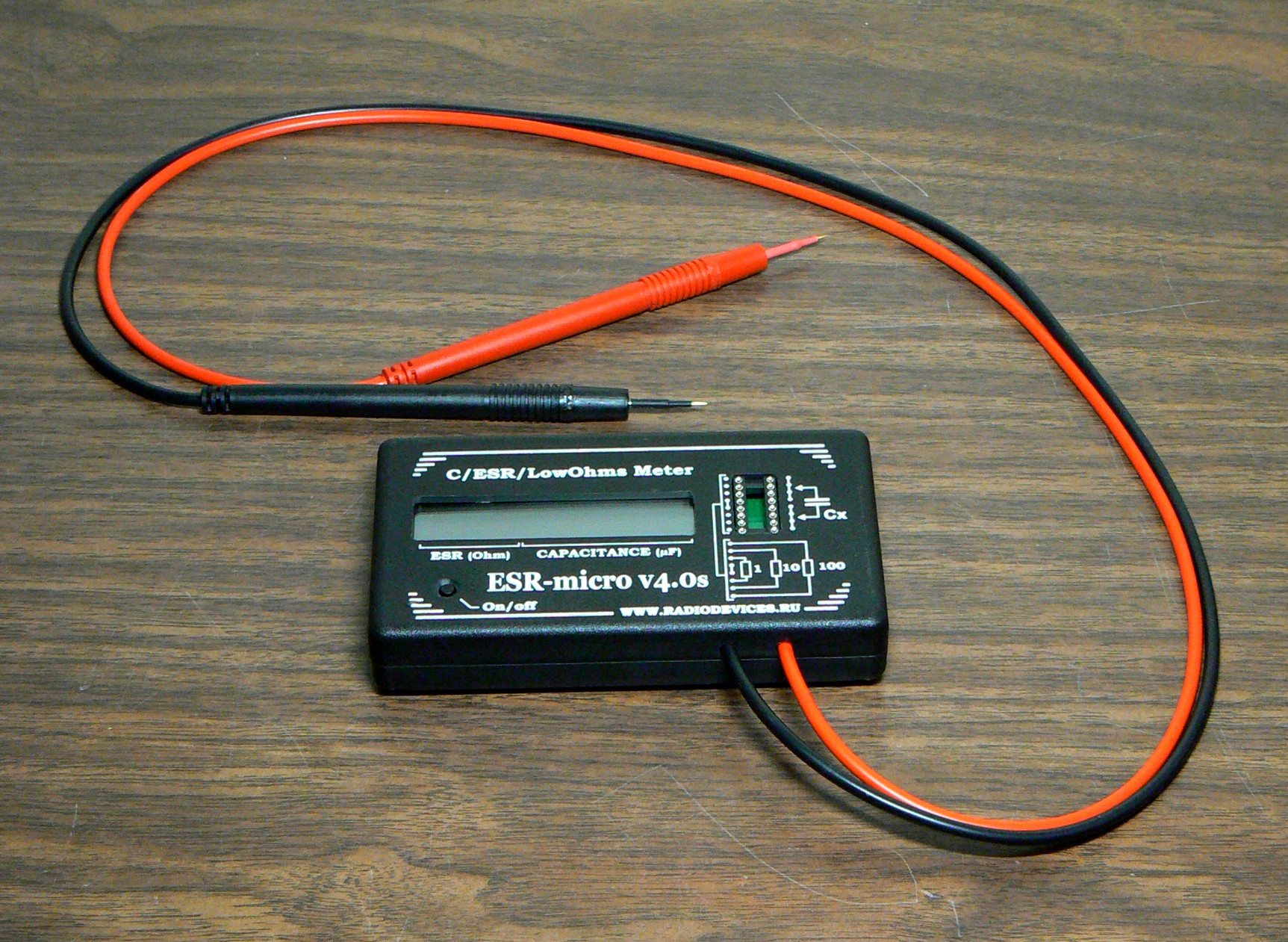

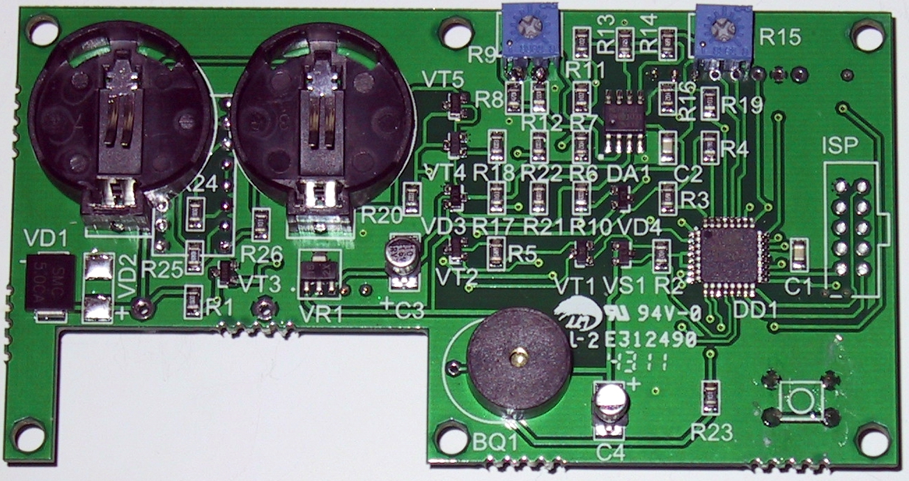

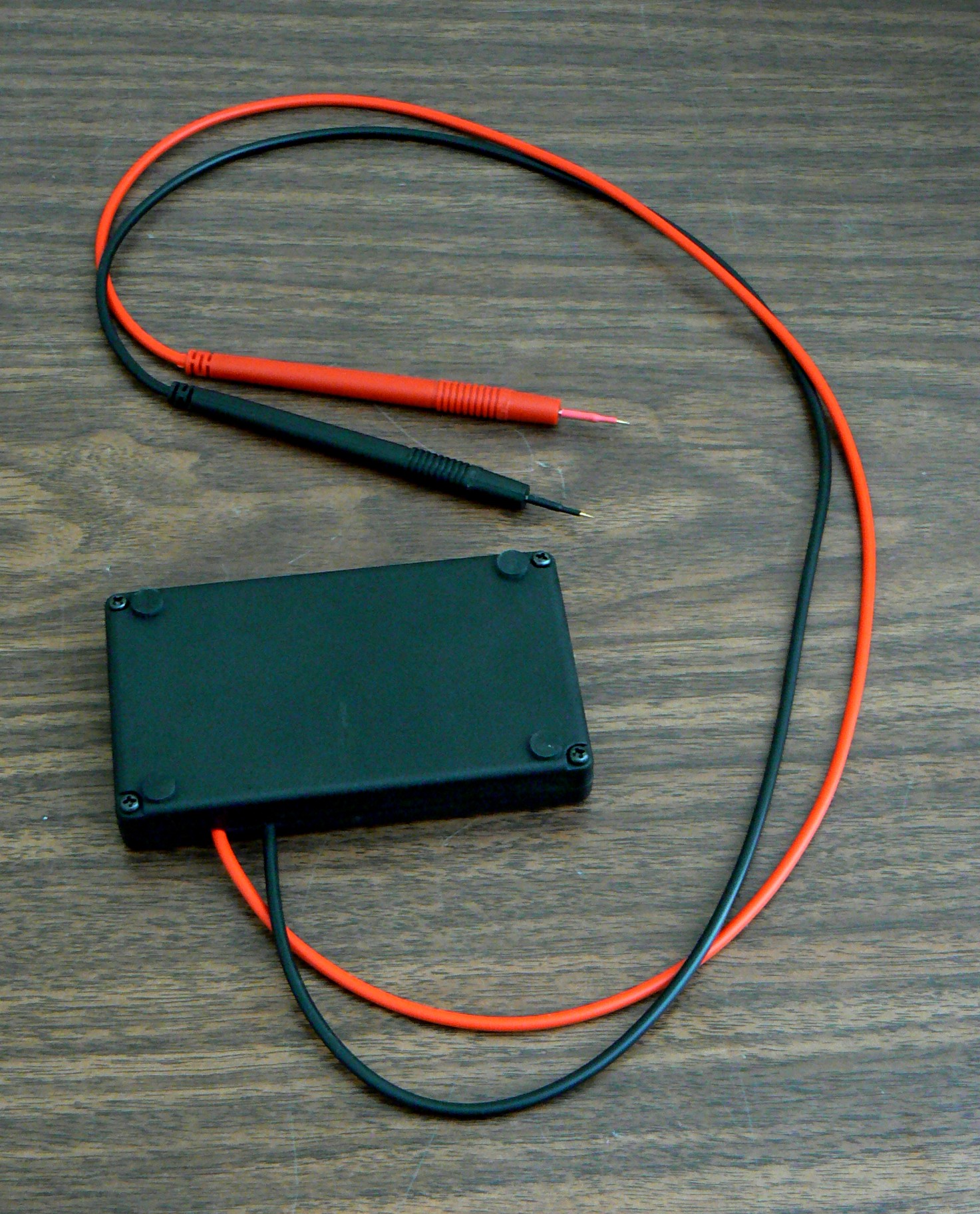

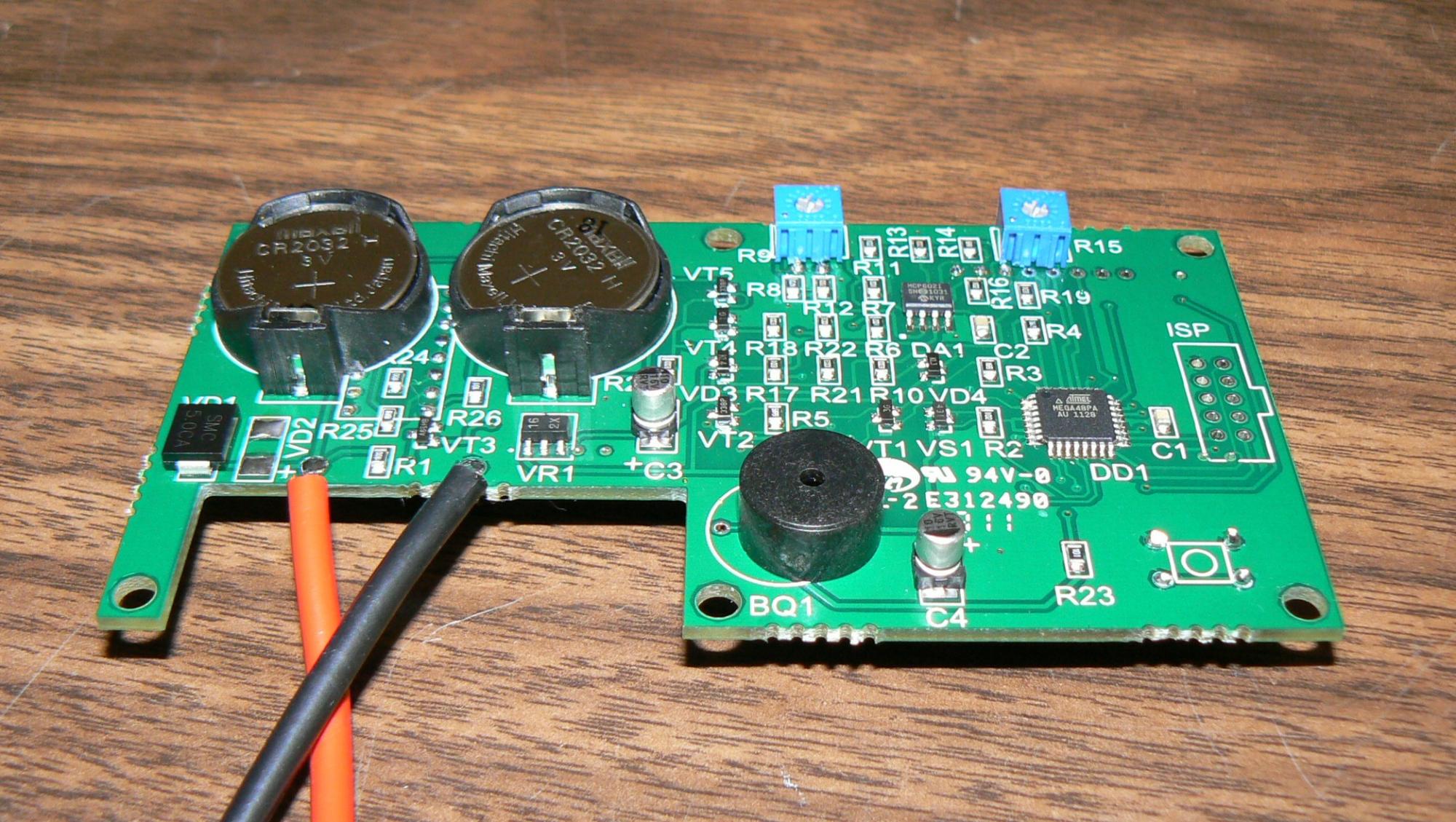

                            Hi, Mike. I picked up one of your ESR Micro 4.0s units on Ebay. Purchased through Paypal, sent by Russian Post to Canada. All went well and my unit arrived in just over 2 weeks - specified in the Ebay listing as the usual transit time by post from the Russian Federation.
                            So, I unpacked my new shiny
                            Tested my new shiny. It works! It works!
                            OK, now to gild the lily. <best mad-scientist cackle as music rises to a crescendo>
                            So, the only reason I found the ESR4s online was because I had bought a "Blue" kit the day before - was halfway through assembling the "Blue" - and there was your unit online. (Murphy at work, yet again.)
                            Purchased the ESR4s on the spot - of course - because that's what I wanted in the first place but couldn't find in North America for love nor money. However, having your unit in my hot little hands was at least 2 weeks in the future. I wanted to use the "Blue" - at least until your unit arrived.
                            Finished off assembling the "Blue". Defluxed, cleaned, tested, calibrated. Hate the wires/probes that come with it. So, off to the local electronics part stores to see what I can find as replacements.
                            Aha! There's what I want! The gold-plated microfine-tip (sharp as hell) probes that reliably get into tight places and properly pierce the oxidation on the solder to get a good reading. Buy now? Yes!
                            Get home, install the probes on the Blue. Yup, just exactly what I was looking for. Proceed to use the blue quite happily until your unit shows up.
                            Delivery notice for your unit in my Mailbox. Come and pick up. Dash to post office in wild anticipation.
                            Get home, open package. Well packed, I must say. Lots of bubblewrap.
                            OK, the probes on your unit are nice. But they're not as nice as the probes on the "Blue". Proceed to swap.
                            Now I have the probes I want on the ESR4s. Your probes are on the "Blue". While I've got the ESR4s apart, I use that opportunity to deflux the power switch, the test lead points, the test socket and the display mount points on your pcboard. Clean. Did I mention clean? Yeah, clean.
                            Upgraded all the screws on the unit to Black Chrome. Looks niiiiiiiiice.
                            See attached pictures of my baby....
