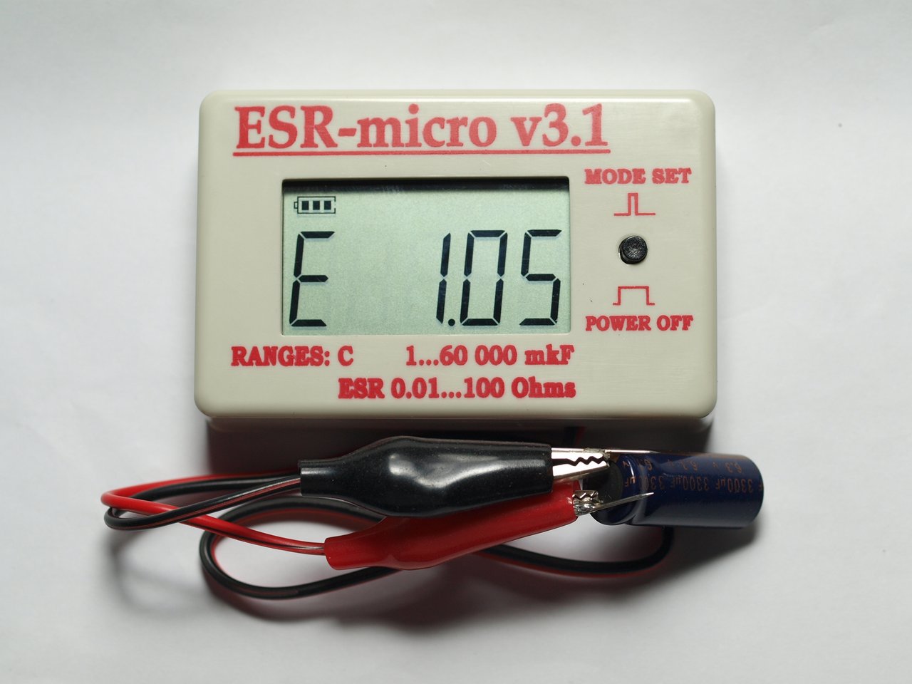

                          I have seen the ESR-micro v3.1 and it looks very nice. I'd consider the Micro if a domestic (US) source for it becomes available. It looks like it comes with short leads and clips instead of probes too. (like the Atlas)
                          Now I'm leaning toward the Blue kit. Measuring capacitance would be very nice but not the primary need. Some local pawn shops have some Fluke meters. I should check models and prices for cap test functions.

                            Originally posted by golemmaster
                            I have seen the ESR-micro v3.1 and it looks very nice. I'd consider the Micro if a domestic (US) source for it becomes available. It looks like it comes with short leads and clips instead of probes too. (like the Atlas).
                            The v3.1 meter has clips with very sharp little probes attached. Very clever, those Russians. You can see them fairly well in the attached photo.
                            Also that meter doesn't switch itself off very quickly or need to be switched on for each new measurement, unlike the Atlas one.
                            I hope this info is helpful.
                            Bob

                              #34
                              Re: esr or cap tester
                              Bob
                              That's the best pic I've seen of the Micro. I looked at their website.
                              Very nice indeed! I'd love to get one.
                              I worry about the translations and payments and conversions....
                              Google Translate does a much better job than Yahoo Babel...esp on the order page.

                                  If I am interpreting the symbols properly, once it is turned on a short push on the button switches mode, while a long push turns it off. Yes, the translation (sort of) confirms this. It turns itself off after 40 seconds of non-use.
                                  Of course, I would have to put it into a larger case so it wouldn't get lost.
                                      PlainBill
                                      Yes, that's the way you operate it. You're correct that it's a very small gadget because it uses surface-mount components and is powered by lithium cells.
                                        I agree that it's much too difficult to buy one of the Russian meters if you're in the USA. Hopefully that will change in the future. If anyone knows someone in business who'd be interested in distributing them there, please let me know and I'll get the info to the right person.
                                        Bob

                                          Just for everyone's info - this photo shows the Russian meter displaying capacitance.
