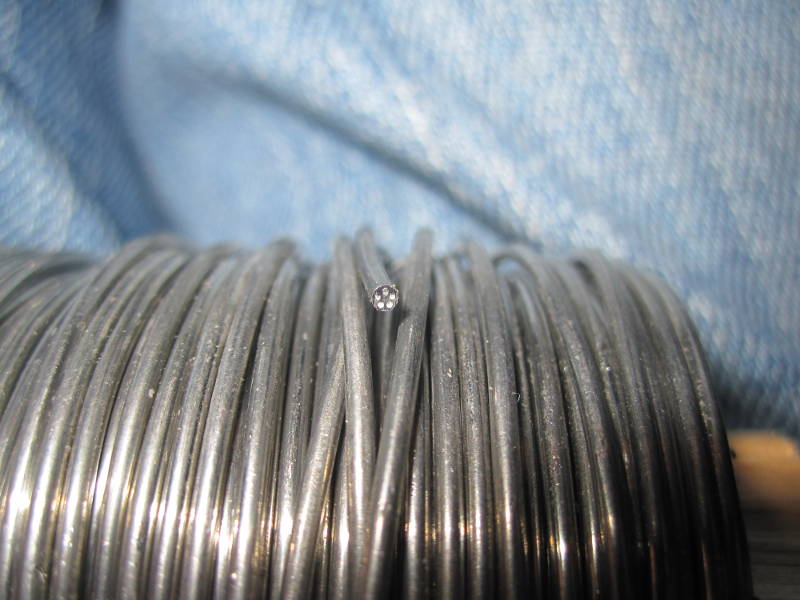

Is this really LMP silver solder?
  • eccerr0r
    Solder Sloth
    • Nov 2012
    • 8701
    I bought a roll of solder, I think just under 0.5lb (haven't measured) for $4 USD. I initially noticed it said "L.M.P. Silver Alloy" and perhaps this really is silver solder (62/36/2)...but is it?
    I don't know how accurate my solder iron is but that will be my first check...though I wonder if the resolution would be high enough, or if I have actual 63/37 to compare against.
    Any other qualitative tests I could do?
    The spool is an old wooden spool. "Multicore Ersin Five Core" and "B62 Flux" (???) but it could have been a respool (though doesn't look like it.) Cutting off a piece and seeing if it has 5 cores would be something I should check too.
    Did I get ripped off?

      Re: Is this really LMP silver solder?
      Oh I wish it was actually 500g, but unfortunately I only got I'd say around 250g (I just measured the spool+solder at 12oz, couldn't measure when I bought it. I just hope the wooden spool doesn't weigh 11oz )
      FSCK my solder iron bottoms out at 200°C which would melt both 63/37 at 183°C and 62/36/2 at 179°C ... need to figure out another way of testing... At least the cut test indicates it is indeed "Multicore" (I see 5 cores!) just no proof it's got that silver in it...

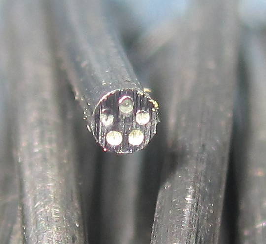

        pictures of lead...
          • 31087
          nice photo!
          it may have silver in it.
          i noticed with my silver solder that it has a different look, like a slightly green finish in the light.
