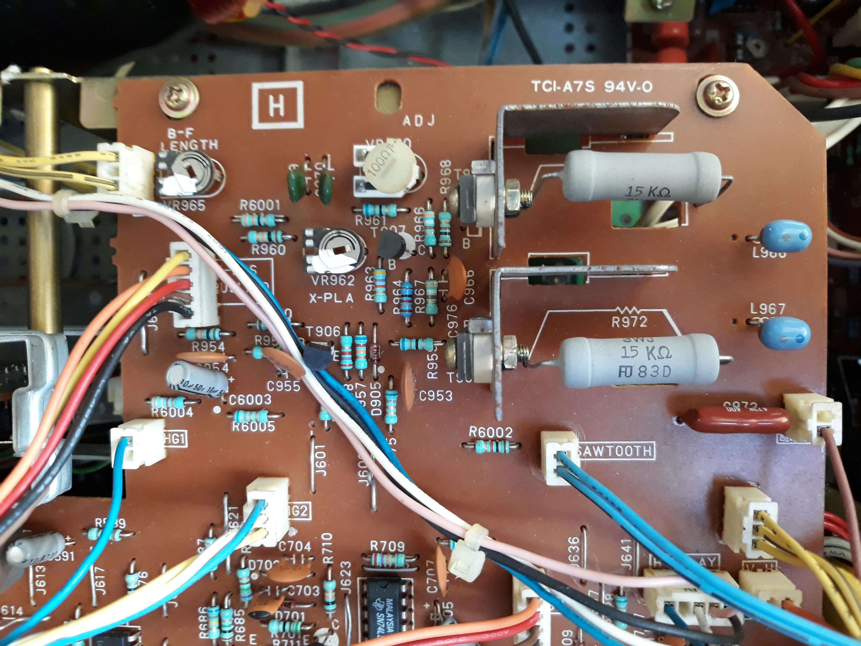

            In pag. 54 R410 +24V EXT S601
            In page 55 HG1 GB S601
            to 56 SWEEP SIGNAL T703
            More JPG to analyse
            Regards,
            Ruy

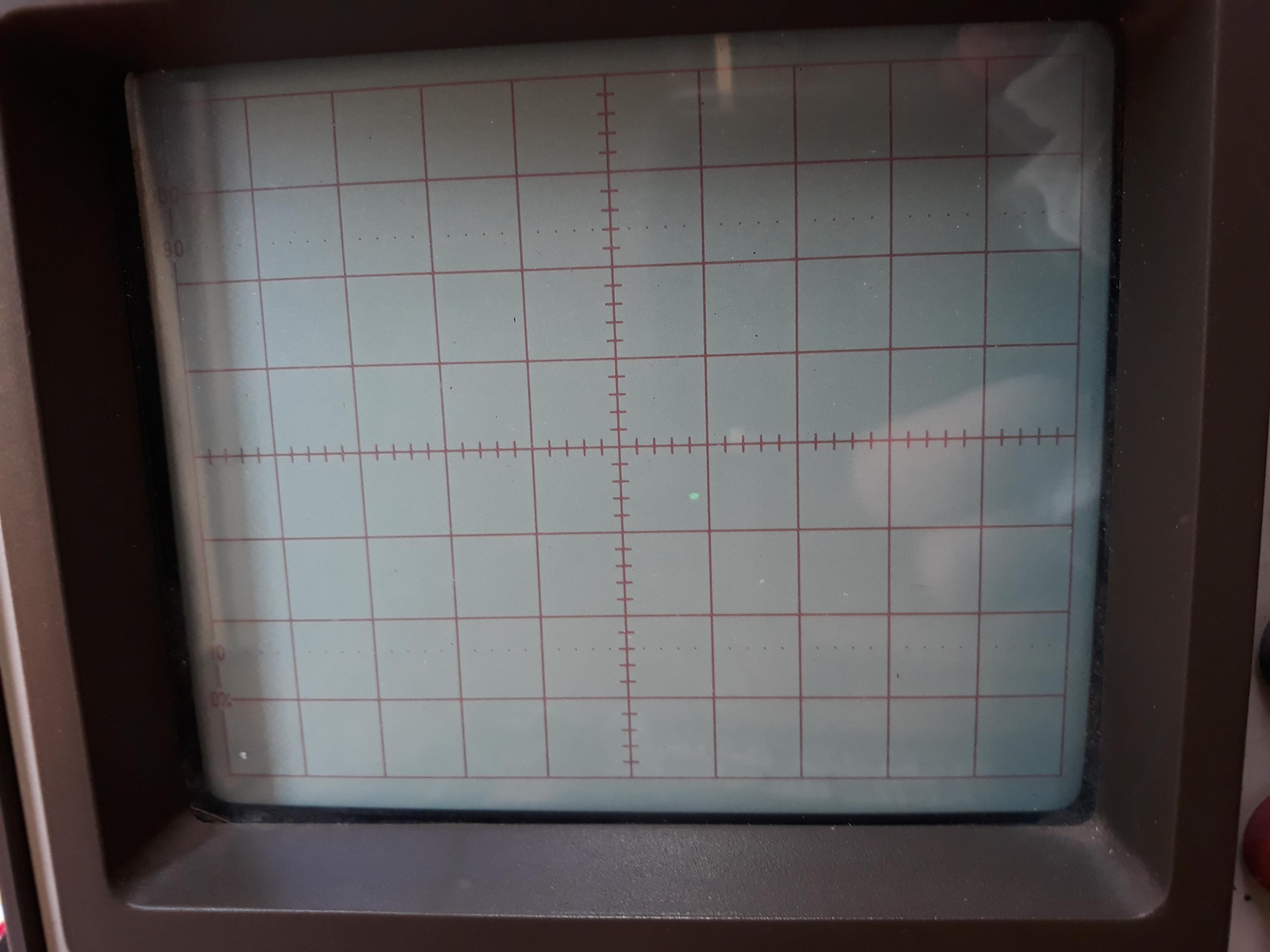

              Re: Oscilloscope UNAOHM G4020 = BECKMAN 9020
              Okay, wait. Now I see horizontal lines. This means that the horizontal amps and oscillator is trying to do something. What are the settings and input that generated this picture? This is why if it's possible I'd like to see the picture of the scope's screen output AND the settings of the scope at the same time, with pictures of probes hooked up to the inputs. This would help rule out communications issues when typing in descriptions of what you see.
              Now what I don't know is if the vertical amplifiers are working since we are seeing horizontal lines.
              After reporting what are the settings and input that described how you got those horizontal lines shown, can you move those lines left/right and up/down, all the way, with the X-pos and Y-pos potentiometers. Also what happens when you add in a sinusoidal Y-input from the attenuators if you aren't already (set input to say 10mV and touch the pin of the probe).
              Then take a picture if it changes from the shown picture.
              Also while you're at it: measure all power supplies except the CRT second anode and CRT cathode voltage. You may have a weak power source that would explain both X and Y issues if you indeed have both issues. I ask not to measure the CRT second anode and cathode voltages because these are likely several thousand volts, and most people don't have the equipment to safely measure these.
                (unrelated to the scope, just beef about cameras:
                Also another thing I wish people had the capability of doing: using a tripod and making long exposure shots of the screen. It's an advanced photography technique that many cell phones can't do - in the realm of requiring DSLRs or at least better software/hardware that allows turning down the camera's sense amplifiers...)
                The settings:
                https://www.badcaps.net/forum/showpo...2&postcount=11
                https://www.badcaps.net/forum/showpo...8&postcount=14
                TIME / DIV is 5us, 10us - trace ( tail ) with 1 cm.
                " ... can you move those lines left/right and up/down, all the way, with the X-pos and Y-pos potentiometers. ..."
                YESSSSSSSSSSSSSSSSSSSSSSS
                I explained in previous post
                "... CRT second anode and cathode voltages because these are likely several thousand volts ..."
                -1867 V
                1,9KV
                Best Regards,
                Ruy
                • eccerr0r
                  Solder Sloth
                  • Nov 2012
                  • 8701
                  Which settings go with which picture, and you have NO external input?
                  So you're saying "tall" when the picture shows "wide" ... This is why I'm confused!

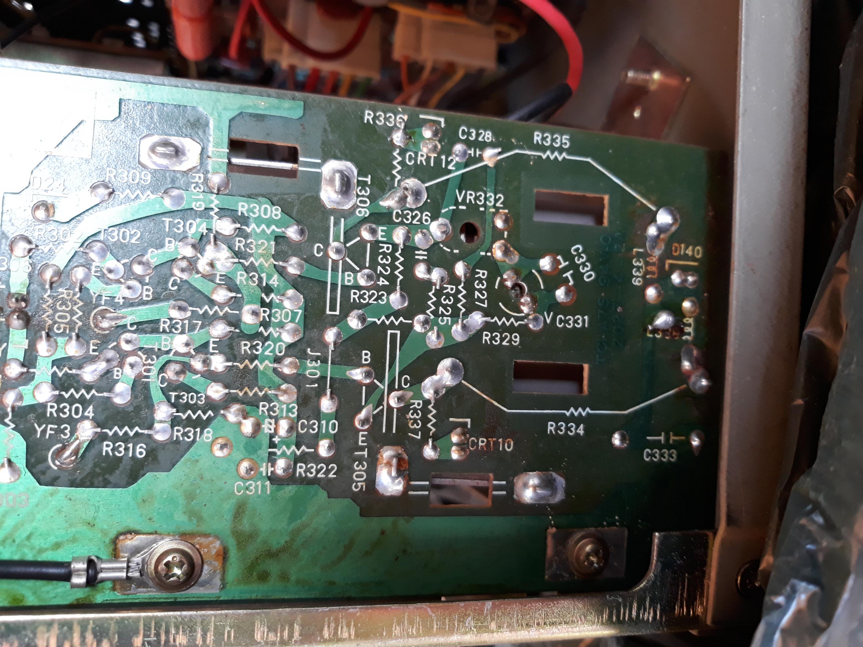

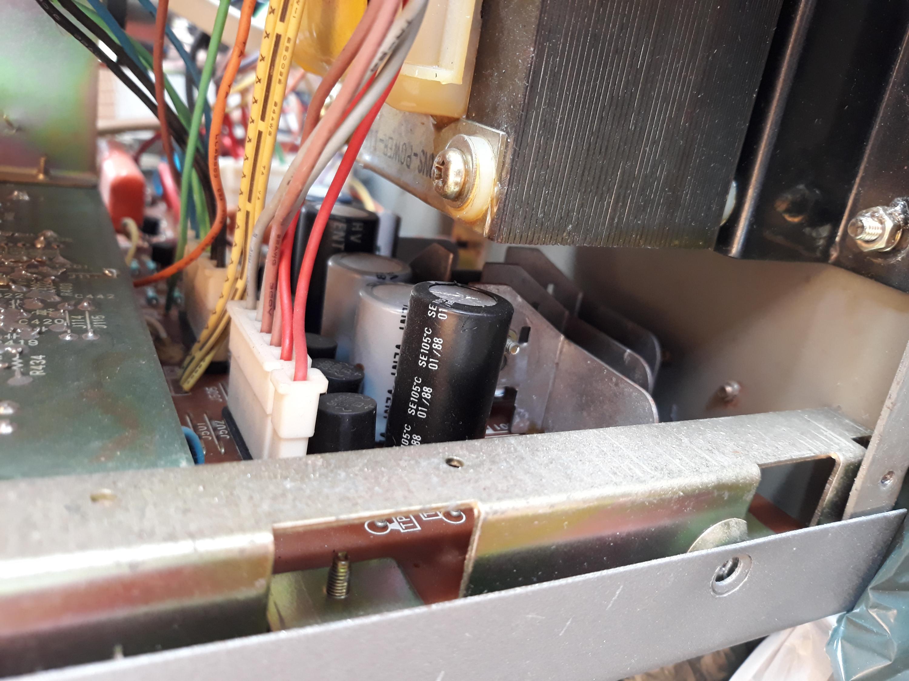

                    • 31157
                    #29
                    a good clean is an idea, there are solder balls and splats all over the underside of that board!!
                    • redwire
                      • Dec 2010
                      • 3912
                      #30

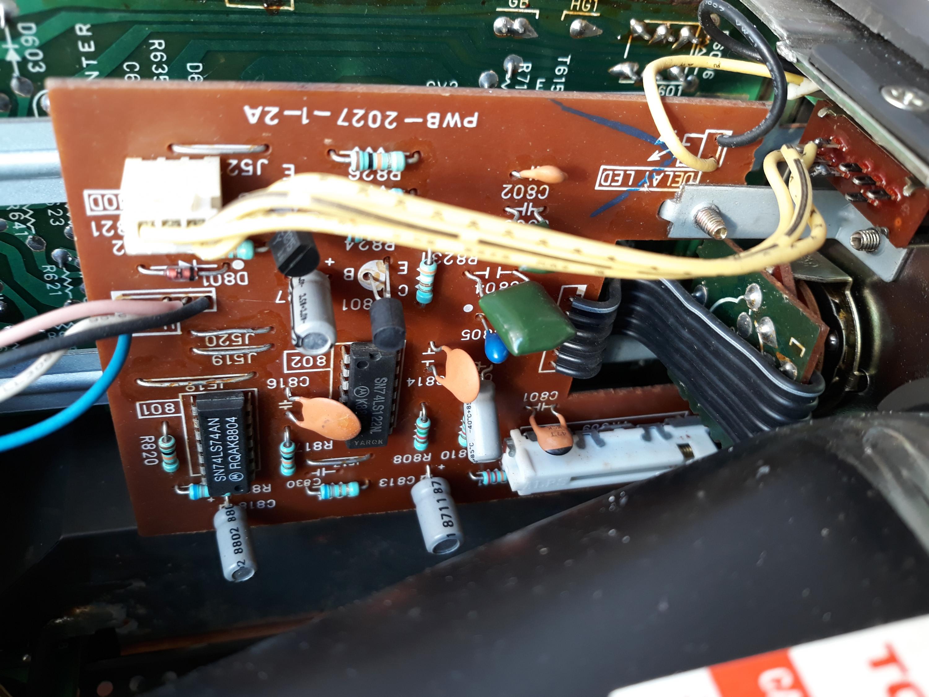

                      This is dated 1988 so the electrolytic capacitors look pretty old. If there is AC hum, the ripple would make the trace/dot into a bar.
                      I would check the +140VDC rail, and filter cap C524 47uF 250V, used for both the CRT X (horiz) AND Y (vert) deflection amps, and is part of the +260V rail.
                      I would check the +260VDC rail, and filter cap C523 47uF 250V, used for the CRT X (horiz) deflection amps.

                          • 8701
                          #32
                          Okay... so your the time/division knob makes no difference or is this the only setting that you get a little bit of trace?
                          And if you add in a Y-signal does it do anything?
                          And if in XY-mode you get nothing at all? Even with beamfinder and rotating the XPOS and YPOS pots? And the XPOS you have pulled out too?

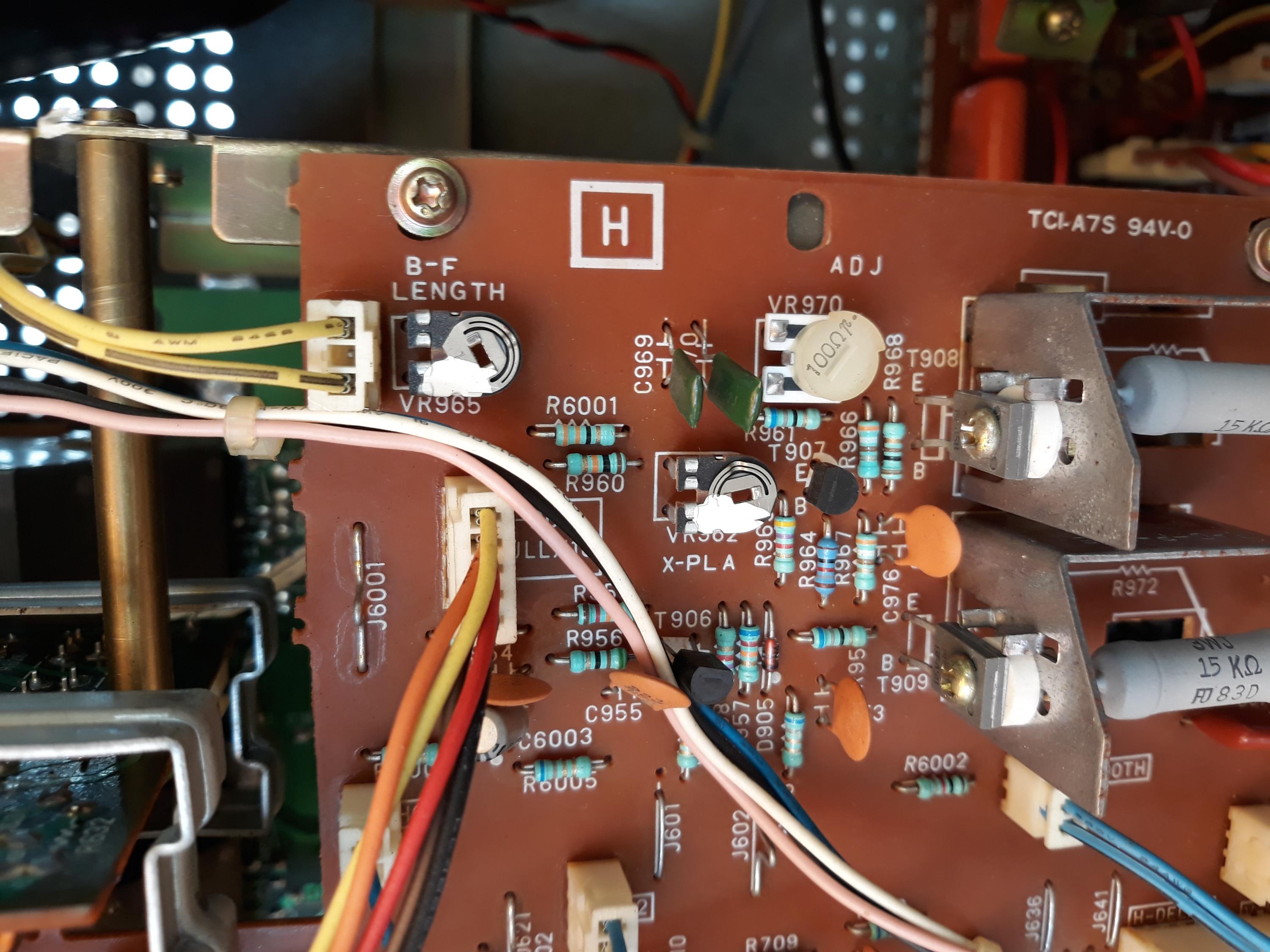

                          BTW, HG1 is the blue wire on mid/left of 20180803_103917.jpg it appears. How much of a change does disconnecting it do (do you get a dot instead of the lines?). I would probably start looking at this board for more clues but I have not ruled out other boards. This is the X final.

                              #34
                              Ok this test should definitively split the search space:
                              Put your DMM on the HG1 connection.
                              Put your scope in X-Y mode and set the attenuator to 100mv/div.
                              Then connect a 1.5V battery to the X input (II?) and record the voltage. Then swap the + and - to the battery, and note the voltage again.
                              If the two are the same, then the problem is not on the X final board.

                                • eccerr0r
                                  Solder Sloth
                                  • Nov 2012
                                  • 8701
                                  #36
                                  R6001, R961, and T908 are on the X final board...
                                  If you see HG1 voltage changing with the battery voltage, then I'd suspect T908 first but check all three.

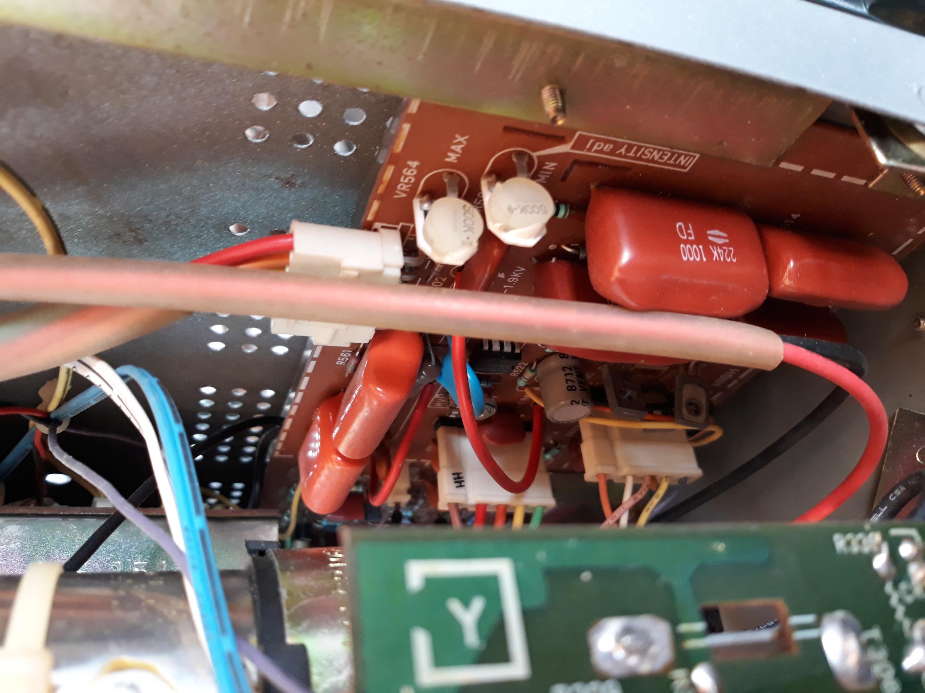

                                    #37
                                    Thank you,
                                    I have the DMM in another loc. in 2 or 3 days ...
                                    Test -> T908 and other T. with Diode mode.
                                    You test with R - Ohm and values I expect?
                                    Caps with ESR
                                    The ICxxx - 7474, 74122, 7812, 4011 ... test?
                                    If I test the Volts in CRTD1, CRTD2, CRTD3, CRTD4,
                                    CRTG2
                                    any danger the -1,9KV or the 2KV or -1867V ... get in that lines ?

                                      #38
                                      Well now that we know there's traces or dots on the screen, you don't need to mess with the cathode or anode voltages, do not touch them, stay away until we know otherwise. The deflection grid plates can get to 100-200V so they're not a walk in the park, just be diligent and take all necessary precautions working with high voltages. I survived debugging my Tektronix 2465 high voltage board, anyone else can too.
                                      I'm debugging this methodically, if you want to test the ICs before knowing where to search for problems, go ahead, but it wasn't my plan yet.
