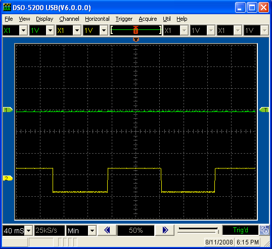

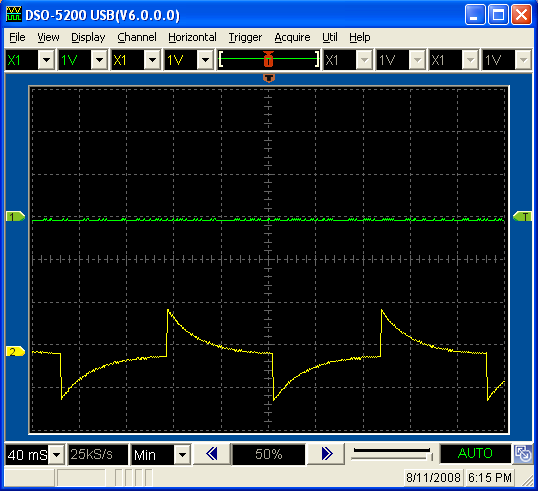

    When applying a square wave of a very low frequency (5 Hz) from a signal generator to an oscilloscope, the waveform looked distorted. I thought it was a fault in the signal generator.
    Later, I found out when I used DC coupling, the waveform had no distortion.
    DC coupling should be used when the application permits.
